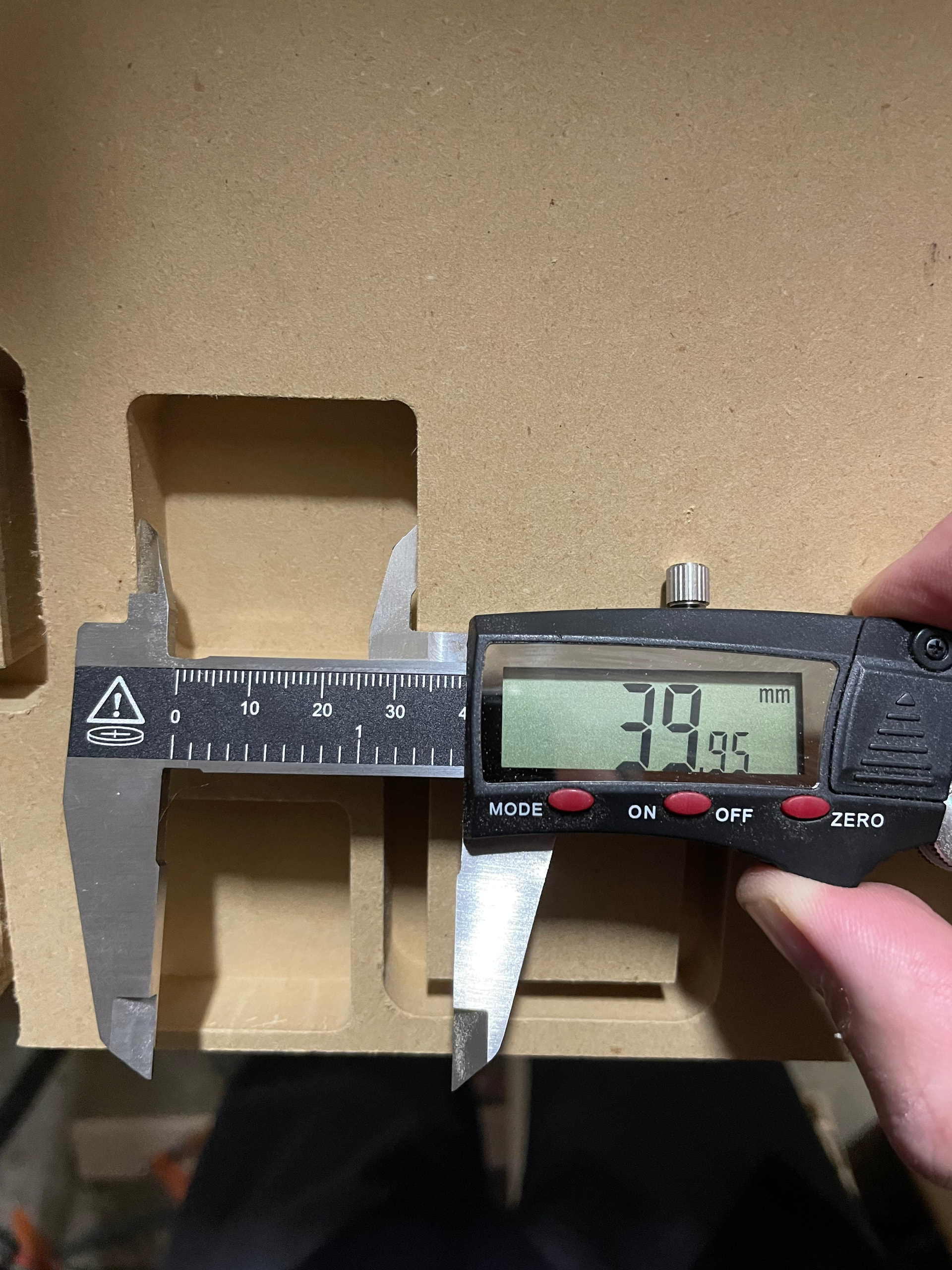

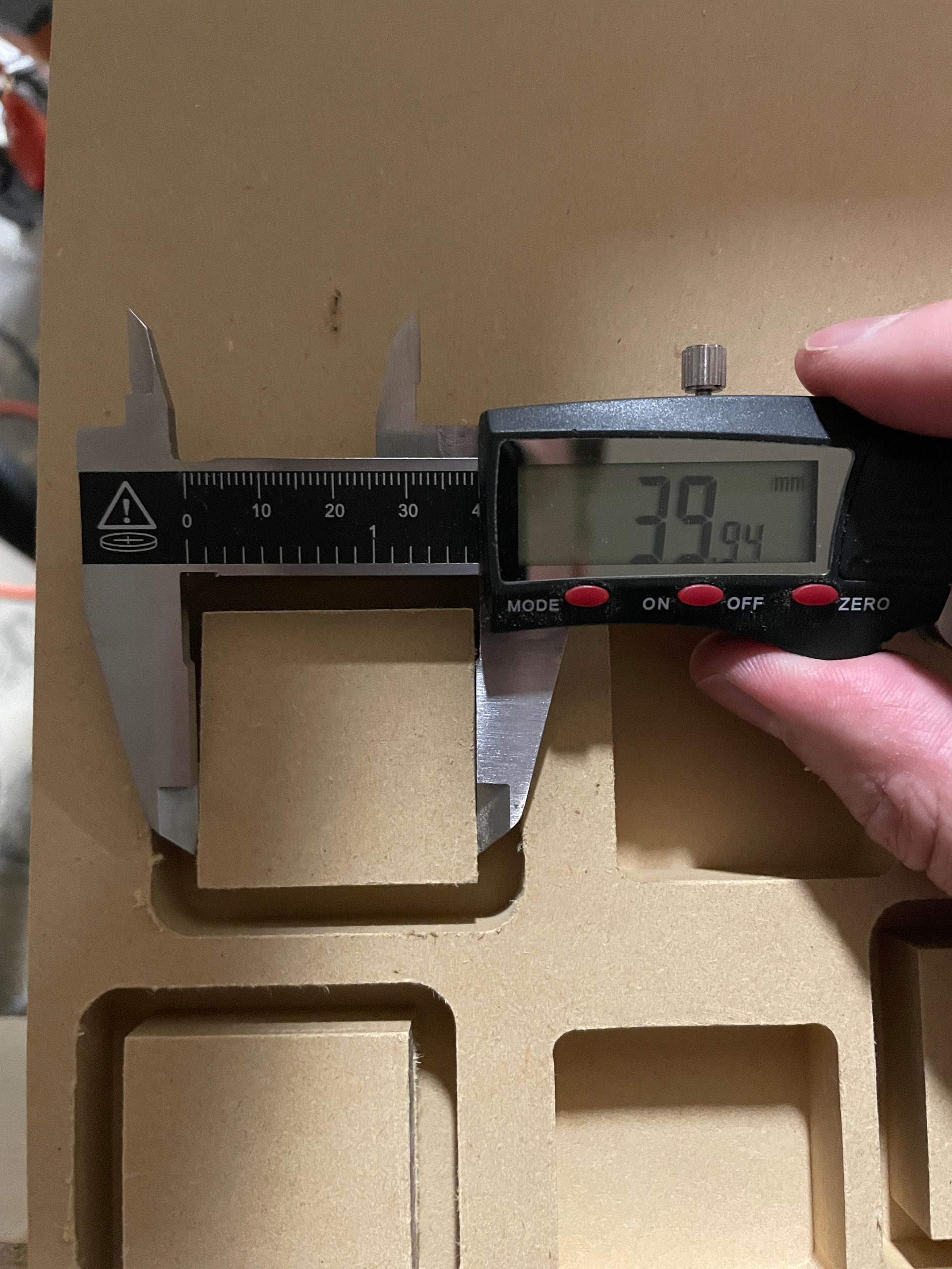

I cut some 80x80 test squares and the part measures 79.9x79.9 and the pocket measures 79.3x79.15
Curious what you make of this - seems like I could adjust the mm/step a little bit to tighten things up?

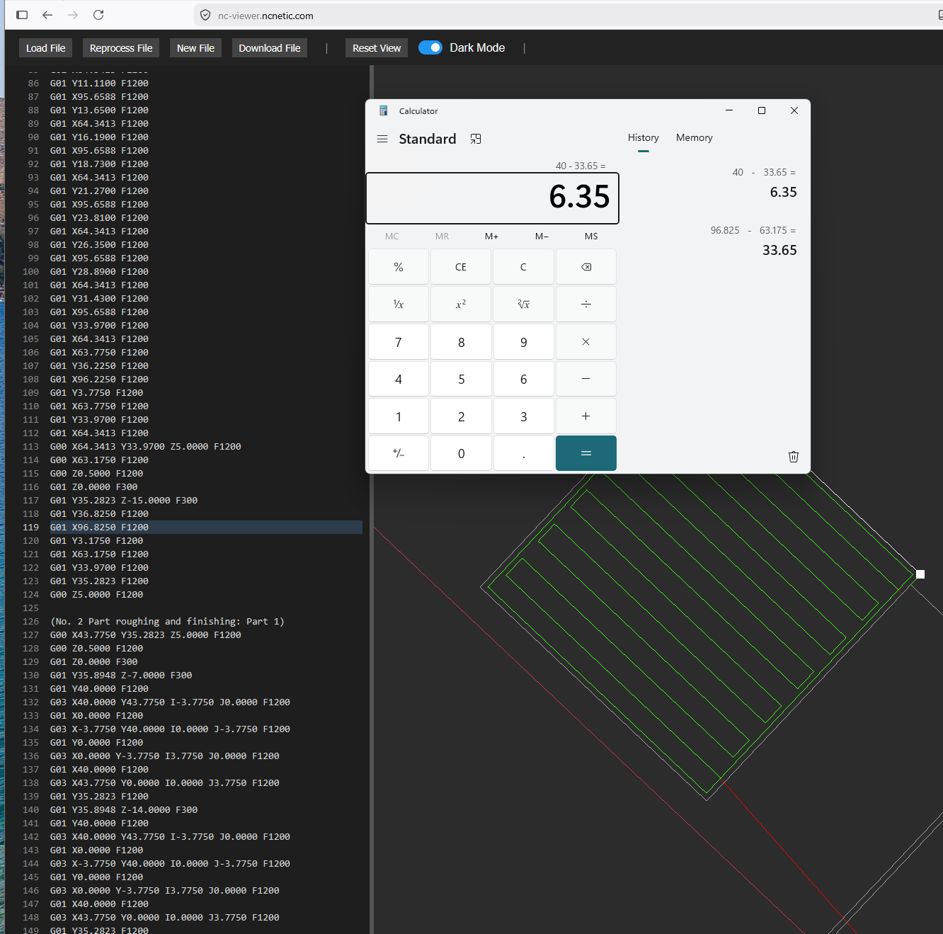

I measured a slot I cut with this bit at 6.2mm, so I set that as the tool width
I’m still getting 39.3x39.3 pocket and just about dead on 40.05x39.98 part. I’m also just not seeing the proper surface finish I would expect after a finishing pass - it’s better on the pocket now (but I am still seeing that ramp in) and the part still shows the roughing pass layers
it’s just so weird that the cut size error isn’t symmetric
I know 0.7mm isn’t HUGE but it would be nice not to have to use some kind of funky workaround like a negative value finishing pass offset for pockets

WIth a 6.3mm tool width I’m getting a part cut measuring 40.15x40.10 ish and a pocket cut of 39.30x39.15ish

I am concerned that your ID is always 39.3. Through all the changes your ID never seems to move.
Do some full cutout outs so you can measure it better. or use some hand tools to cut your test cuts all the way out., there is no way the ID is always 39.3.

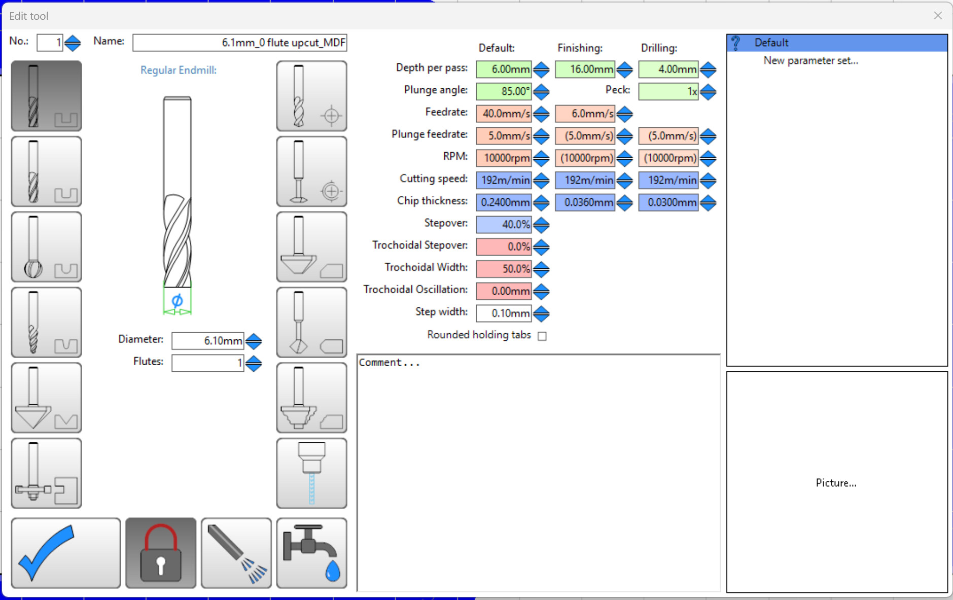

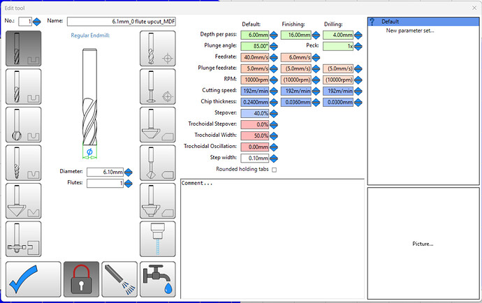

Here’s the tool settings I’m using:
Makita router speed setting 1 - roughly 10k RPM according to the manual
Still doing a 0.6mm finishing pass, and using the peel setting for the pocket
This is getting me legitimate chips of MDF instead of awful dust - I think the dust may have had something to do with my issues before, interfering with the tool in the cut. I also hadn’t cleaned out the shop vac in a while and was not getting proper dust evacuation from the cut.
Also the oversized tool settings before were not getting me a full finish pass - now I know if the tool dimension in CAM is too large the finishing pass will not be in the right place and potentially leave some of the inconsistencies of the roughing pass
