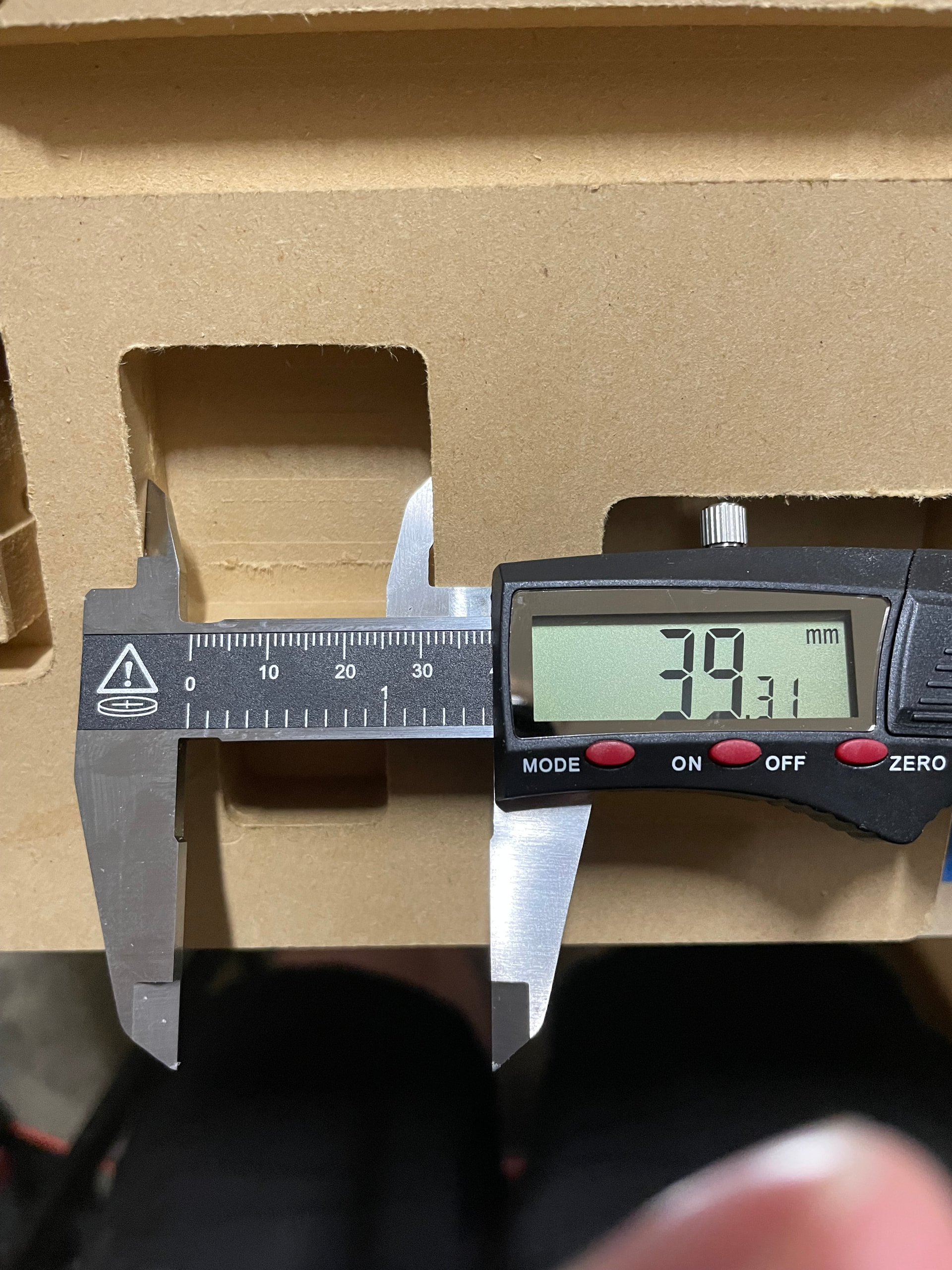

I’m just getting started with my machine, and part cuts - like the strut plates are cutting very accurately. However any pockets/holes/drills are coming out about 0.5mm small. I’ve checked the g code and the min and max X and Y dimensions for a test square pocket look correct
Any idea what could be causing this small pocket issue? If there was inaccuracy cutting parts I’d look to mechanical issues but this smells like software to me….
Appreciate your help

This is a test cut of 2 40x40mm squares, one part and one pocket both 15mm deep, 1/4 in 0 flute endmill, no finish pass, 19mm MDF

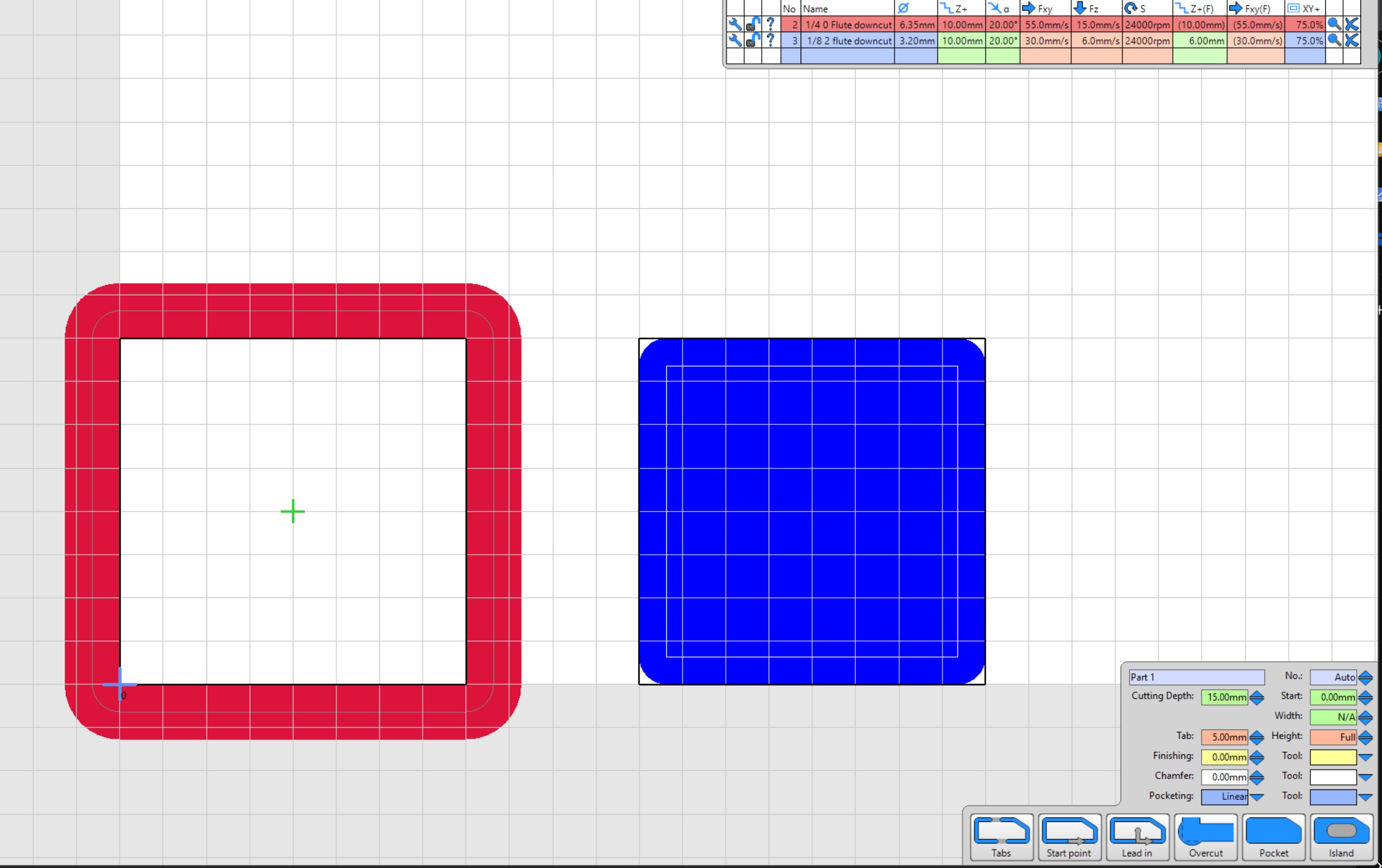

Here’s some estl cam screenshots:

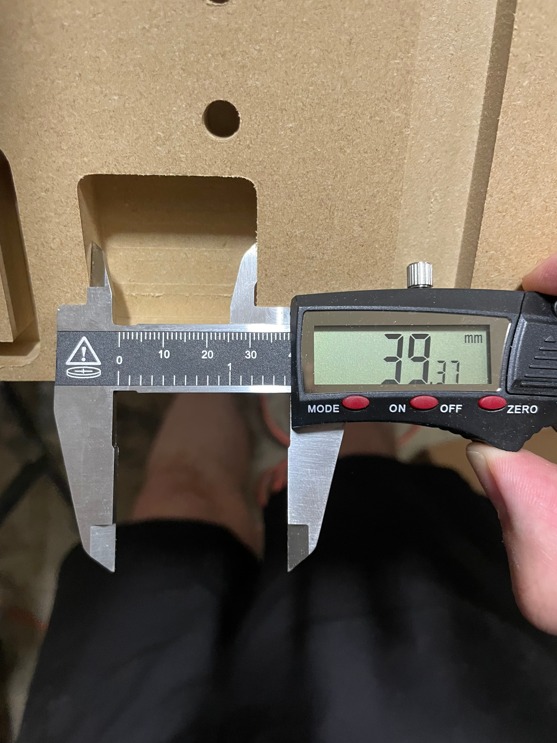

Here is the resulting pocket cut:
sorry that last one was with a finishing pass - this is without the finishing pass, pocket cut:

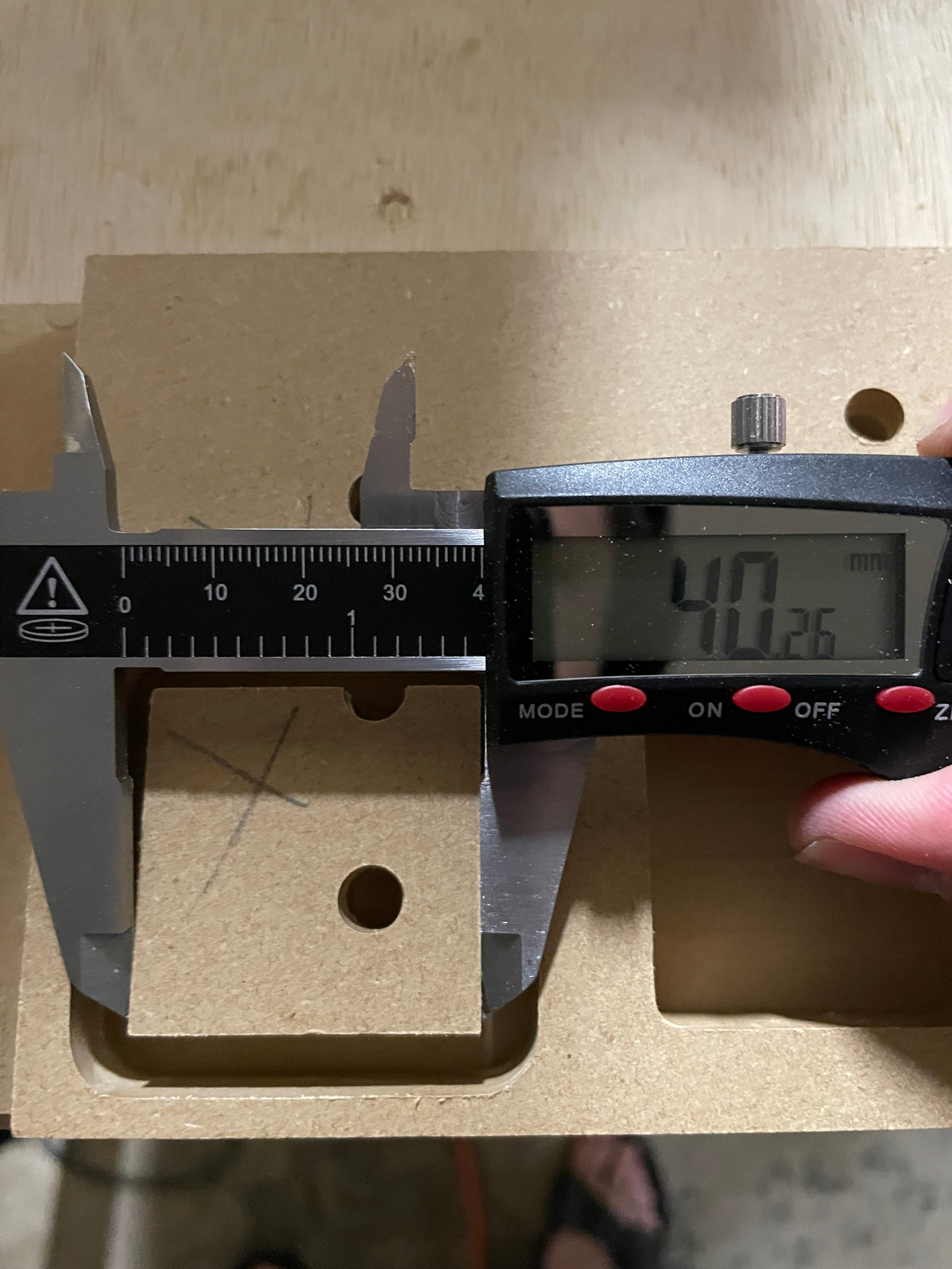

And this is the part cut:

We need a little more info. I can see MDF, and 1/4" downcut.
From what I see you are not using a finishing pass and you are going way too fast for a downcut. You really should try out an upcut. If anything do all of it with the upcut, then the finishing pass with the down cut. With a large enough finishing pass I have never needed a downcut. I really dislike them for 99% of things. For giant machines screaming through material a downcut might make more sense but in general we are taking relatively light passes, so an upcut shoudl be fine.
You are actually getting amazing results for such a heavy cut, 10mm DOC, 55mm/s, with a 15mm/s plunge, that is actually pretty insane.
I would put you at 6mm doc, 25mm/s, 8mm/s plunge.

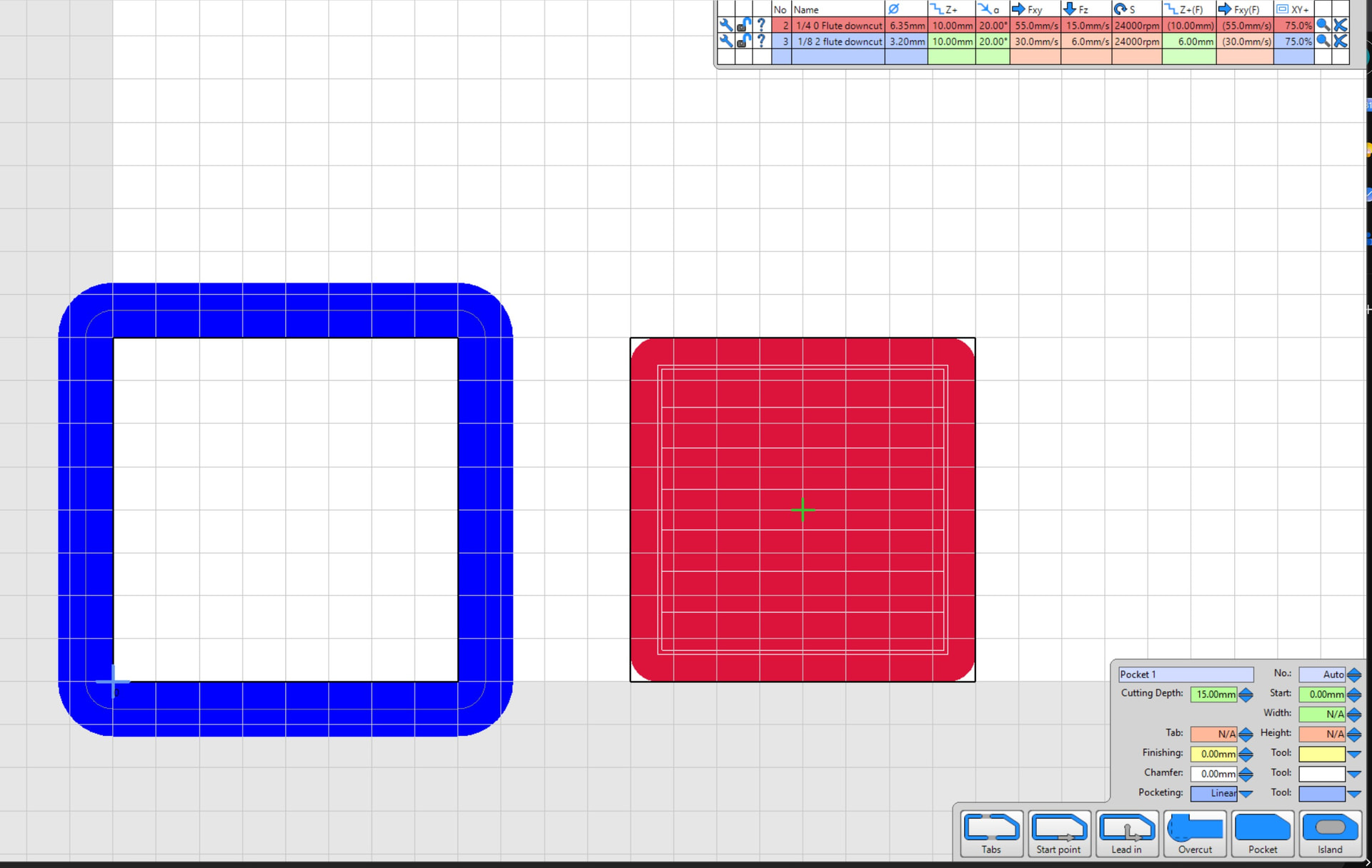

Here’s some more information

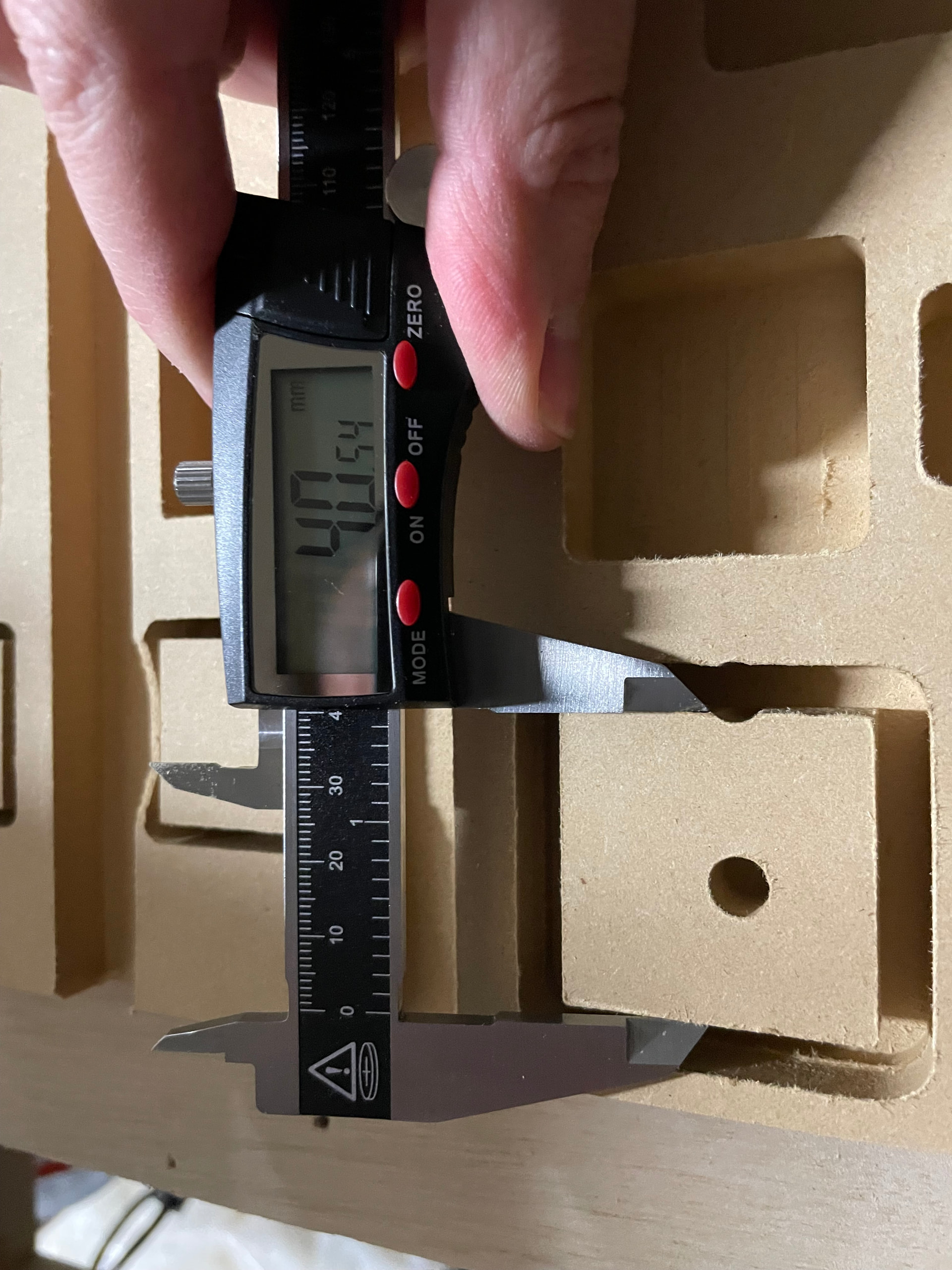

I also tried this with an 0.3mm finishing pass, here are the results:

A 10% finishing pass is pretty standard. So do 0.6mm, full depth, at about 20mm/s
Definitely slow down for testing. A single flute upcut 1/4" in MDF can go super fast and the finishing pass should dial it in but for now just slow down and do a 6mm doc, then a full depth 0.6mm finishing pass.
