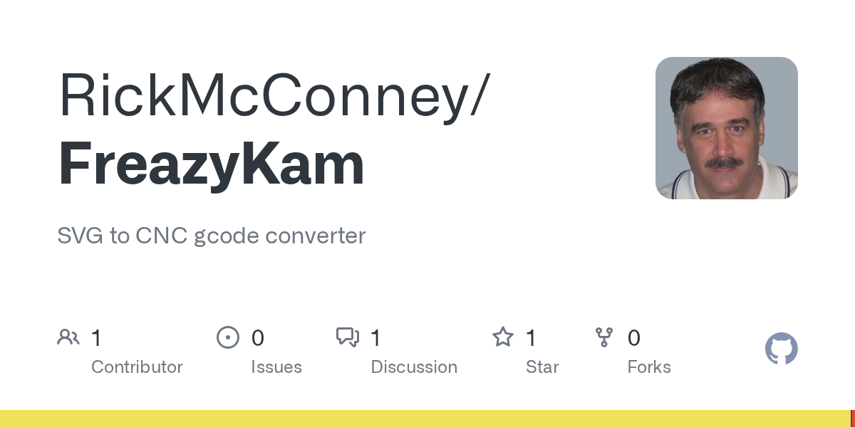

Hi, I am looking for feedback and testers for a browser based cam app. The app is open source and free to use. It is hosted on github. As I don’t seem to be able to include a link you will need to search for FreazyKam on git hub. It supports loading SVG files and/or drawing simple paths. The paths can then be converted to tool paths. The gcode can be run in a 2d or 3d simulation and exported for running on a GRBL/FluidNC. Any feedback appreciated.

Here’s a link to the Github.

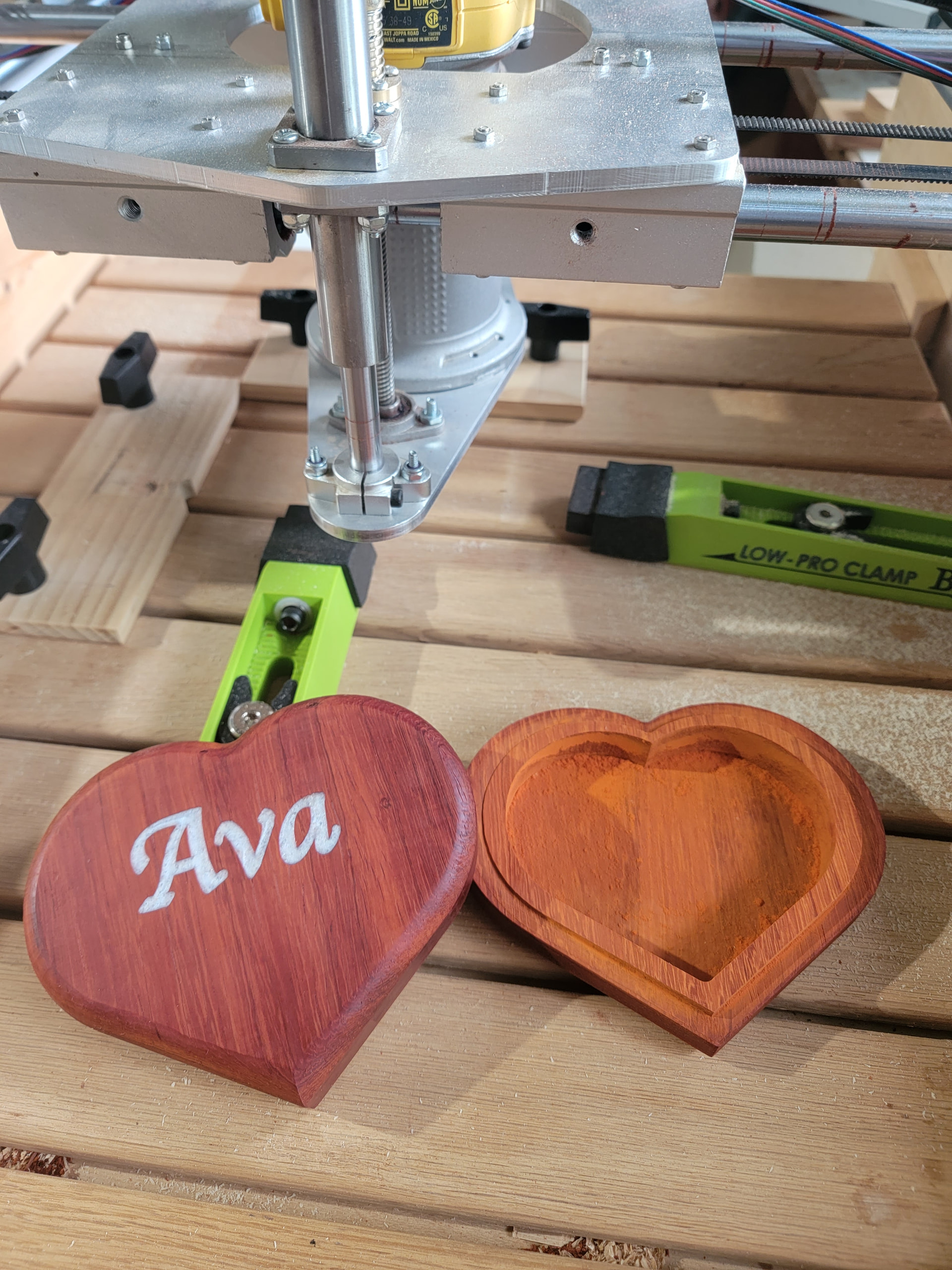

Yes I have cut parts with this using a FluidNc controlled home built cnc. That is why I was asking for feed back and testing as I have only tried on my cnc. So wanted to expose it to others to see what issues I would get. If you could give any specifics on the failures you see that would be great.
What shapes are you testing with and how dimensionally accurate did they come out when you machined them?

Thanks for the feed back, I machined a heart shaped box with lower and upper halves with engraved text on the top and it came out great. I did try loading both svg and dxf files after my change and both load, so not sure if you may have grabbed a partial change. I have not tested the exact accuracy as my machine is only home built but It is accurate to ruler measurements. I tried to default svg resolution based on if the file is illustrator or inkscape what type of svg file are you using. How far off are the cuts perhaps it is a pixel to mm scaling issue. Also make sure you use an outside cut and not a center cut for the profile so the bit diameter is compensated for. Sorry if I am wasting your time just trying to get more detailed info so I can fix.

Please share some pictures of the parts you machined, preferably with your machine in some pics as well.
Here is a pic of the boxes i cut The carving on the boxes was already filled with epoxy so I could not show the raw cut.
