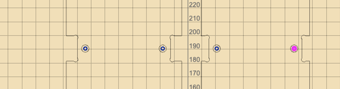

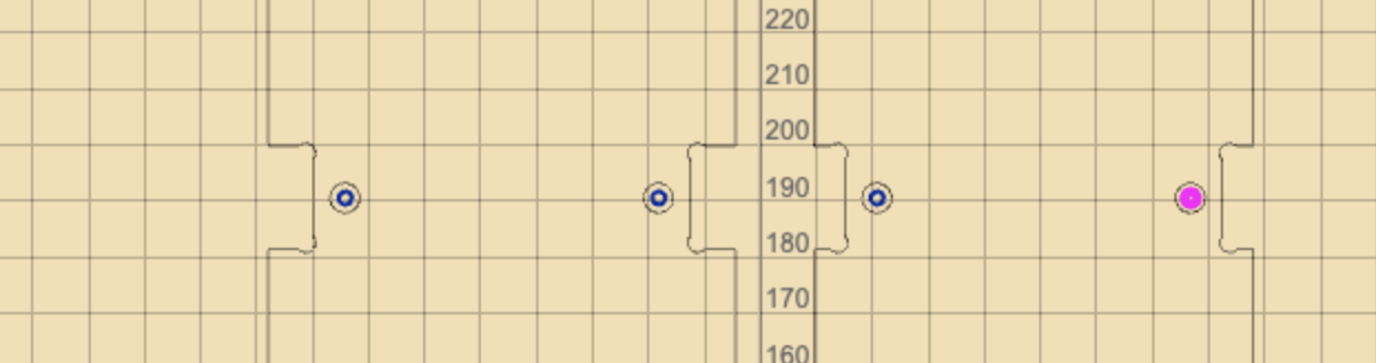

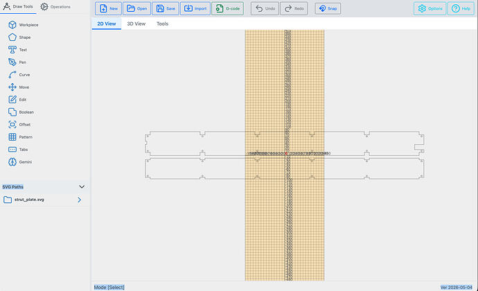

I have increased the svg and dxf conversion resolution it is now at 0.1mm was at 0.5mm before. I now see the relief pockets from the struts file. I also adjusted the import scale to match the viewbox if the svg file is an unknown type which was the case with your strut file. I was using the wrong pixels/inch so the import was too small. The slots are now about 18mm as you had indicated and this is the path for a 3mm end mill. These are exactly the types of edge case I am trying to find as I had just tested with illustrator and inkscape was not expecting custom svg generation tools.
Is it a huge performance hit if you up the resolution a little more? People try to get under a 0.1mm accuracy pretty often. I think for most things 0.1 would be fine but for the edge cases and large radius curves it might show up.
No real performance hit. There is an setting in the options menu at the top right where the tolerance can be set. I have now defaulted it to 0.01mm, but you can adjust to meet your needs. Here is what the path now looks like with the 0.01mm setting. The pockets are now smoother arcs.

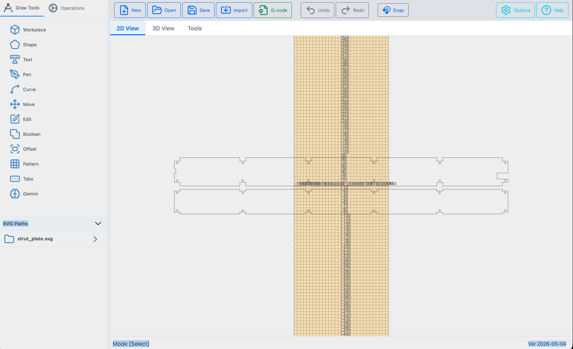

I opened it and fiddled a bit. I tried to load the strut plate SVG design from Jamie’s generator that we made for the RMRRF LR4.
It doesn’t appear to have any way to reorient the input SVGs and I couldn’t figure out how to easily rotate a path. I also couldn’t figure out how to make the holes be a pocket or drill operation, kept making a mess of it.
Mostly due to not being able to reorient the SVG to match the rough size of my small LR4, I gave up.

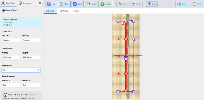

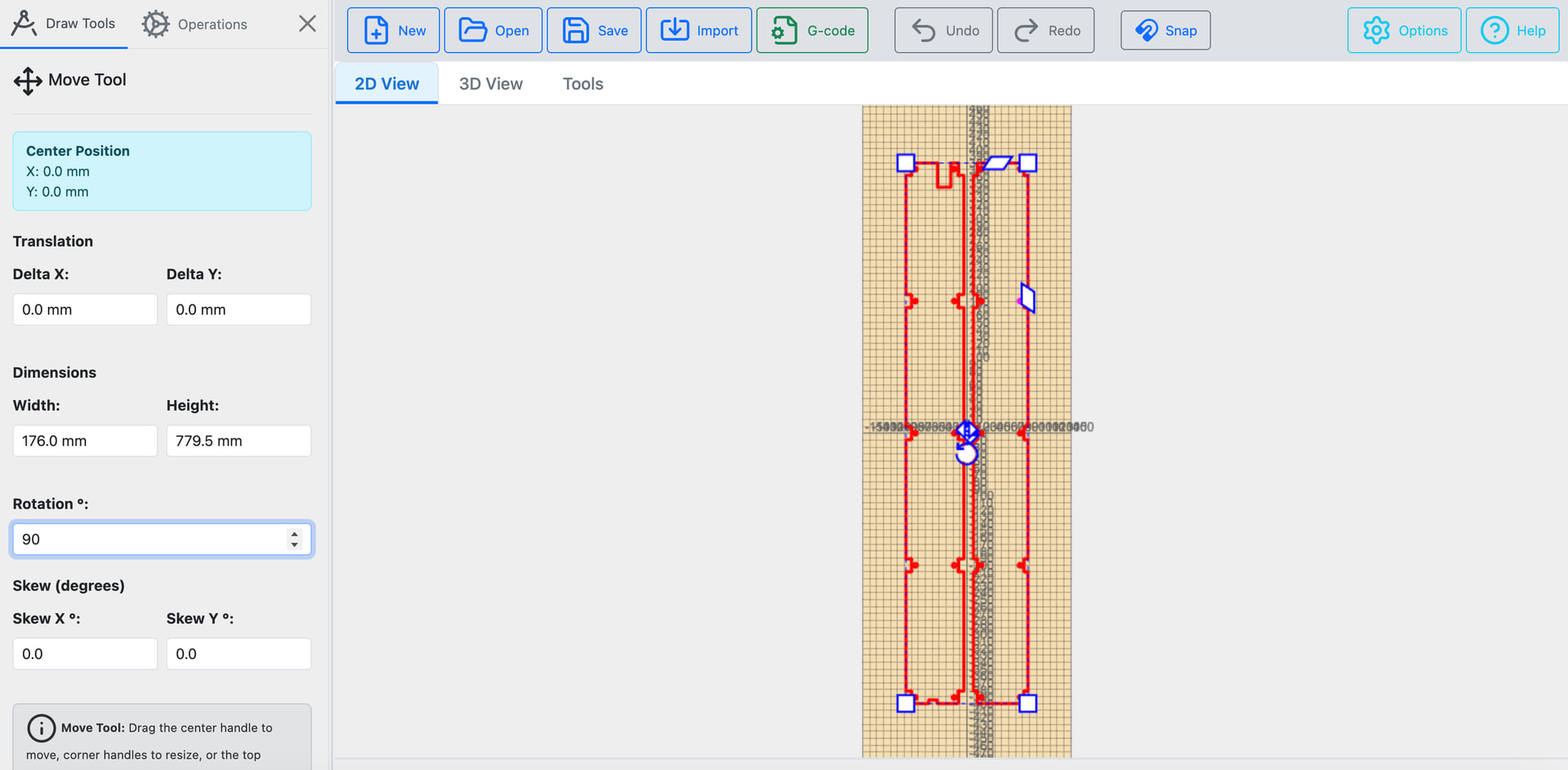

There are are a couple of ways to rotate an svg image after import. You can drag over all the paths to select them and then use the rotation handle that appears on the selection. Note you need to on the draw tab not the operations tab to modify paths.
You can also use the move tool in the left panel (maybe I should change the name to Transform) and then drag over the paths to select them. Then the rotation angle can be entered in the properties dialog or the rotation handle can be used to free rotate. The paths can also be moved, scaled or skewed.
Not sure what the issue with the drilling was to drill select the drill operation and then click on an empty spot to drill a hole there or click on a circular path to drill out the selected circle. You should use an end mill for a hole larger than the diameter of the bit or a drill tool if you just want to dill a hole of the drill size. A drill bit will use a peck drill strategy and a hole larger than the bit will use a helical drill operation.

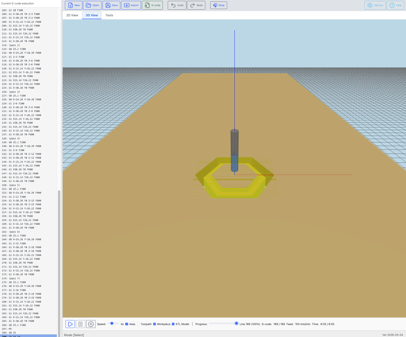

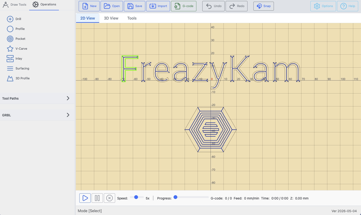

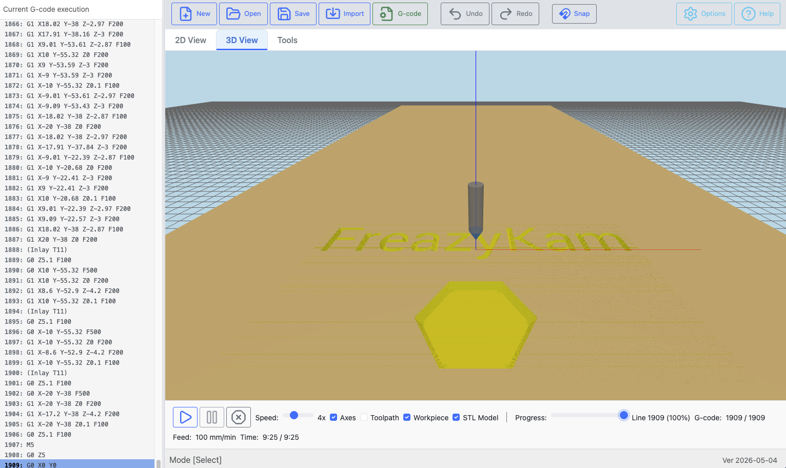

Thanks, it already has v-carve support. Here are some tools paths on text and a polygon. Followed by what they look like in the 3d simulation. This was created with the built in text and shape tools with no svg import even needed.

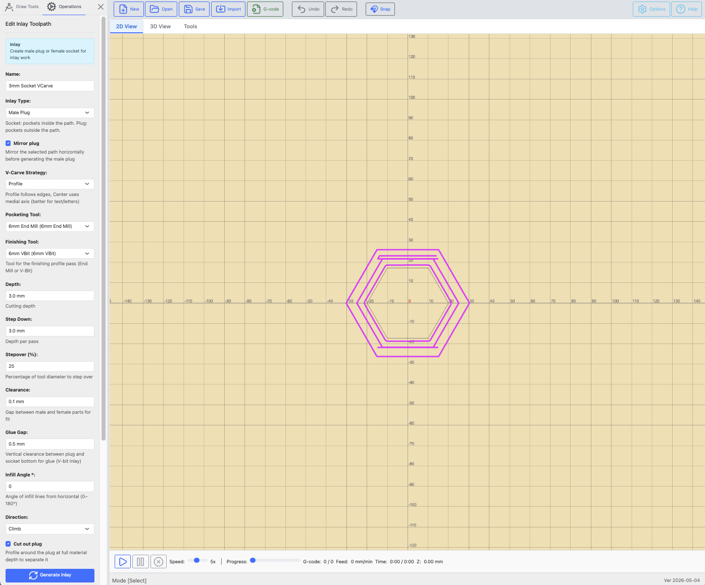

Inlays are also already done, here is the screen shot for the male plug for the above female inlay of the polygon. You can see all the inlay options in the side bar. The male plug can also be mirrored in X if it is not a symmetrical shape.
