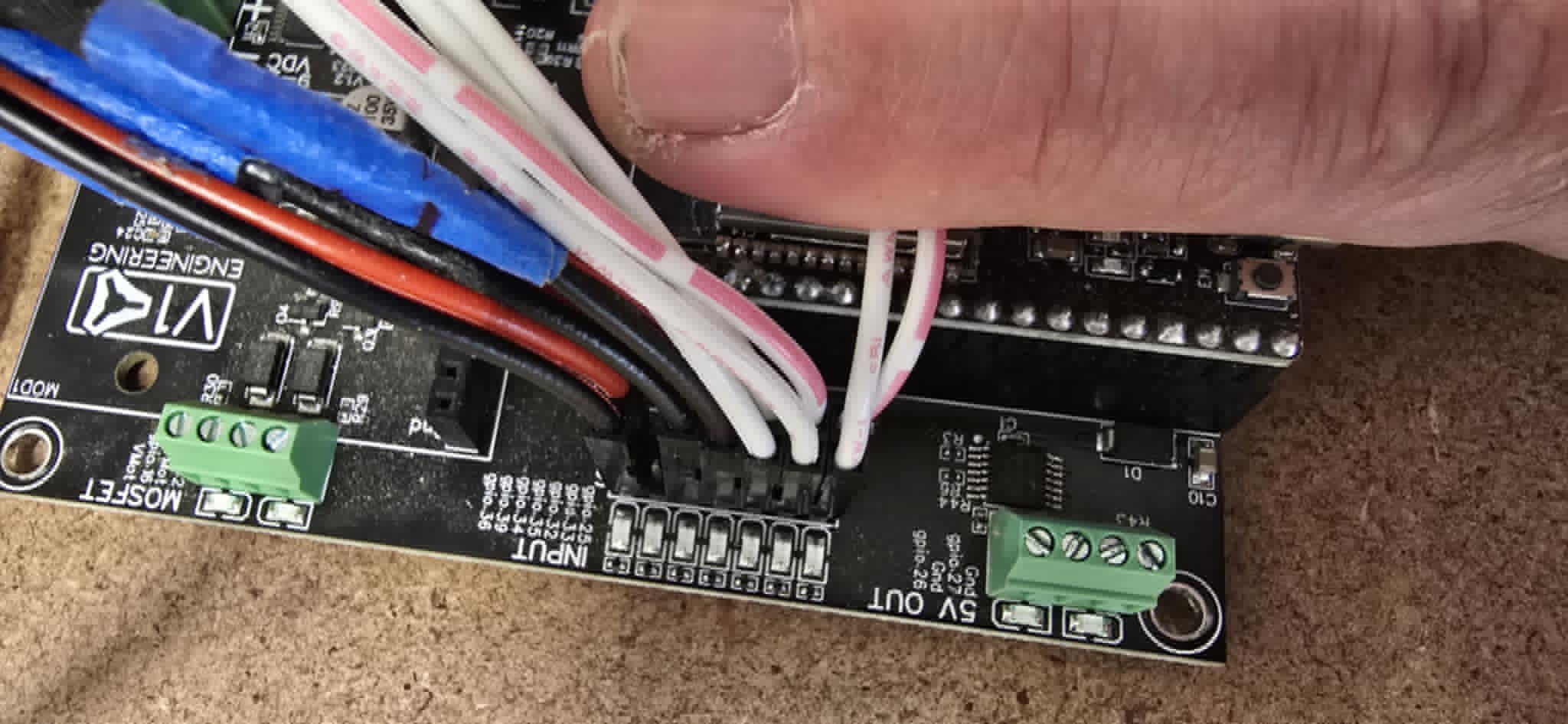

I took a second video doing the same motion, but showing the limit IO LEDs while it was trying. Both LEDs went out when the switch was triggered.
blue painters tape is just from labeling and there is no cuts or nicks in the wire

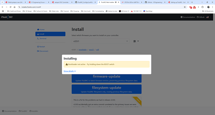

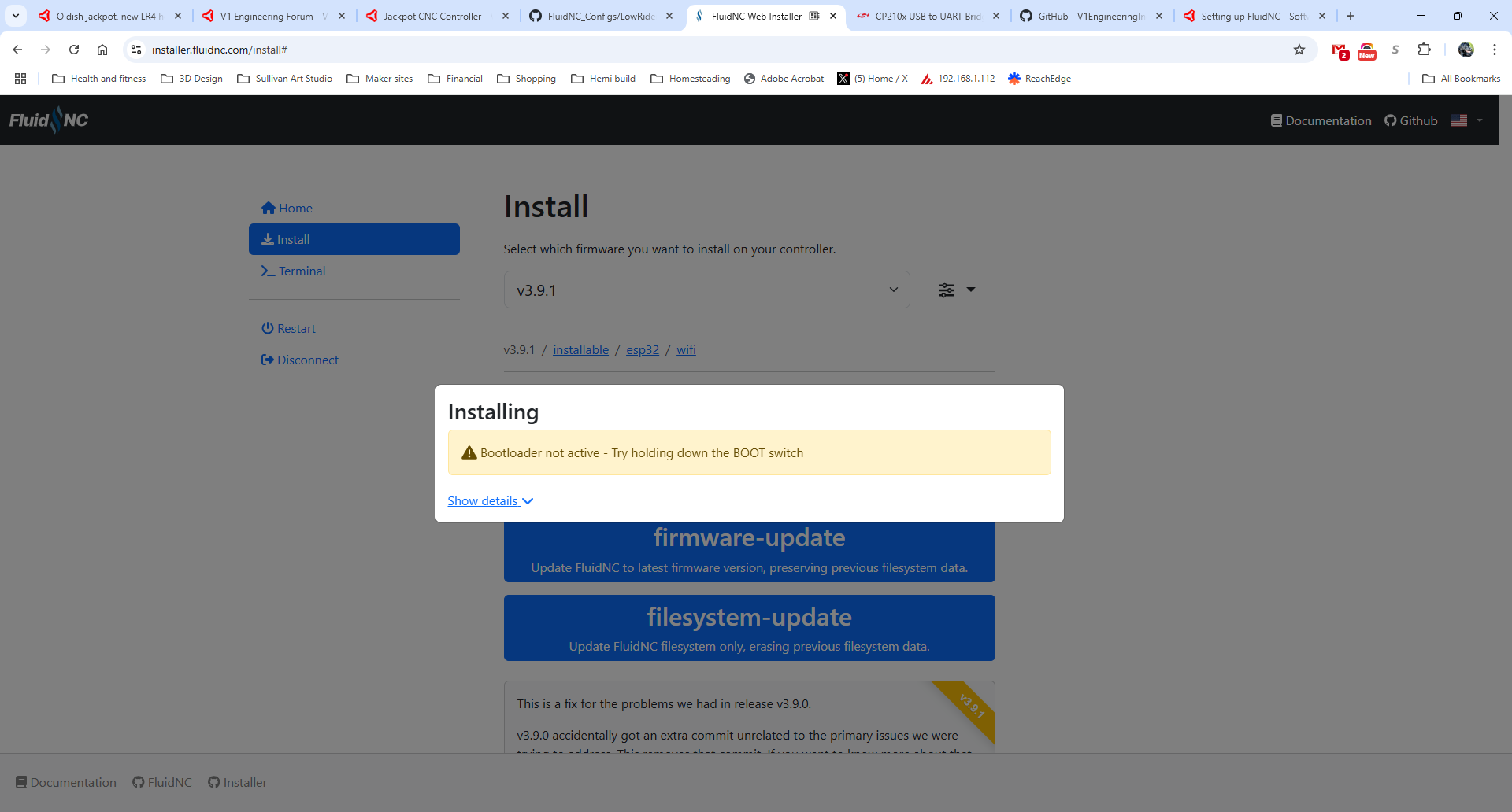

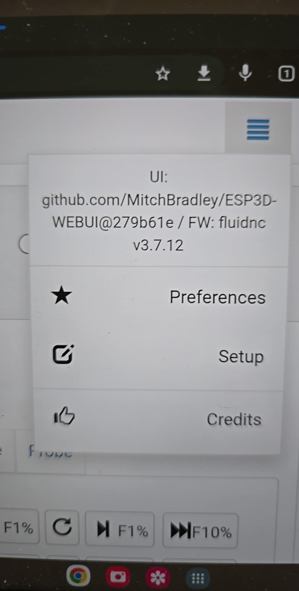

So I mentioned to him that is seems like maybe an issue with the firmware/config. That’s when I found out I am running an old version of FluidNC
So he and I agreed an update to the newer version wouldn’t hurt, but he mentioned not remembering an issue with the homing being one of the things fixed.
I couldn’t do the update yesterday, and wont be able to until some time after dinner the earliest. But I figured since I was going to remove the ESP32, it would be a good time to undo my wiring and put the board in its real home on the machine instead of just laying on the table to test. When I did that I swapped the Z0 and Z1 to opposite sides of the machine. Then I tried homing again. The problem moved from the rail side to the wheel side.
After seeing this, I figured it HAS to be in the programing side of things or the problem wouldn’t have moved. What I am now left with is that Z0 or that IO32 is the start of the issue and the wiring and machine side are good.

[MSG:INFO: FluidNC v3.7.12 GitHub - bdring/FluidNC: The next generation of motion control firmware]

I had 2 minutes so I went and reversed the plug on IO32 and no change.
