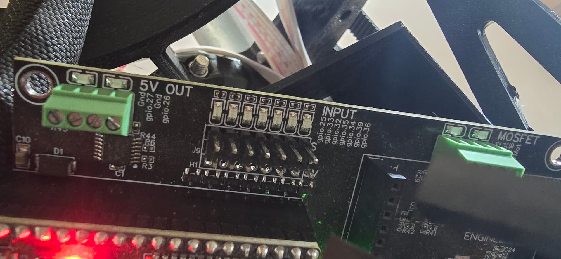

I think I found it. I ran $Limits to test if the signal was actually getting to the brains. X and Y0 both reported when being triggered. Z0 never reported anything.
At this point I am thinking that maybe I go into the config and tell it to use the empty io pin and then swap from 32 to 39. I have (in my nid anyway) ruled out the firmware, config, driver, and wiring. The only think I can think of is that for some reason IO32 is triggering the light but not actually sending the signal. I’m at a complete loss on this one. I could just swap the board, but I dont think that is the answer at this point unless I was trying to use all of the IO pins for other switches and stuff.

So that could actually be the esp32 with a bad pin, the inputs are one to one wired to an esp32 pin.
On the bad input if nothing is plugged in to the port is there a super faint linput light? Trying to figure out if it is the esp or the jackpot.
This sounds like the same issue I had with one of mine but on the probe pin. Difference is the light would not even flash when the probe was triggered for mine. His the light is changing but the ESP isn’t seeing the change. For mine I had to move it to the spare endstop port to fix the probe.

Unplug the endstop from gpio32, power up and turns out the lights. Look for light on io32?
What pins on the esp would be the right ones to take continuity checks?

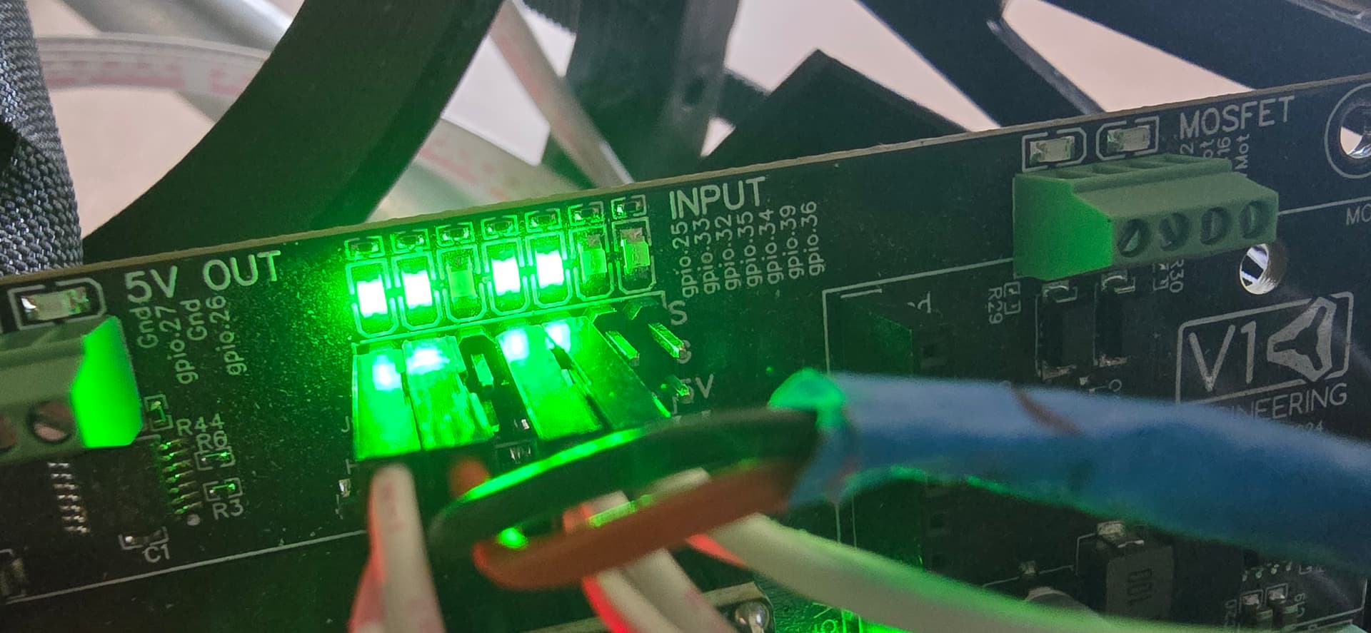

Really hard to tell but looks like maybe a faint light
Unplugged the rest to see it better and i don’t think there is any light
That seems like an ESP32 issue then, really odd. Any chance that something weird got plugged in for a second to that port or some static discharge? We have never seen this issue before, other than an accident.
Easy enough to just change the config either way to use the empty port.
No chance of anything getting plugged in. Static is possible, it’s not like i wear my little esd wrist band and smok etc. Most likely cause of unknown voltage is back feed from the motors. The machine falls when the motors aren’t powered and i have seen it light the leds.

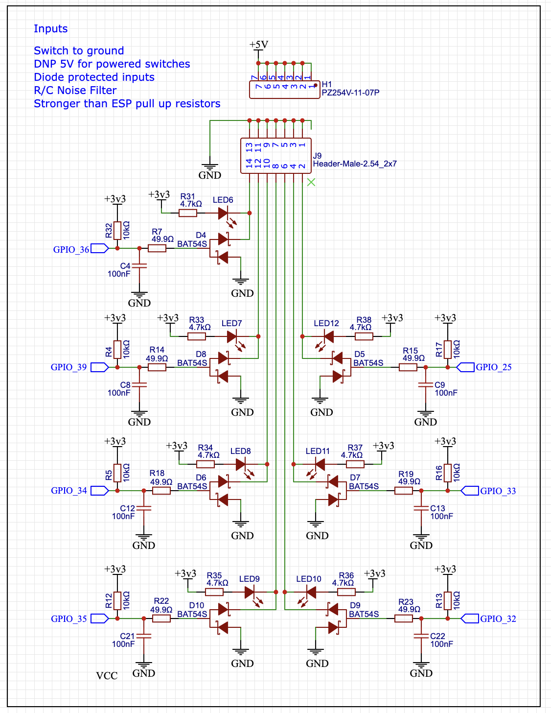

Uh, probably doesn’t. If you are moving the motors with the drivers disabled and generate enough voltage to back power and light up an LED, you don’t really know what ESD diodes or other components are providing sneak paths for current to flow. Nor what that might hurt in the electronics.
Blowing up the board with manual/ unpowered stepper machine motion is rare, but NOT impossible and we’ve seen a few like this recently. Blowing a pin with ESD is also a real possibility.
There shouldn’t be straight continuity. Those inputs are at least mildly hardened with a diode, have a 50 ohm series resistance and a moderately sized (10K) pullup ahead of the GPIO.
Edit: Yes, I would be interested to know what is measured for the bad (and good) input pins back to their ESP-32 Pins on this particular board.

If you have a list of things you’d like to see tested I’ll check. But I’m not well versed in what pin goes where. So if for instance you want to know pin 6 on the esp to pin 2 on the io port, I’ll need that level of information. I can take voltage drops too as that is likely a better measurement than just resistance. I just need to be spoon fed locations because i don’t know what goes where on this board.
