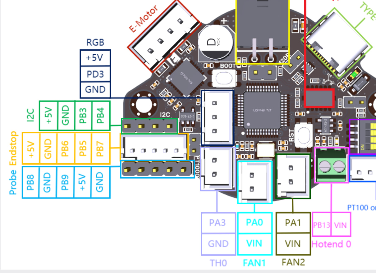

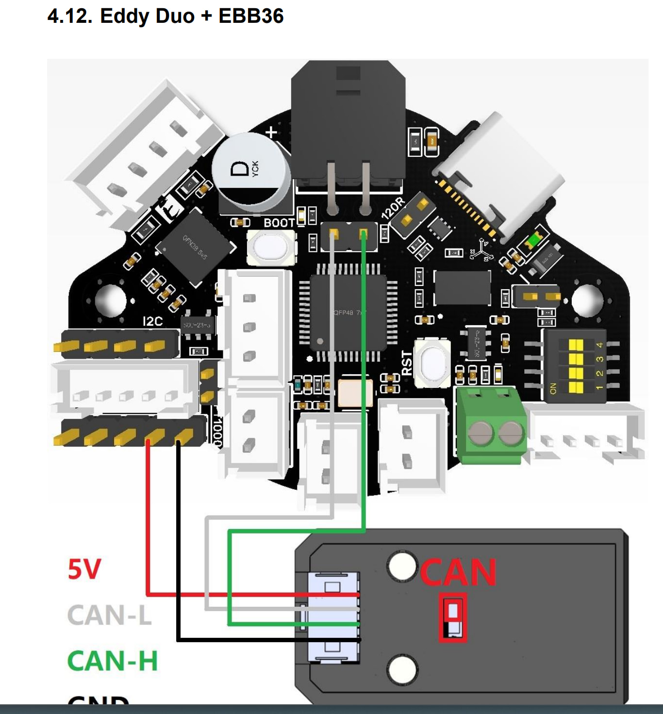

If I’m reading things correctly, I’d use the I2C pins for the CAN breakout to the eddy.
I’m 99.9% sure that’s how I did mine. But I am not sure what the difference is between the version I have and the new one you got.
Well shit. Helps if I just read the documentation…
Yeah that’s different than mine, and looks much much better. Read and make sure the eddy has the 120 resistor in it already. And then don’t put the jumper for the 120R on the ebb36
what I’m reading is the pins are before the ebb36, so I need the 120r on the ebb36 jumped
Ok good deal. Hopefully that means the Eddy doesn’t have a resistor in it. You’ll find out soon enough if you have communication or not :rofl:

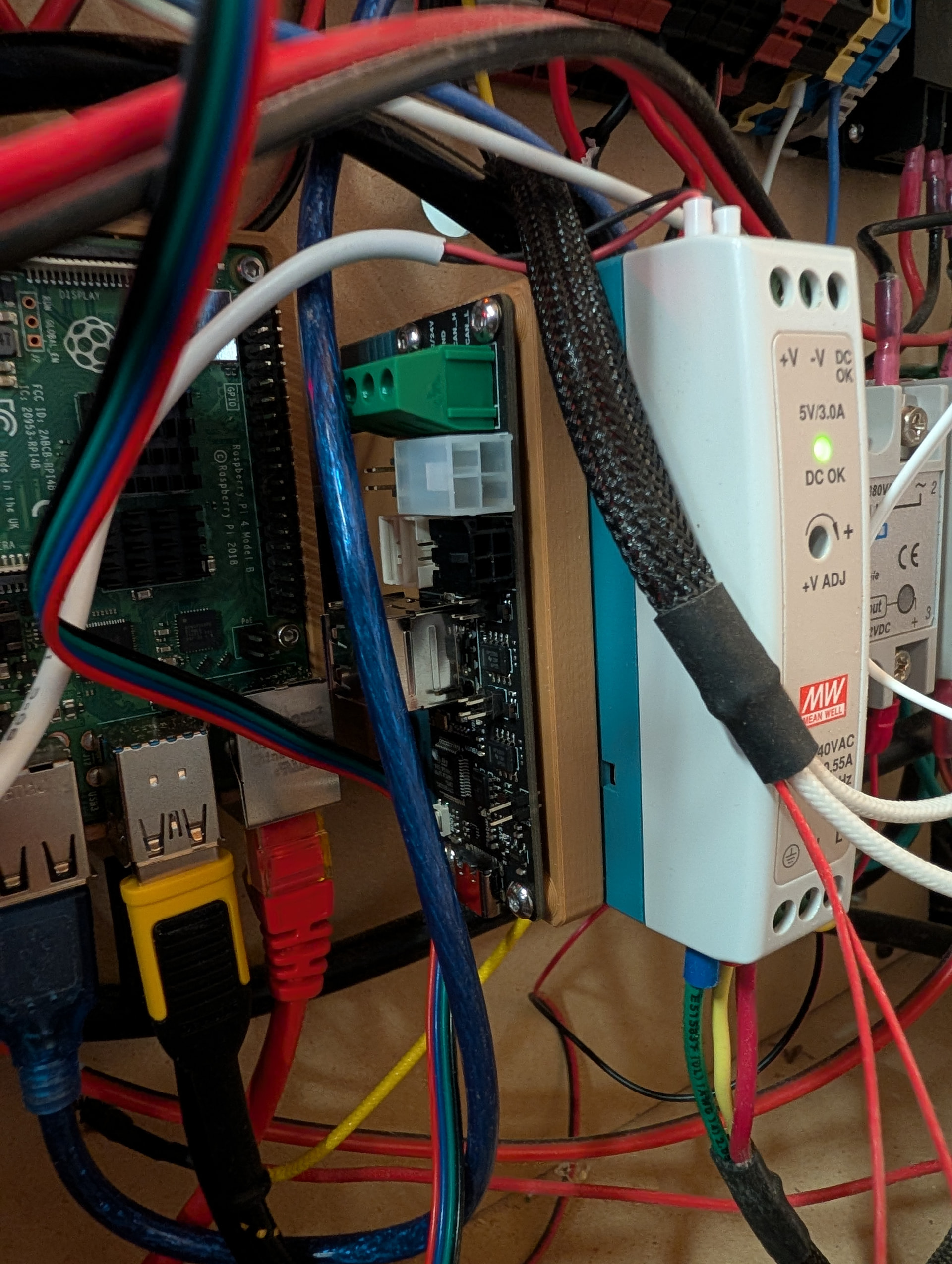

USB-C hub added and just sitting in bottom of the electronics box. I may not need this anymore. Need to setup the eddy before I take it out, though.
klipper sees the ebb36 mcu
New DIN rail mount is printed for U2C, but I want to print another version with some wire management for the 4-pin connector.

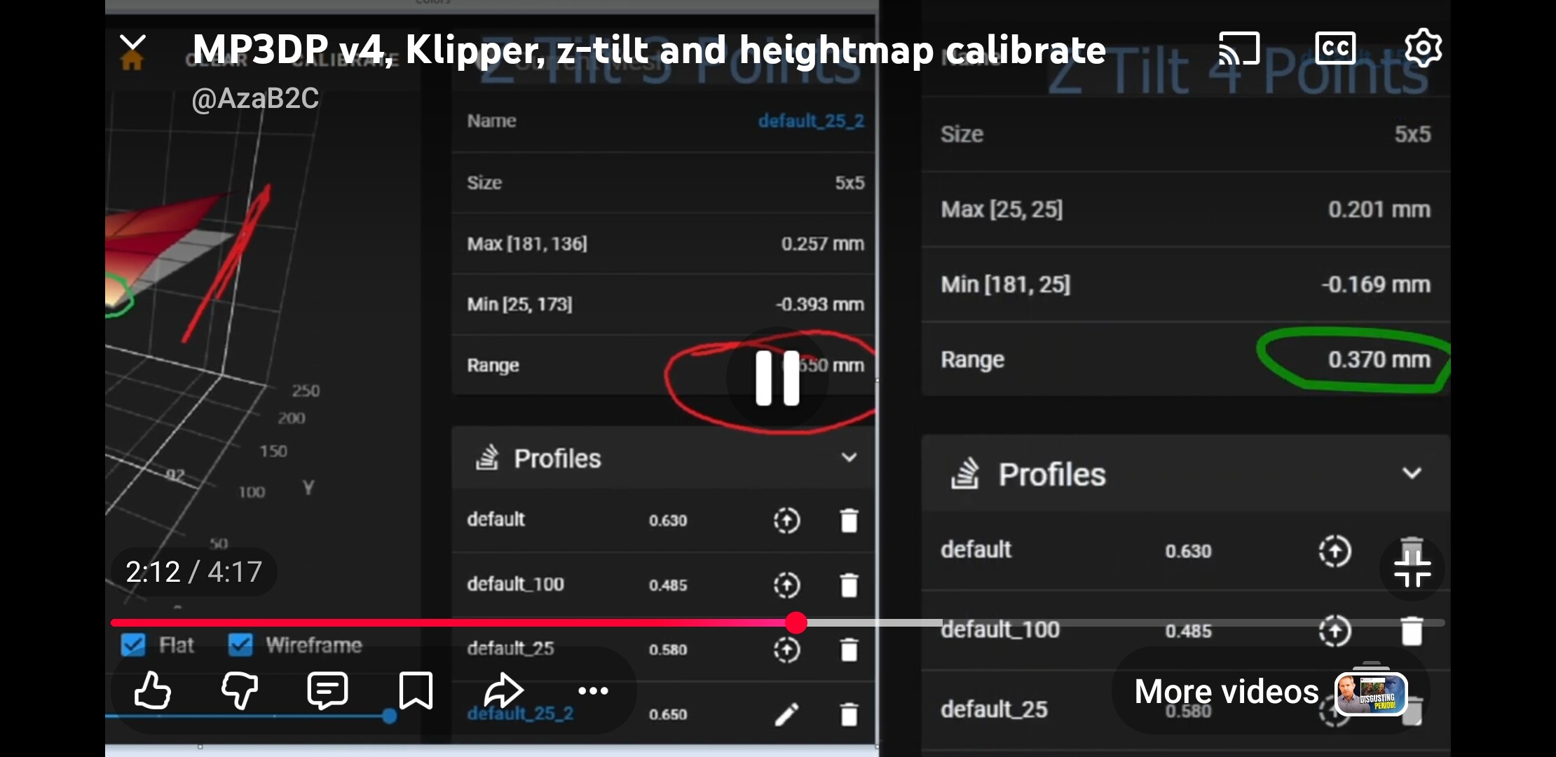

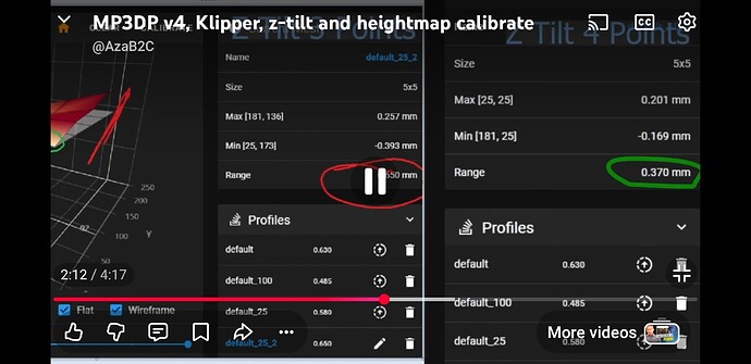

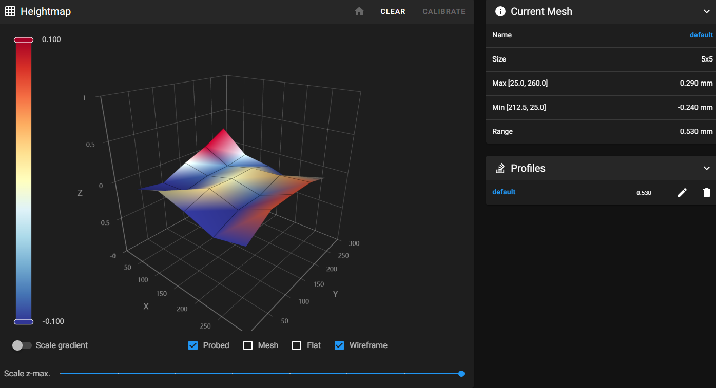

In printer news… I’ve also been slowly flattening my build plate through the use of copious amounts of aluminum foil. Still not great but better than the .8mm I started off with. I’m really thinking I need to buy a new magnetic sheet and pull this one off and surface the Aluminum plate. There’s a high spot in the one corner that’s f’n everything up. And it’s not a ‘tilt’ issue. The plate just goes up in that corner. You can see it with a flat edge.
Already tried 4 point leveling instead of 3 to see if that helps reduce overall variance to acceptable tolerance? Guess 4 point z-tilt might balance out the pivot twist a bit.
I lent the first one to a student and she lost it… Already reordered it. You can see when I started reading the series, shortly after the last one came out, when the small paperback hadn’t been released. :grinning_face_with_smiling_eyes:
The series brought me to the books. The series is also awesome, since the original writers were involved. All the changes make sense for TV.
no. I didn’t try that yet.
4 point tilt helped me, 0.37mm instead of 0.65 with 3 point…
Also, for my build, some of the “plate twist” was contributed to by how linear rail was mounted to the 2020, and/or frame’s overall skew.

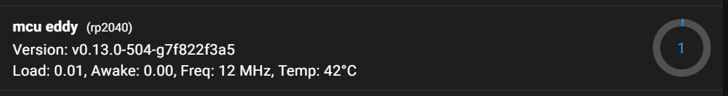

one step closer. Still designing the mount. Eddy is connected via CAN off of the EBB36. The resistor jumper is in place on the EBB36
I had to loosen up the tolerance to <. 4mm for the 4 corner test and still had to add some aluminum to the lowest corner. But I’m down to a max difference of .25ishmm. It could still be better but I ran out of testing time for now.
