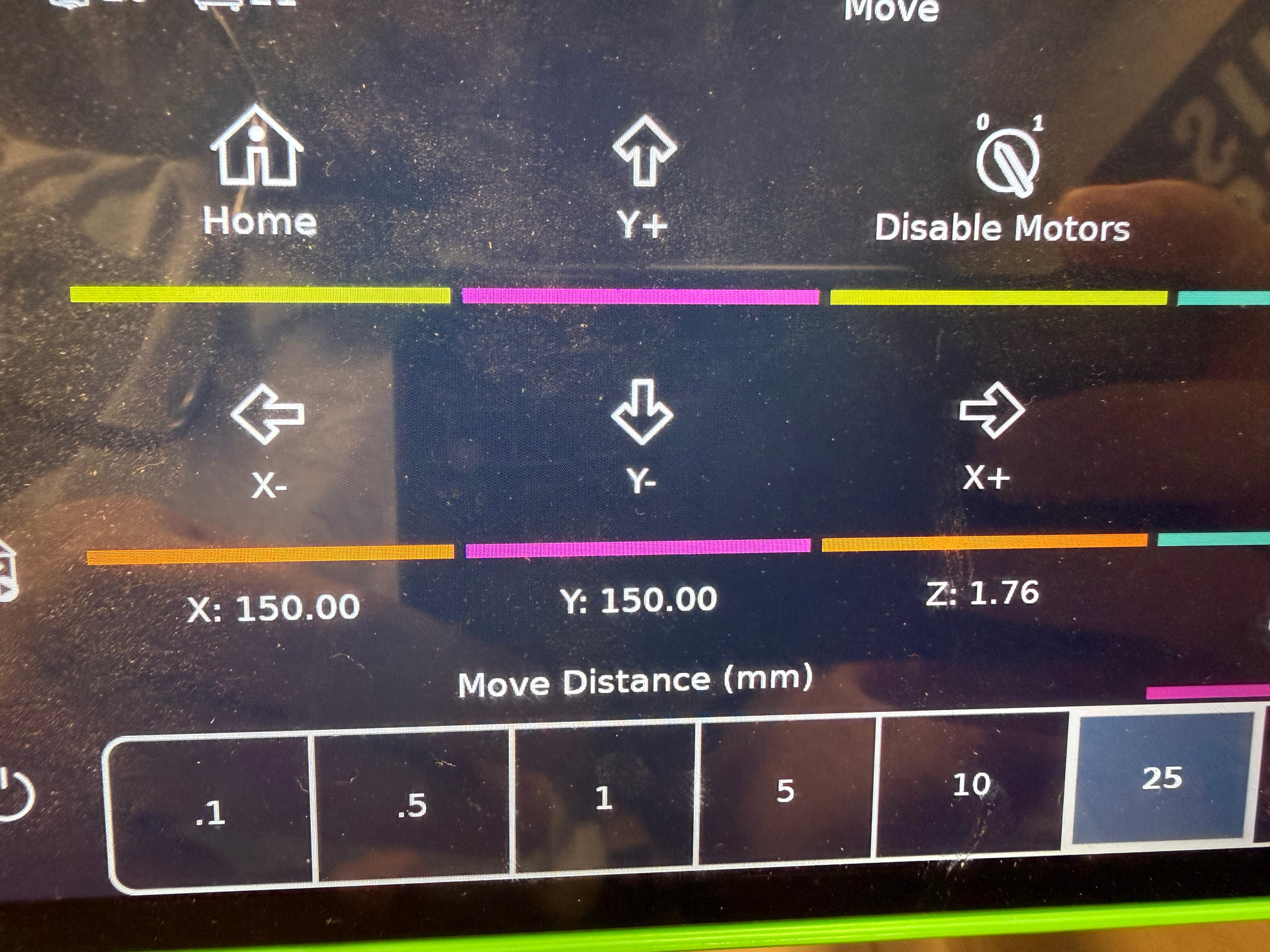

It also looks like my Z offset is only 1.6mm and the manual wants that between 2 and 3. So I need to bump it up.

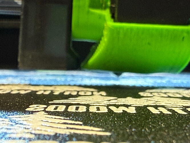

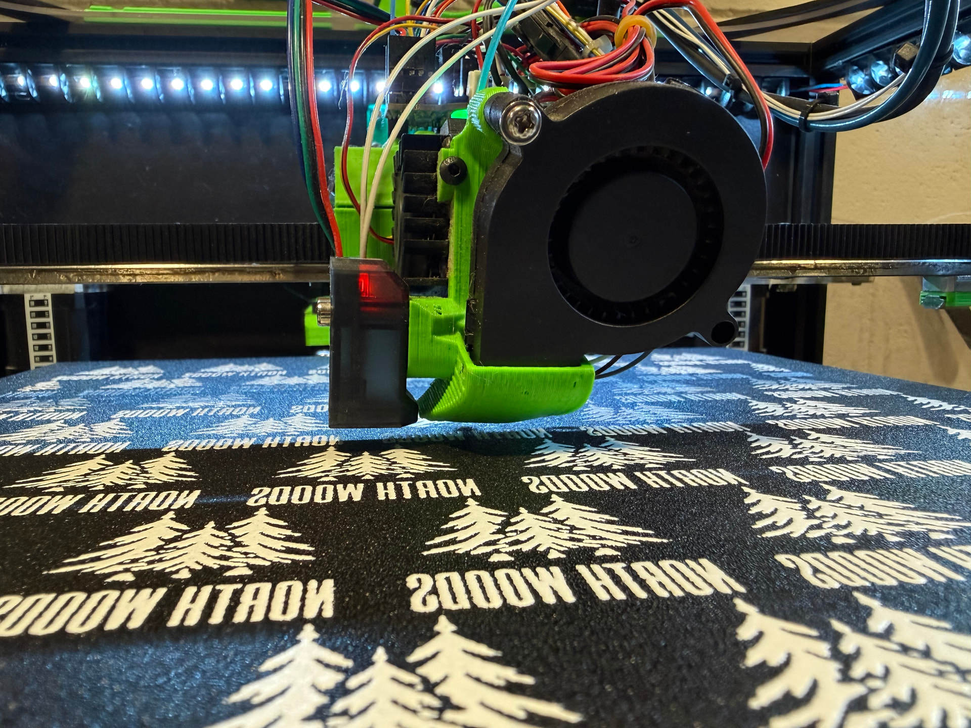

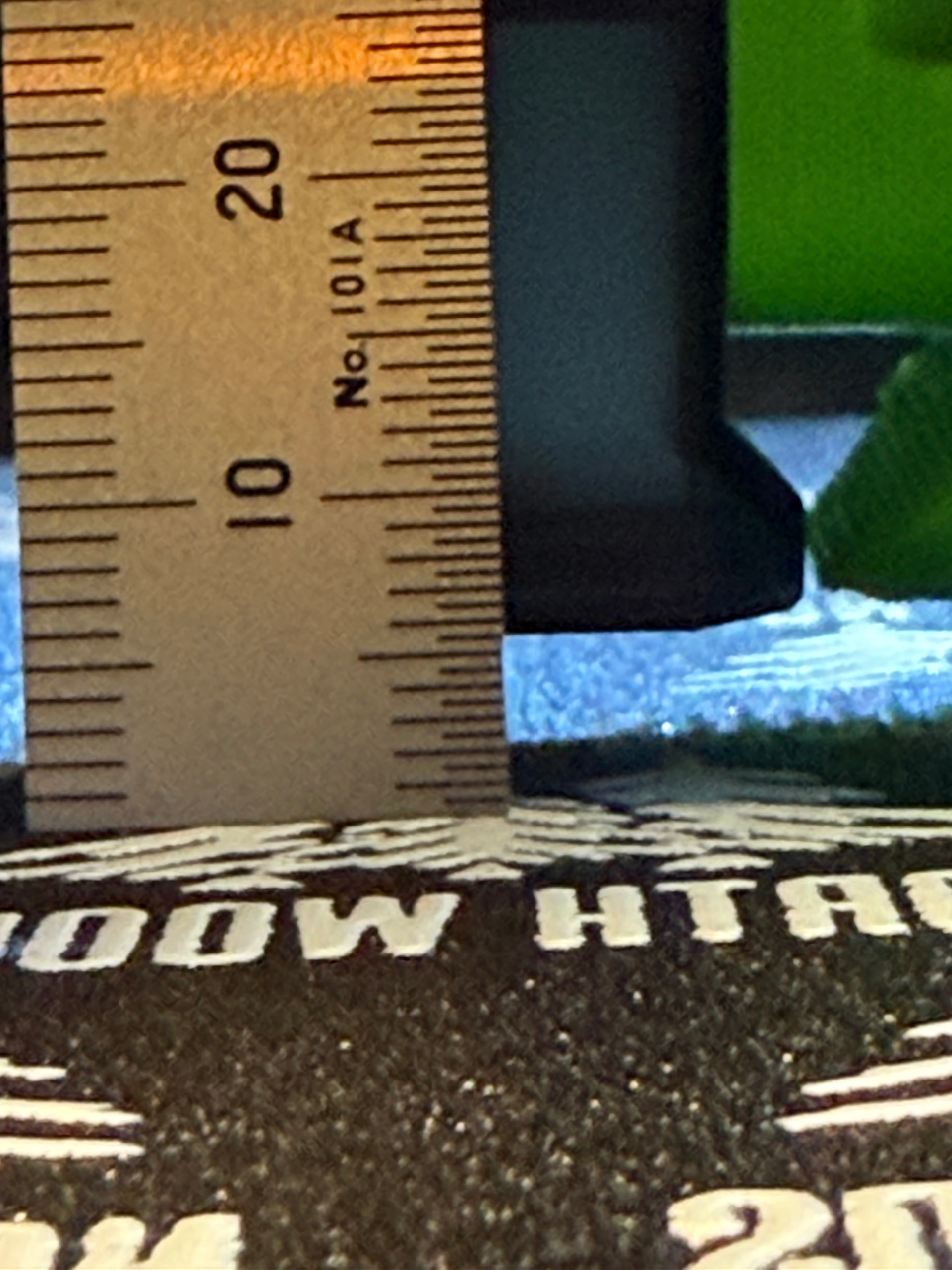

Mine is not far off the bed at all. I don’t have an exact measurement. Also make sure it isn’t too close to the nozzle. I have read in the past that can throw it off if I remember right.
When I’m doing the eddy probe setup, the eddy can hit the board before the nozzle is close enough. I still think there’s too much weight way out in front of the core on this design and it twists the entire extruder/fan/probe assembly. I just don’t know how to fix it.
Yeah mine isn’t lower than the nozzle. Best guess from my blind eye looking at it is 2-3mm higher than the nozzle. I can crank it up and get a good measurement if that will help
Can you snag me some pictures? Or point me to where you have some posted?
Yes sir. Just give me a few
No rush. I’m about to pause working on this to go change the oil on the truck. I did the fuel filters yesterday when the printer pissed me off :slight_smile:
I got lucky and was able to change mine at work last month lol. I did supply my own 2.5 gal of oil though lol. My fuel filters last a good long while. 2 on the Airdog pump and the one in the stock location. Might just delete that stock one soon, its a royal PITA to change.
Not the best pics but hopefully they help. If you need something else or a different angle just say.
Looks like the Eddy is about 3.5 - 4 mm above the height of the nozzle.
thanks. that gives me some ideas.
