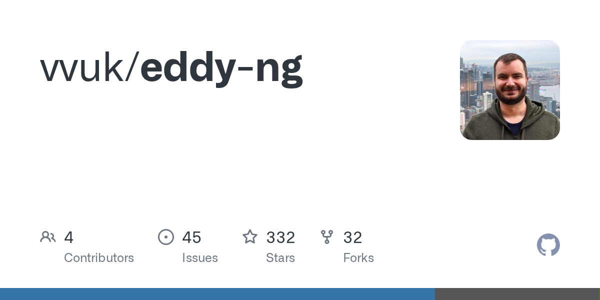

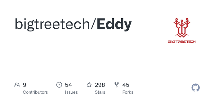

That is the one BTT recommended last time I talked to them. not sure if they ever updated the official eddy support or just use that one now.
I’m running out of USB ports and I’m not sure if the eb36 supports daisy chaining CAN off of it. Something about a resistor and I haven’t figured out if the Eddy has the resistor on it or not.

Yes it does. Just don’t put the jumper on the resistor if its not the last piece in line
Thanks. I hadn’t taken a look at the schematic yet to validate.
