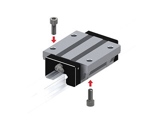

Anyone seen, or already using, linear rail blocks that can be rear/back screwed? Like this flanged rail block, but with untapped pass through holes.
If so, could that help to simplify Core, or at least get more direct contact between linear block and Extruder? “Core plate” ends up being a milled Alu plate sandwiched between linear block and extruder. The “Core plate” ends up large enough to mount probe/EBB directly and/or via 3D printed parts. Assembly would be…
  • Mount Extruder to “Core plate”
  • Then mount “Core plate” to rail block via rail block’s rear accessible mount holes…
Could achieve something similar using stock rail block by using 2 milled Alu (or 3D printed?) plates sandwiched between the rail block and Extruder I guess? The MP3DP rail would need to be rotate 90deg about x axis though. Assembly would be…
  • Mount Extruder to “Core plate front”
  • Mount “Core plate rear” to rail block
  • Mount “Core plate front” assembly to “Core plate rear” assembly.
Completely replacing stock linear rail block with your own Alu rail block sounds tricky. That would provide an opportunity to have longer rail block though (more stable?) .
If not a completely new linear rail block, then could maybe Alu mill and/or 3D-print single part that replaces the side seals with mounting holes for Extruder, etc…
Ideally stock extruders casings (or optional upgrade casing…) would include mount hole layout/spacing for common (?) rail block. So no shims or adaptors plate(s) are needed.
