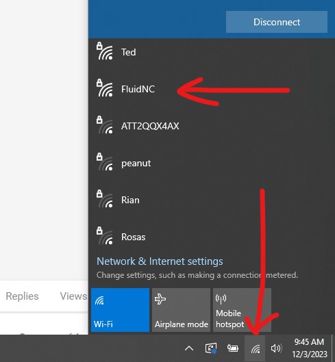

Nothing works every time? The wifi should be 100% provided the SSID pops up.
I dont understand this. SSID pops up where
At this point any program you can get to connect I will use. I think the wifi is the best choice but anything you can connect I will help you trouble shoot.
You know. I was in contact with Joacim and he assured me flluidnc was a valid choice. I have neabt to test it but right now i do not have a pc near my cnc. Maybe after the lions game today i can get this a priority. I want the joystick part!
Give me a minute and I will get to the wifi.
