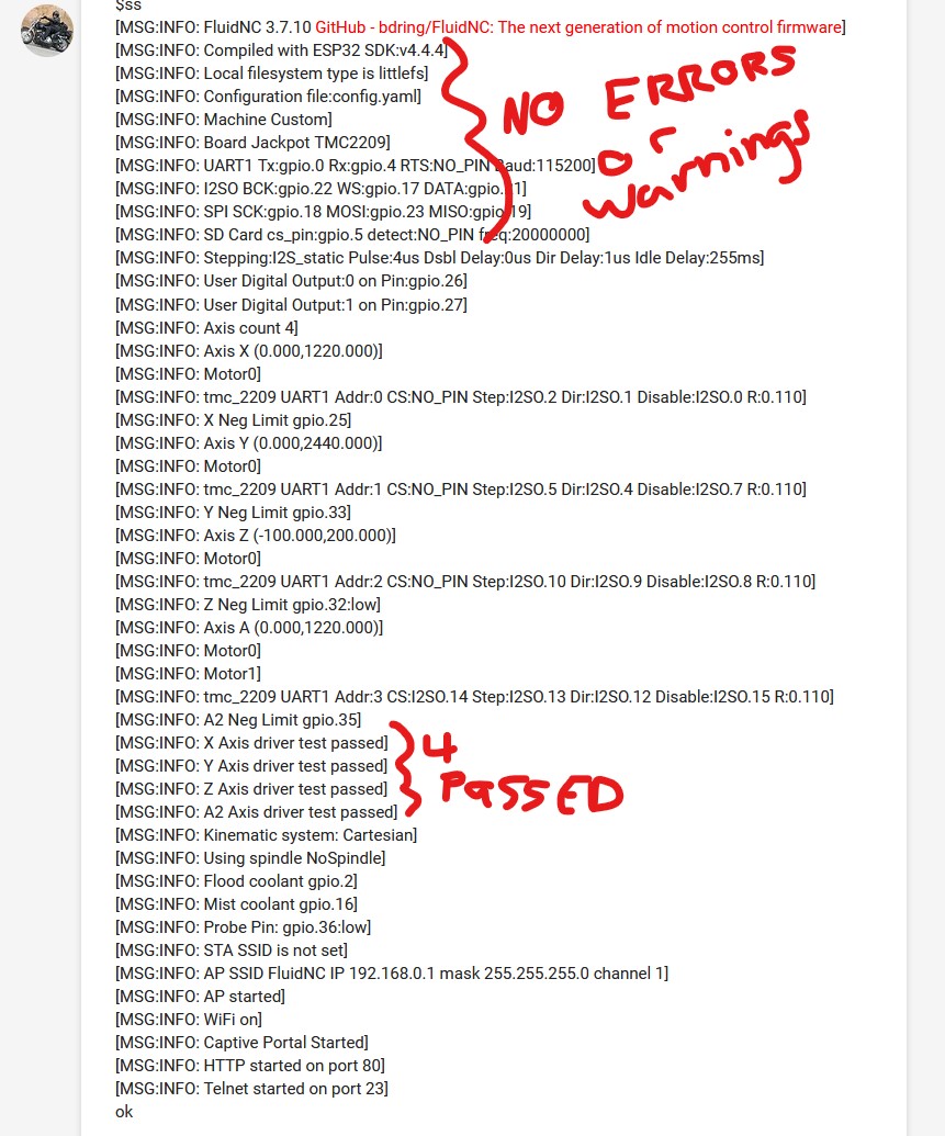

What is your current best way to connect, as in how are you getting the $ss results?
Got one from FluidNC
and one from Chrome.
Please give me a moment to load your config and get you a new $ss from there
When you load a new file, or firmware, after it finishes, you need to completely power off and reboot using the power supply before plugging in a USB cable to allow it to load the drivers to have power to connect.
Just loaded your config and did $ss

That all looks perfect.
How are you going to connect to try and move a driver? What sender/control do you prefer
