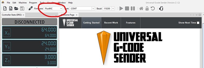

Did you change it to “FluidNC” as I showed in the previous screenshot? I will not help you in anything other than UGS or the built in sender at this point.

Have had that set all this time.
This is ambiguous. The chrome tool loads both files and firmware. Did you erase and flash new 3.7.10 firmware or did you load MY config file, or both?

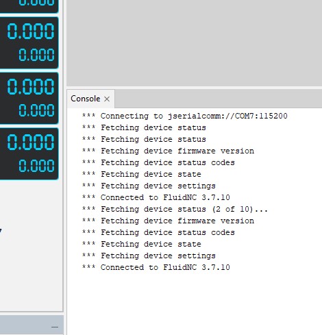

Com port correct and Baud rate?
Read the bottom first and the top after. That is how they were copied
absolutely correct port and baud
This is how mine connects.

That $SS you just showed is not working correctly.
How did you get the $SS?
You can not connect two devices to the Board at the same time. Either you use USB, or you use wifi, not both.
Also you should completely power down and reboot before switching controllers. Please go back to my working and confirmed config.yaml please.
