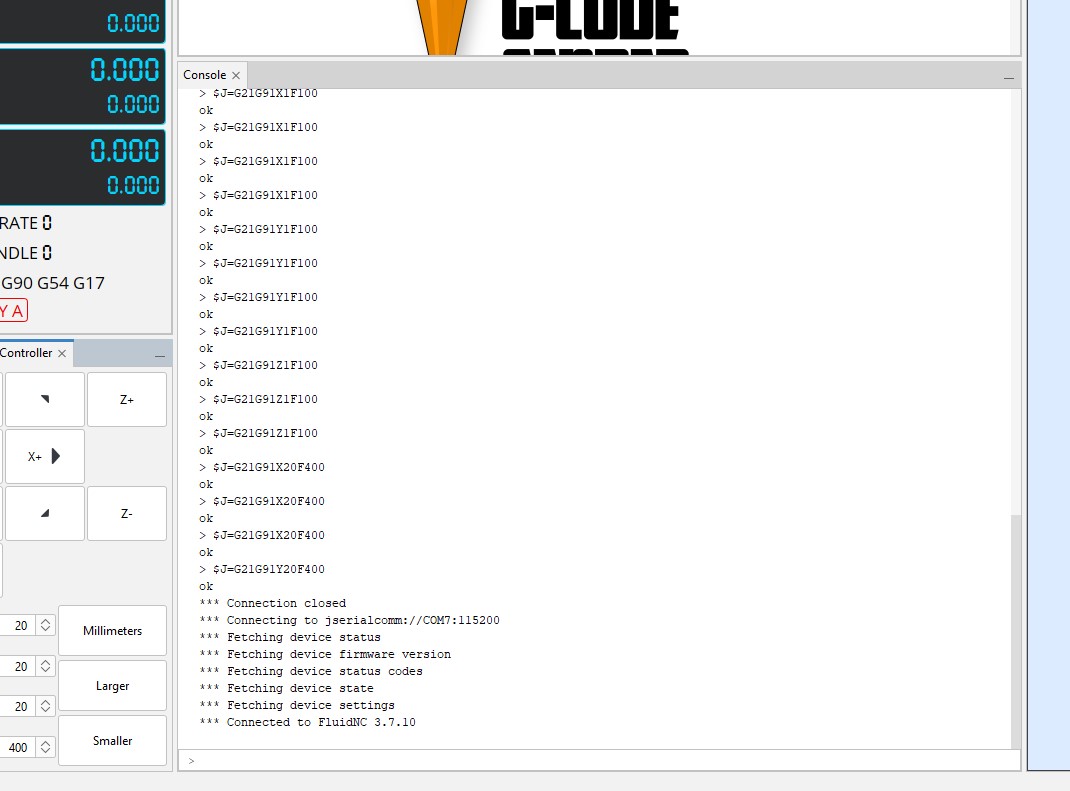

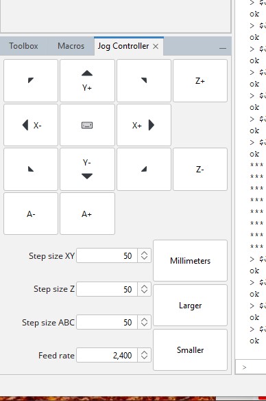

No stepper movement with new Jackpot board
I am doing everything I can to help. Please understand I am doing this blind and the only help I have are your words and pictures. “same problem” means nothing to me since we have had all the problems.
Bad esp?
UGS not connecting?
One stepper moving?
No steppers moving?
Not connecting at all?
Please use the onboard sender, run $ss and let me see the output. It is the most info I can possibly get. Then tell me what the steppers are doing.
That will tell me if somehow UGS is flashing or erasing the ESP’s, or something else is going on.
I understand your position. I could tell you some stories about IBM-PC and -AT computers that are just as wild as what I am seeing now. It was tough back in the mid ‘80’ up until the mid '90’s being a service manager and software support backup person. I know all about the bleeding edge.
Please do not use UGS with this board at this time, there is a confirmed issue as I mentioned above with the link. You have used it several times and I suspect this keeps erasing the boards.
Yes, yes it actually did. $SS now shows the correct information. That is the biggest step we needed to take. That is why I keep asking for you to run it again to verify it is all still running as expected.
There should be no USB connected at this point. Power and the 4 steppers. You should be connecting over wifi and USB should not be connected at all.
You should never see a boot screen, where are you seeing a boot screen? When you log in over wifi to FluidNC, it is the sender screen, there is not boot screen on Fluidnc.
You are taking extra steps (swapping computers and power supplies, and different programs). Please just follow my requests one at a time. This is very difficult I understand, but from my perspective I ask you for $SS and you tell me you are changing things a half hour later. I can’t keep up, and I have no idea what you are doing.
Please.
Lets start from this point right here.
1-With power to the jackpot, the esp32 and drivers plugged in as well as your 4 steppers. Please power it up and use a wifi device to log into FluidNC (no USB cables needed), use the onscreen terminal to Run, $SS. PLease list what happens. Do you see SSID FluidNC, can you connect, can you run $ss, if so what does it say?
Nothing here is bleeding edge, this is all kinda old stuff at this point and fairly stable.
You should be seeing this screen,
It has a terminal, controls, and a sender (as well as a bunch of other things).

Hello, Dan. I"m obviously not Ryan, but have been following this thread as I often try to help (I’m just a customer and community member.)
I’ve tried to follow along but must admit it’s been difficult for me to keep up with the.troubleshooting.
I couldn’t quite figure out why this thread had me scratching my head.

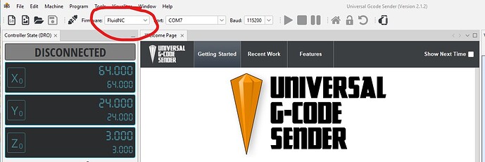

This helps me understand what your setup is, and also how that relates to this:

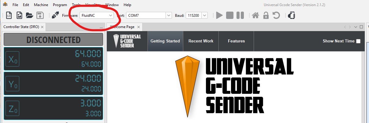

UGS appears to be your preferred sender, and I certainly understand not wanting to change from software that works for you on your other machines. But, there seems to be an interaction that UGS has with FluidNC that is causing corruption or erasure of the FluidNC ESP32s or thier configs. Since FluidNC/ESP32 controllers use USB bridge ICs for both managing gcode sending and also for programming and config file upload, it isn’t completely surprising that there are issues.
I suspect at some point UGS may get a fix once this is understood, as it is a new controller type that UGS hasn’t previously supported fully.
Other software has had to sort this out as well. For example, Lightburn had to add an option to manage the DTR signal because while that signal is needed for some other USB connected board types to work properly , others like the FluidNC controllers don’t work properly with that same signal asserted.
This isn’t a defect in the Jackpot in my opinion, it’s an incompatibility with UGS.
It’s likely that Ryan or others like myself could re-flash your jackpot/ESP32 and get it running happily with other senders, and then all of this would repeat if that board gets connected up to UGS again.
It may be that in the future if a fix is developed to allow UGS not to have this bad interaction with ESP32 FluidNC controllers that this setup would be workable for you, even if the networking and UI of FluidNC doesn’t suit your use case.
I’ll bet that Ryan and the rest of the community here will keep trying to look for a way to address this since it is now understood that UGS has this incompatibility with FluidNC.
Since it appears that UGS needs to handle these board types properly, theres not much the community can do until that happens.
Whichever way this turns out, I hope you’re able to get your Sherline working correctly. I had a Sherline mini mill for a while, until the controller box died- just as you have experienced. That one had the DRO option and encoders on the steppers. It was a great little mill, and I was just starting to learn how to use it fully when it died.
I ended up giving that machine to a kid at the local makerspace who had the energy and time to try and make it work.
If at some point the issue with UGS gets sorted, then at that time it may be worth trying a fresh flash of the Jackpot.

I might have solved the problem. Give me an hour or less and I will let you know.
Have gotten this far 3 times in a row.
[MSG:INFO: FluidNC 3.7.10 GitHub - bdring/FluidNC: The next generation of motion control firmware]
[MSG:INFO: Compiled with ESP32 SDK:v4.4.4]
[MSG:INFO: Local filesystem type is spiffs]
[MSG:INFO: Machine Custom]
[MSG:INFO: Stepping:I2S_static Pulse:4us Dsbl Delay:0us Dir Delay:1us Idle Delay:0ms]
[MSG:INFO: User Digital Output:0 on Pin:gpio.26]
[MSG:INFO: User Digital Output:1 on Pin:gpio.27]
[MSG:INFO: Axis count 4]
[MSG:INFO: Axis X (0.000,300.000)]
[MSG:INFO: Motor0]
[MSG:INFO: Axis Y (0.000,300.000)]
[MSG:INFO: Motor0]
[MSG:INFO: Axis Z (0.000,300.000)]
[MSG:INFO: Motor0]
[MSG:INFO: Axis A (0.000,300.000)]
[MSG:INFO: Motor0]
[MSG:INFO: A Axis driver test passed]
[MSG:INFO: Using spindle NoSpindle]
[MSG:INFO: Probe Pin: gpio.36:low]
[MSG:INFO: AP started]
[MSG:INFO: WiFi on]
Grbl 3.7 [FluidNC 3.7.10 (wifi) ‘$’ for help]
Any hints?
I made progress on UGS, and I will need to go to the shop to install and test the fix.
possibly power 110v 24v supply
UGS works fin you just need to tell it you are using FluidNC, they fixed it last month or so.
I flashed another board with new firmware (chrome installer, erase option), loaded the config I sent you (chrome installer, upload file options). Removed the USB, and powered down the board to reset after flashing, plugged the USB and Power back in, connected to UGS. Everything works as expected.

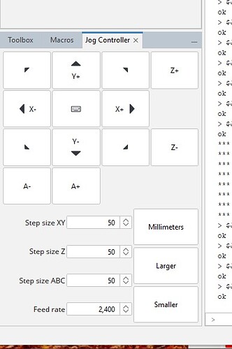

I will say by default UGS takes very tiny very slow steps by default. I changed those to be able to see the steppers move. (shown in the last screenshot).
