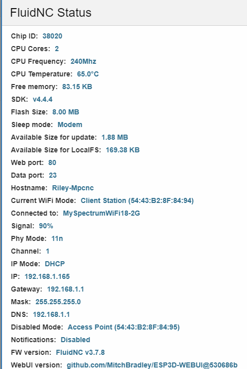

Wow, I knew that when i created the MPCNC I wanted joystick movement, (moving via the screen always messed me up, 10mm, 100mm, crap, too far) BUT WOW, silly me, I think i could have moved that with the controller all day and been quite content, lol. fluidnc 3.7.8 and UGS, (freshly downloaded today) work great so far, as Ryan said, LOL.
while ugs set up and connected, I decided to connect via web interface and it works well too.

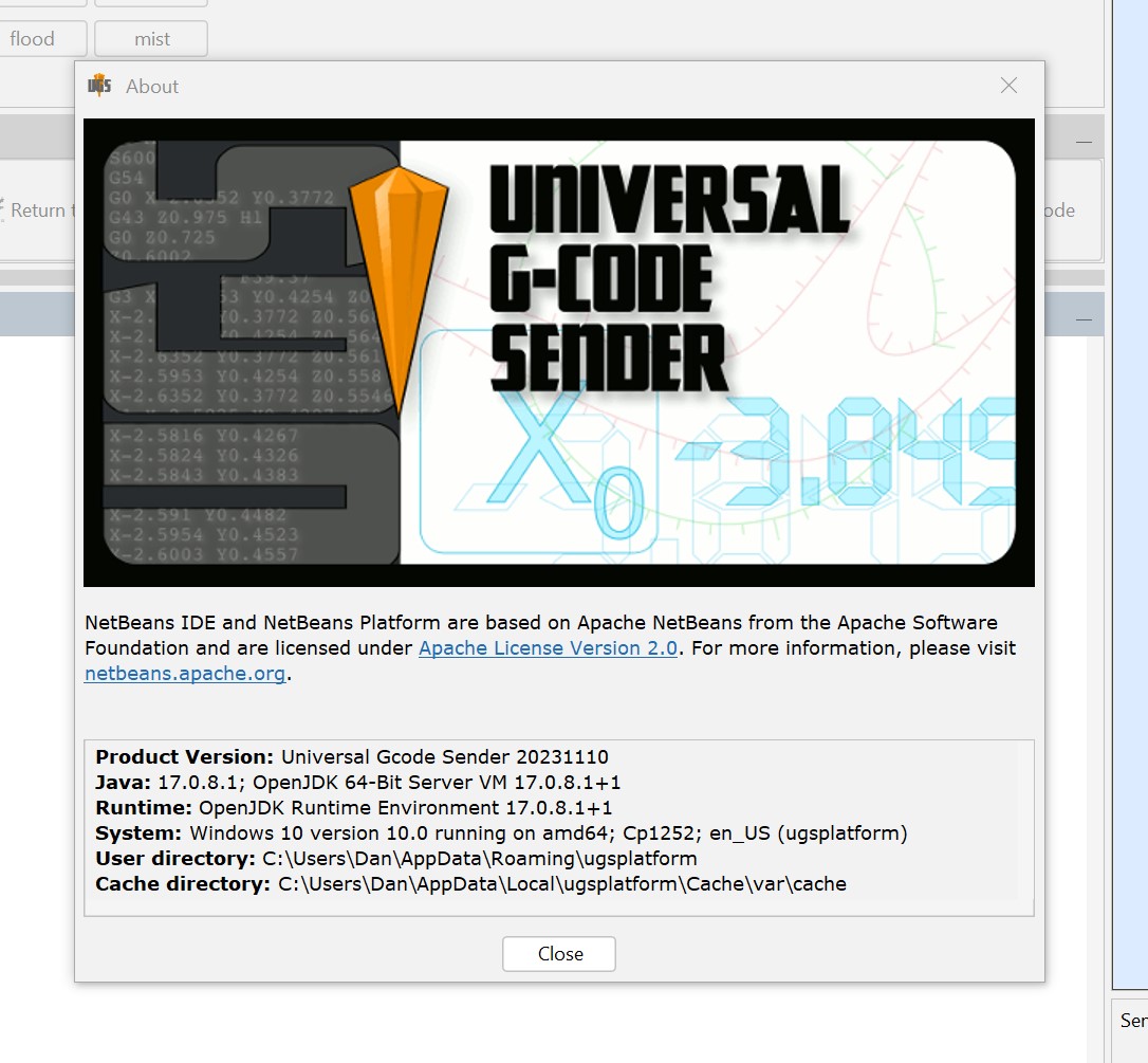

So, Guess what, there was a problem, you have to download the LATEST version. Someone else just posted this and the response is below.
  1. Hey I tried the same method with UGS. I selected FluidNC in UGS and adapted the FluidNC Start/Message to: “FluidNC 3.7.10”. But when trying to connect to FluidNC it shows: "Expected a ‘FluidNC 3.3.0’ or later but got ‘GRBL 3.7.0’ ". When I select GRBL ESP32 in UGS it connects just fine, even with the FluidNC Start/Message.
December 5, 2023
Joacim — Today at 5:32 AM
UGS had a very strict version number check for FluidNC. And the FluidNC 3.7.10 got a slightly different version string which UGS couldn’t parse. This should be fixed in UGS 2.1.2

I have downloaded 2.12 again just now.
About screen shows -
Your steps per mm, and driver current will need to be adjusted for sure. Other than that, the rest should be good to go.
CNC.js should work now that you are using the latest release.
