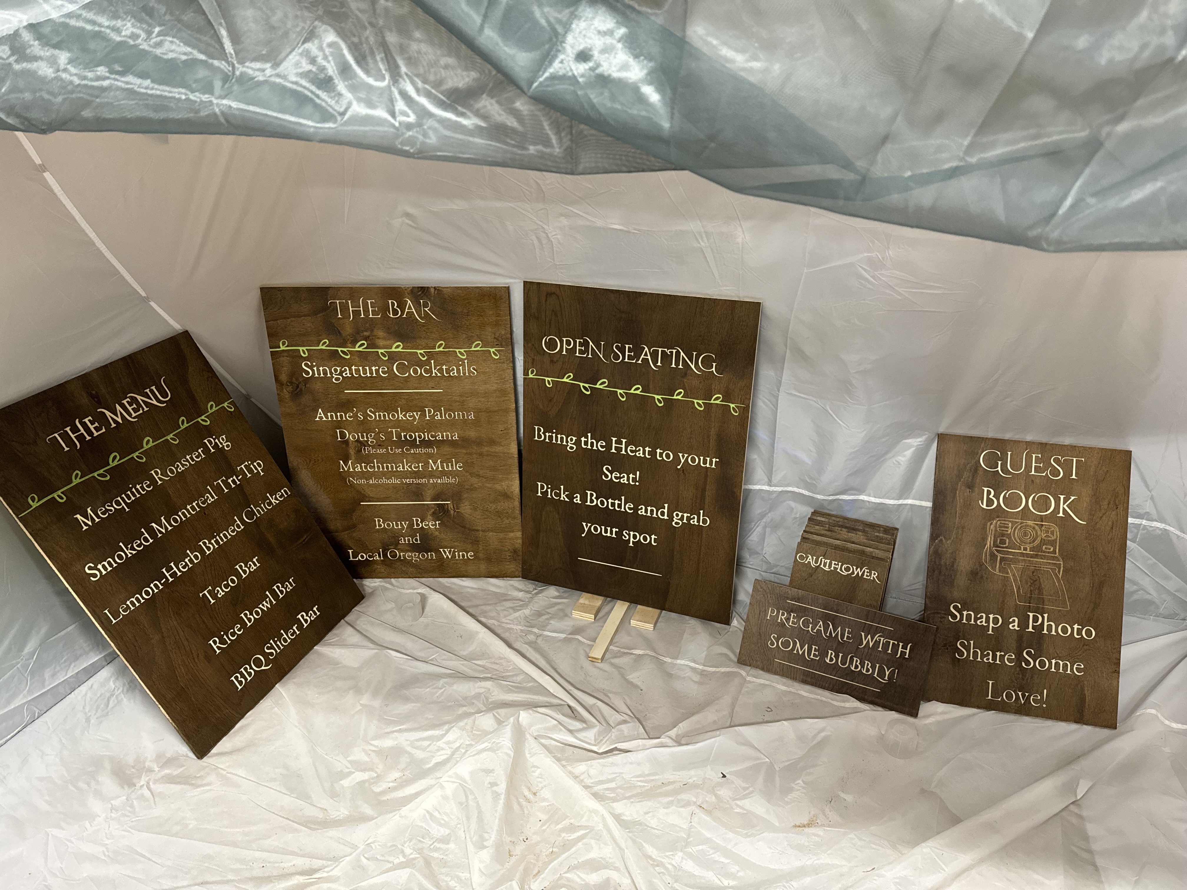

Looks like you used a softwood like pine or fir. Use furniture grade hardwood like alder or beech if you want better detail.
You can also mask the board before you carve with stencil film. This is a trick of the pros, and what I do.
Stain or paint the board with a non oil base product (the stencil film won’t stick to the oil based stain for a week or more and really delay your process- I did this once on a job where I was making 40 signs for a wedding- huge problem)
Oramask 813 Stencil Film 12.125… Amazon.com
Cricket makes a mildly superior product called removable vinyl for 6x the price.
After carving, lightly spray the lettering with spray paint, or air brush. Then blot lightly with paper towel to absorb the access paint on the film, then peel immediately. (A vinyl sign pick helps immeasurably). I used an ivory paint color for the lettering in the examples, and an avocado color for the accents. After a couple of practice pieces, you will be able to get perfect lettering with zero bleeding.
These were all cut into sanded plywood from Home Depot (not a great choice for detailed engraving, but the customer provided it, pre-stained, with oil based stain :frowning: ) I then hit them with a couple of coats of matte polyurethane. Avoid gloss/ semigloss at all costs for most casual signage.

We can figure out a way to DM once you’re ready to try the masking, etc. Your signs look great, I think you’re way closer to having a totally pro product that you think. Speeds and feeds could play a part, but I really think softwood tear out is unavoidable at that resolution. box store Poplar wood is what I use in a pinch. Alder here in the NW is plentiful, but now used for furniture, so it’s kinda spendy, lol.

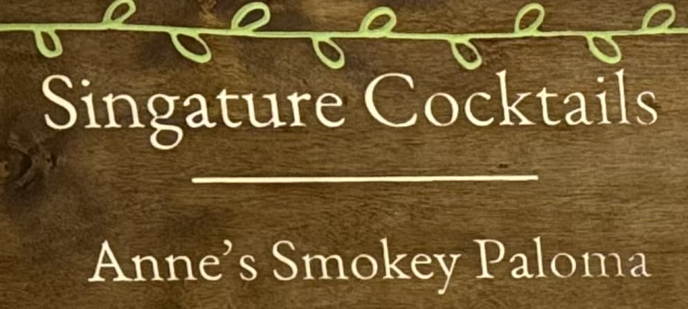

oh, I hate to be that person, but look:
singature, not signature
Sssshhh, everyone will be drunk anyway! :smiley:
Tell them that they have to sing while drinking! :wink:
Karaoke!
Very astute sir, lol. The customer provided their own svg files created on Canva, and this typo slipped through. They were happy anyway. I made 40 signs in 24 hrs, and this was the only misstep.
