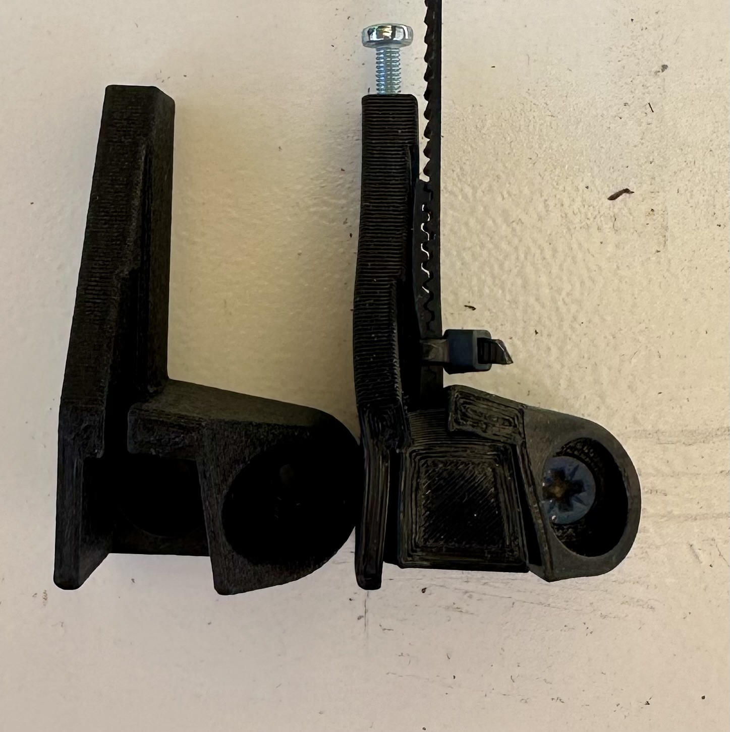

Here you go. One is different, I use that at the end where I solder the wires to the LED and put heat shrink
LR4 Under Beam COB LED Holder.zip (121.4 KB)

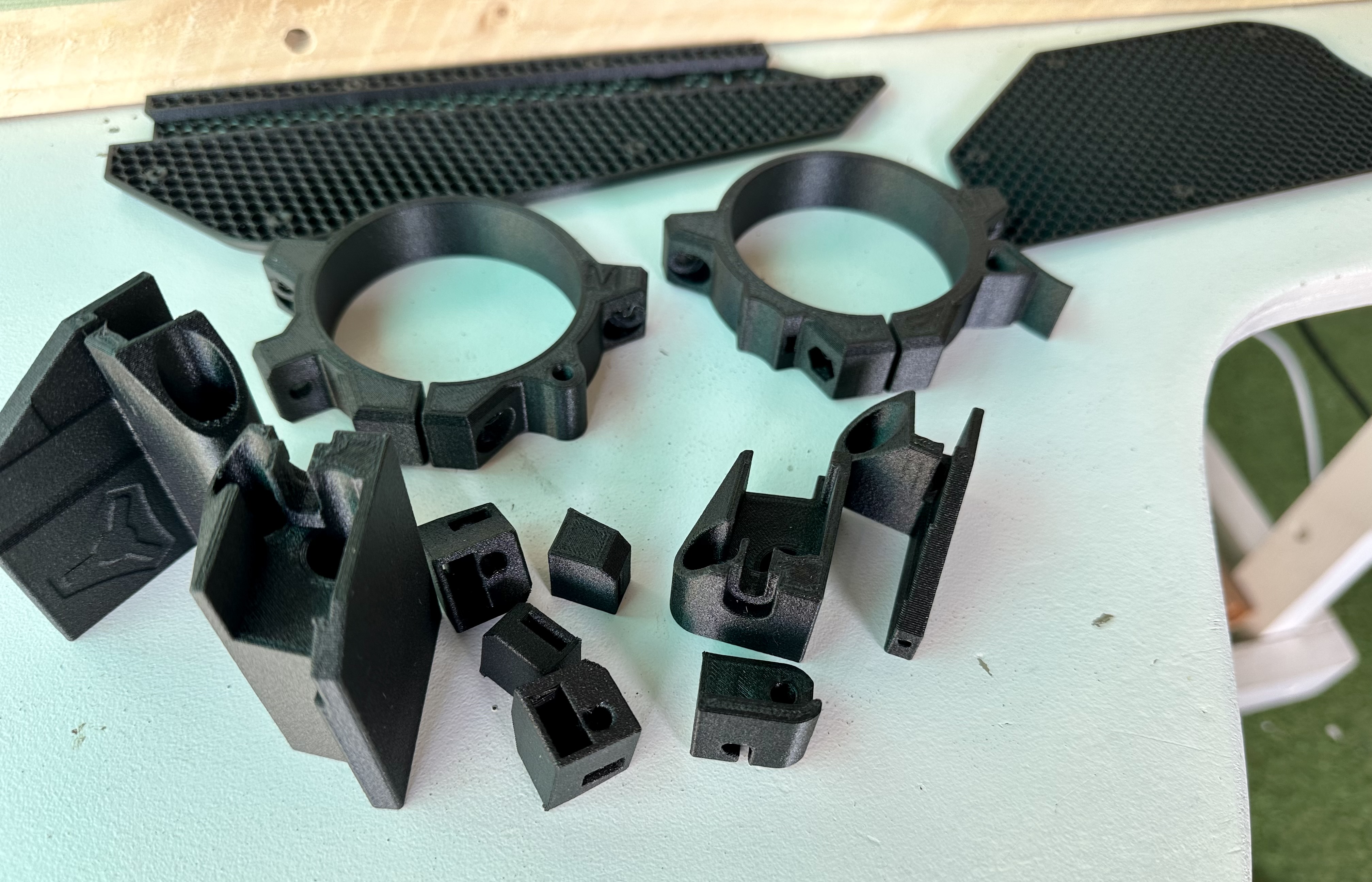

Reprinted some parts on PET-CF as some are deforming under load from the heat, I live in a very warm place.
Hope this time they hold up fine…PLA is fine but direct heat will make it soften and deform so quickly :disappointed:.

PLA is absolutely deformed…pic for prove :crazy_face::man_facepalming:
That starts to happen above 50C, usually the only way that happens in real life is if it is hot…and in direct sunlight.
