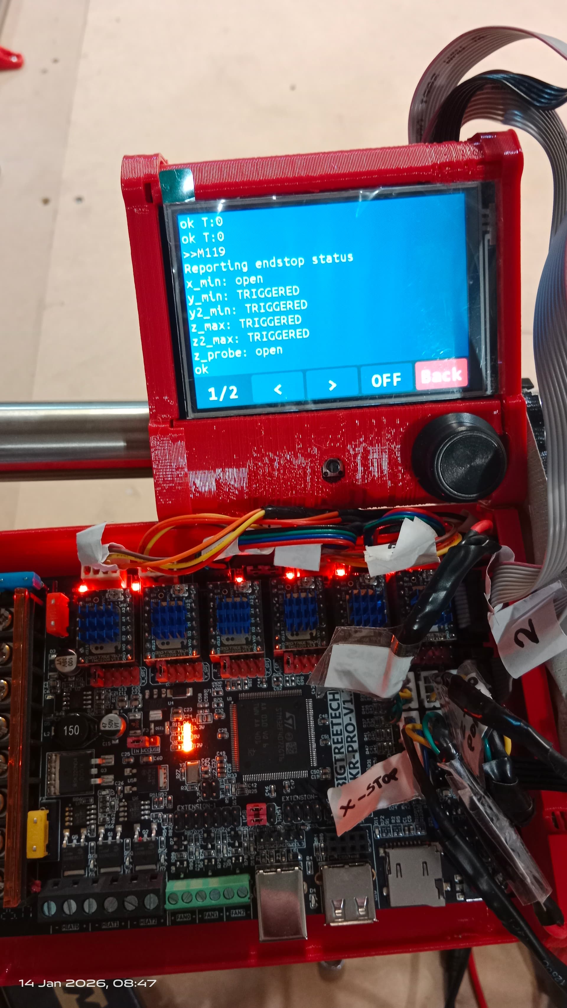

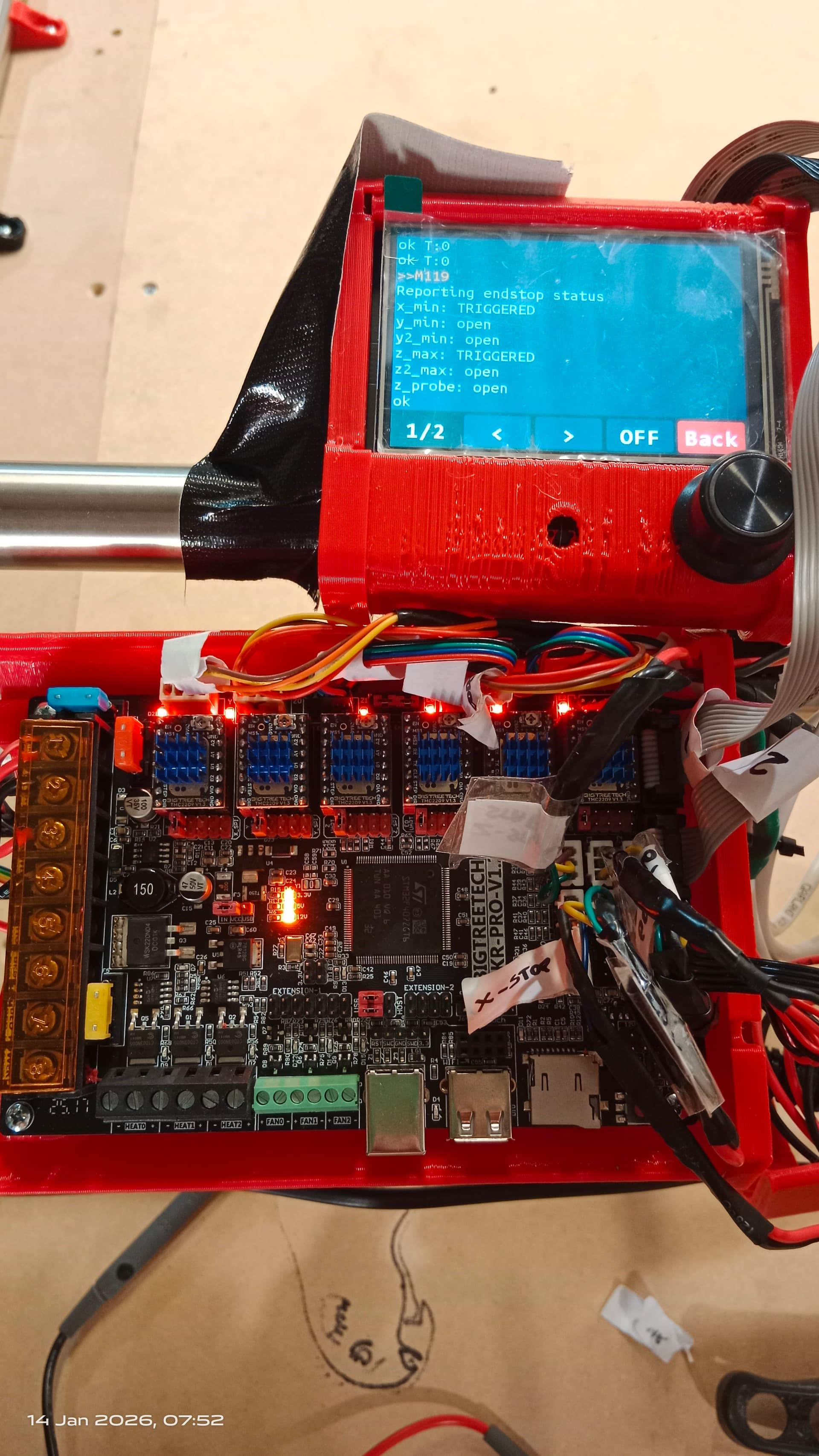

Hi All,
I have been searching the forums and the docs for info on how to get my system running. It’s all assembled and I have basic movement and have done a drawing with cncjs connected by USB.

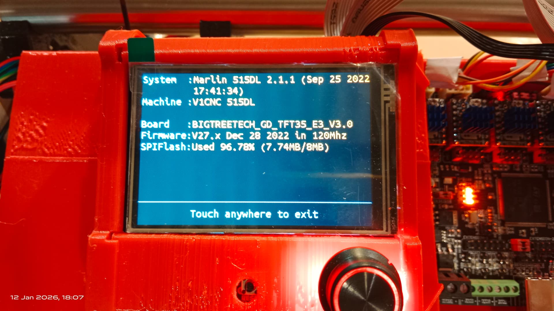

I am using the skr pro v1.2 (idk if it has the wireless) see attached photos for the firmware, 2.1.1 I think. 24volt power supply.
I have the dual end stops/limit switches and a touch plate connected. LED lights on the board light up when I depress the limit switches.
I have only wired the resistor pigtail to x-axis which I thought I wired incorrectly at first and then corrected as I thought I might have damaged the board.
There is definitely weird stuff going on with the end stops as sometimes they show as triggered and other times not when sending M119. Even now the z-probe is saying it’s triggered but it is not in contact. Even after board reset. See photo.
Are the issues I am having related to firmware or the board and the low voltage for the board logic, (i.e. I have to make the 1.5k resistor pigtails for all end stops)?
This is the main issue I am experiencing which means I cannot home the machine.
The other issue which we could address later is z-probe function in cncjs raises the z-axis instead of lowering.
If anyone has any answers on how I can resolve the endstop/homing issues I would really appreciate it. Thanks

This is a good sign

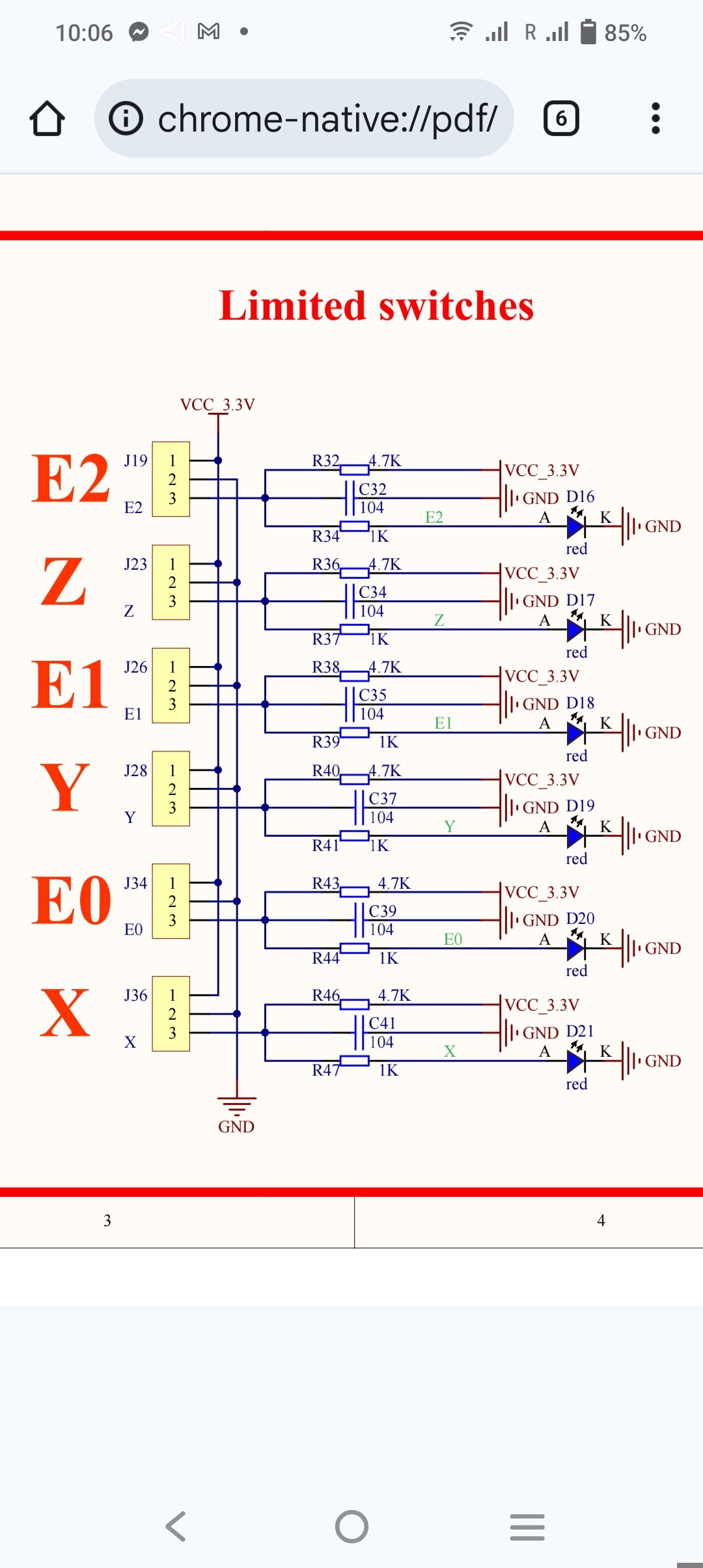

There’s two issues that can cause intermittent end stop problems.
The first you have identified - the infamous SKR Pro v1.2 end stop circuit design, which can usually be corrected by either adding pigtail resistors, or by cutting out the LEDs.
The symptoms are the LEDs will show as triggered when the switches are asserted, but the M119 won’t detect the triggered state. This often results in the motion not stopping when it should, with skipping steps and a grinding noise. If this is happening, it is usually best to add resistors to all 5 end stop circuits, but you may get by with just adding them to the circuits affected.
This issue can be affected by such factors as the length of the circuit (and hence resistance) to the end stop in question. I had a board that worked fine with a shorter gantry, but when I lengthened the gantry and soldered in an extension cable, the issue started happening regularly.
I don’t think that this is your issue.
The second issue is an intermittent open circuit, usually at the connection of an extension cable, but sometimes at the switch itself (especially with spade connectors) or at the Dupont connector on the control board.
The symptoms are very different than the first issue. In this case the switch will sometimes show open (LED Off, M119 Open), and will work properly when asserted (LED On, M119 Triggered). On other occasions, it will show as asserted (LED On, M119 Triggered) even when the switch is not asserted.

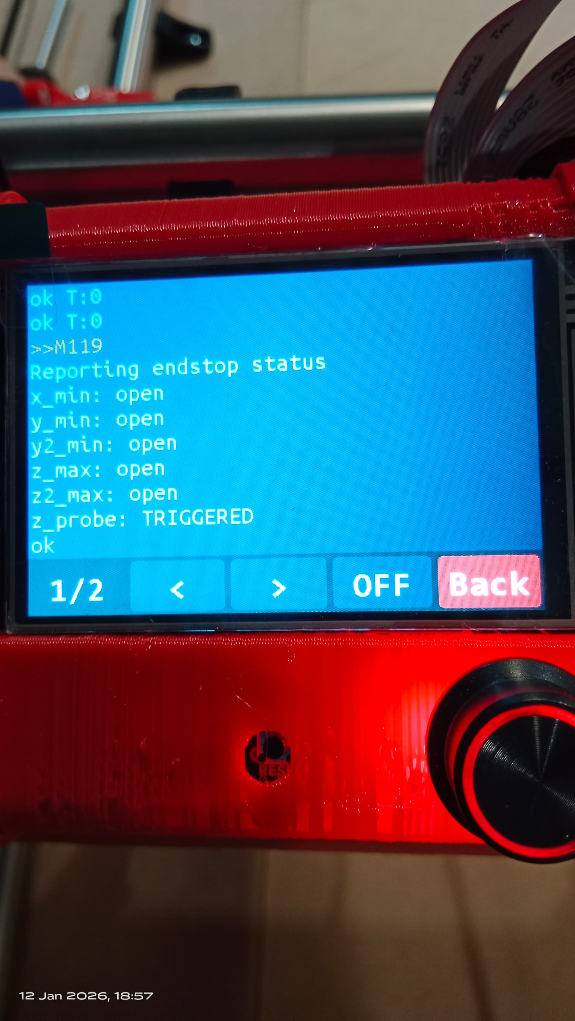

This sounds like possibly the second issue. If an end stop is showing triggered when not asserted, it is usually an open circuit in the wiring. An intermittent open is usually a bad connection somewhere.
That shows all 5 end stop switches (X, Y0, Y1, Z0, Z1) as open (not asserted) and the Z Probe as Triggered. It may be possible that you have the alligator clip contacting the touch plate when you are sending the M119 command. Or it may be possible that your Marlin config is incorrect. The Z probe triggers on Closed, while all the end stops trigger on Open.
Run the M119 command with the alligator clip attached to the probe, and then again when it is not attached. If it shows Triggered when attached, everything is working fine. If it shows triggered when not attached, the config is probably wrong. If it always shows triggered (in both states), then there is something else happening that will require further investigation.
With all 5 endstops showing as open, you should be able to home all three axis. The Z probe is used later for setting the Z height at 0 at the top of your stock.
Not sure what you mean by CNCjs. The photo shows you are using Marlin.

Ok so, on the Y axis I depress/assert both endstops and send M119; only one comes back as triggered, yet both LED’s are illuminated on the board.
And so is there a correct/approved diagram for wiring said pigtails? My first post was in relation to navigating that information in search for diagram that correctly shows the wiring in documentation, rather than a referenced discussion containing both correct and incorrect wiring diagrams, which may or may not be confusing to a new reader like myself.
I’d rather not modify the board for warranty reasons but now having wired the first pigtail incorrectly (potentially damaging the board) that maybe irrelevant.
Thanks again.
Yes, that is the case.
Not if the SKR resistor issue is happening
That is a classic example of the SKR resistor issue

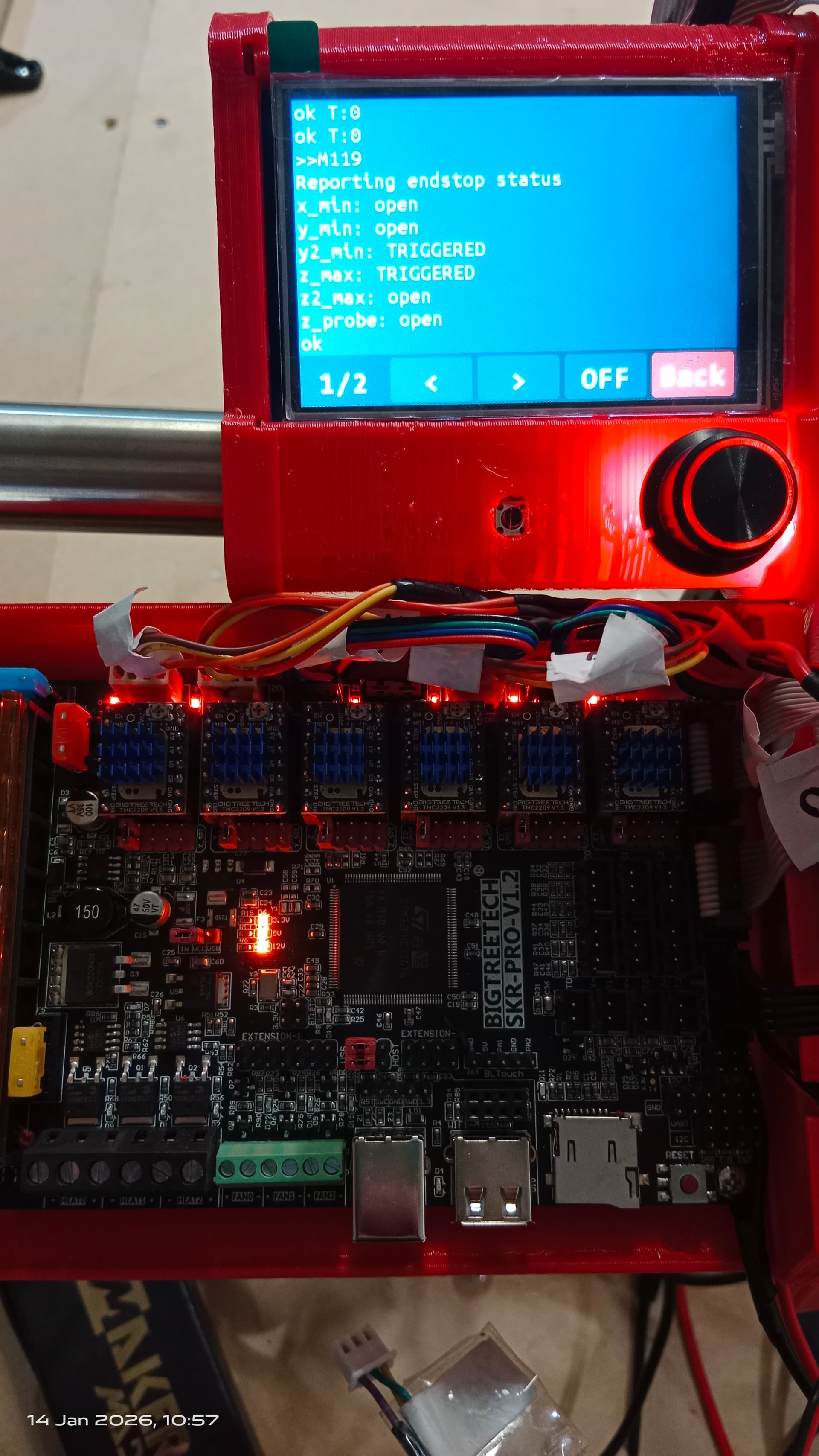

Ok, reporting back after installing 1k5 (1.5k) resistors across 5v (x) AND SIGNAL on all endstops at the board end.
There is something really screwy with the board or firmware. I will try and document all that I did and the results.
All resistors installed across 5v (x) and signal.
Removed z-probe.
Ran out the x-axis to trigger the X limit-switch, LED on the board illuminates. (did NOT run Home program).
Send M119: result = ALL endstops OPEN.
Run Home Z program: results = Left side Z continues to grind after endstop reached, Right side Z reaches endstop and drops suddenly. Ran Emergency Kill function.
Reset board and/or power off/on.
Send M119: results = X endstop=triggered (nothing for either Z-axis endstops)
Jogged Z axis until both were nearly level
Jogged X-axis away from X endstop switch
Ran X Home Program: results= both Z-axes lowers. (??)
Reset power and/or power off/on
Repeat Z Home program: results same as before
Send M119: result Z-probe=triggered all others open.
This is truly bizarre which makes me think it’s something with the firmware or board. Nothing is consistent.

Okay, so after a series of tests involving asserting all switches and trying resets and power off/on, which I won’t bore you with yet, I unplugged all the endstop wires from ALL the limit switches and send M119. All except the X-axis come back as triggered.
The reason why I think X does not is because that is the one I wired the pigtail wrongly in the first instance. I wired it like the paper plate diagram and when I connected the power I thought I heard a pop and the tiniest bit of smoke. But I could have also been hallucinating.
So I re-wired the X to the correct way as you showed in the image above. But it still does not show as triggered. Could it be that the pigtail resistor is fried or the voltage regulator or some other component related to X is fried?
In a previous test this morning it shows as triggered when asserted.
When you hooked power to the signal wire I bet you fried that pin on the board.
Yeah, you connected the 5V terminal directly to ground (through the closed switch contacts)
I’m guessing that you damaged the board. I’m not sure what, if anything, you can do about that. You MIGHT be able to reprogram things to use the Z Probe input as the X end stop, but then you wouldn’t be able to use the Z Probe function.
You might have to replace the controller. I’m a die hard SKR user (one of the last holdouts), but I wonder if a Jackpot board might be a better choice for you. There’s nothing preventing a replacement SKR board from having the same resistor issue (ask me how I know), and given that you want to use a GUI interface rather than the touch screen, the built-in WiFi of the Jackpot might be preferable.
