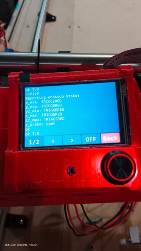

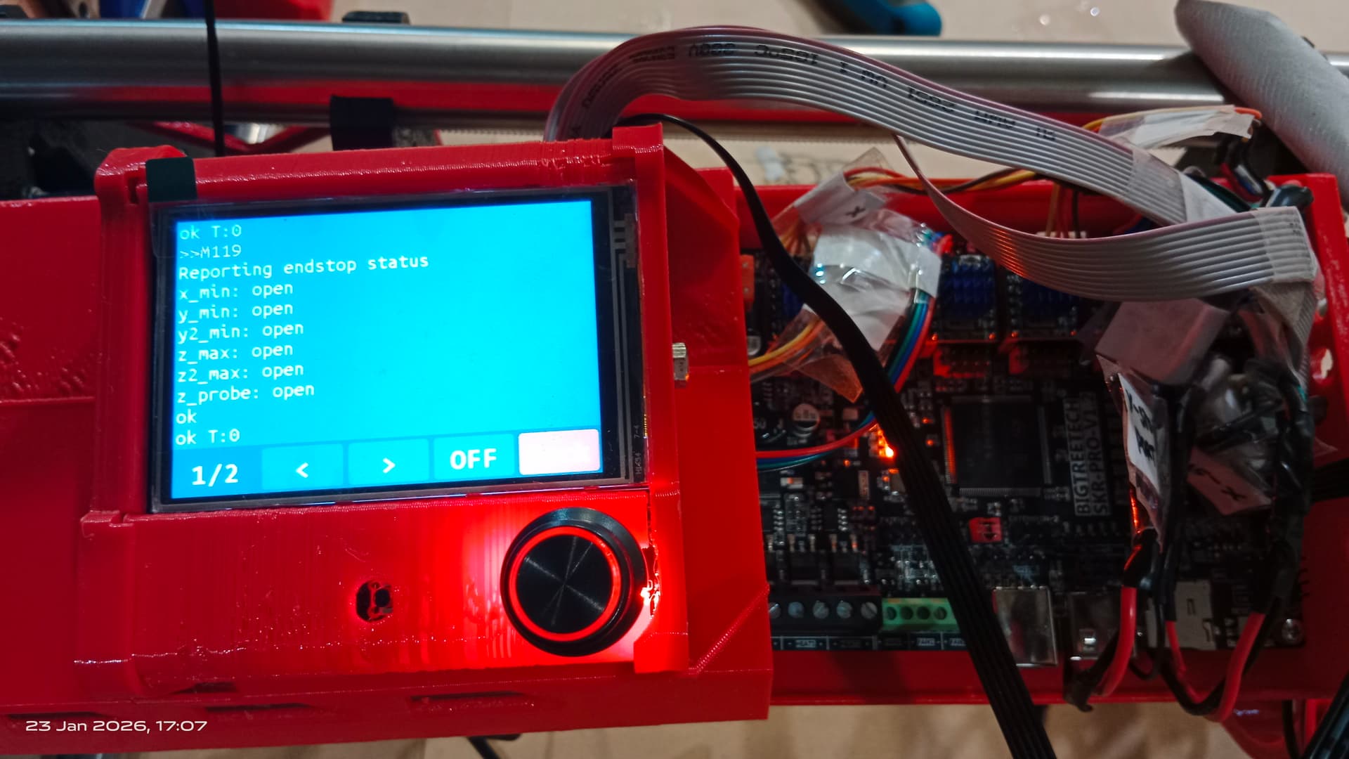

Okay done that and measured voltage across each signal and ground pin with and without the pigtail (without=2.65v, with =3.0v). Each time I have to power cycle to get a correct reading, just a reset button triggers the z-probe. Send M119 Always y2_min and z_max = triggered regardless of which one is plugged in or none. EXCEPT when I have the pigtail on X then the M119 results are ALL open, every one. So there it is, conclusively fried.

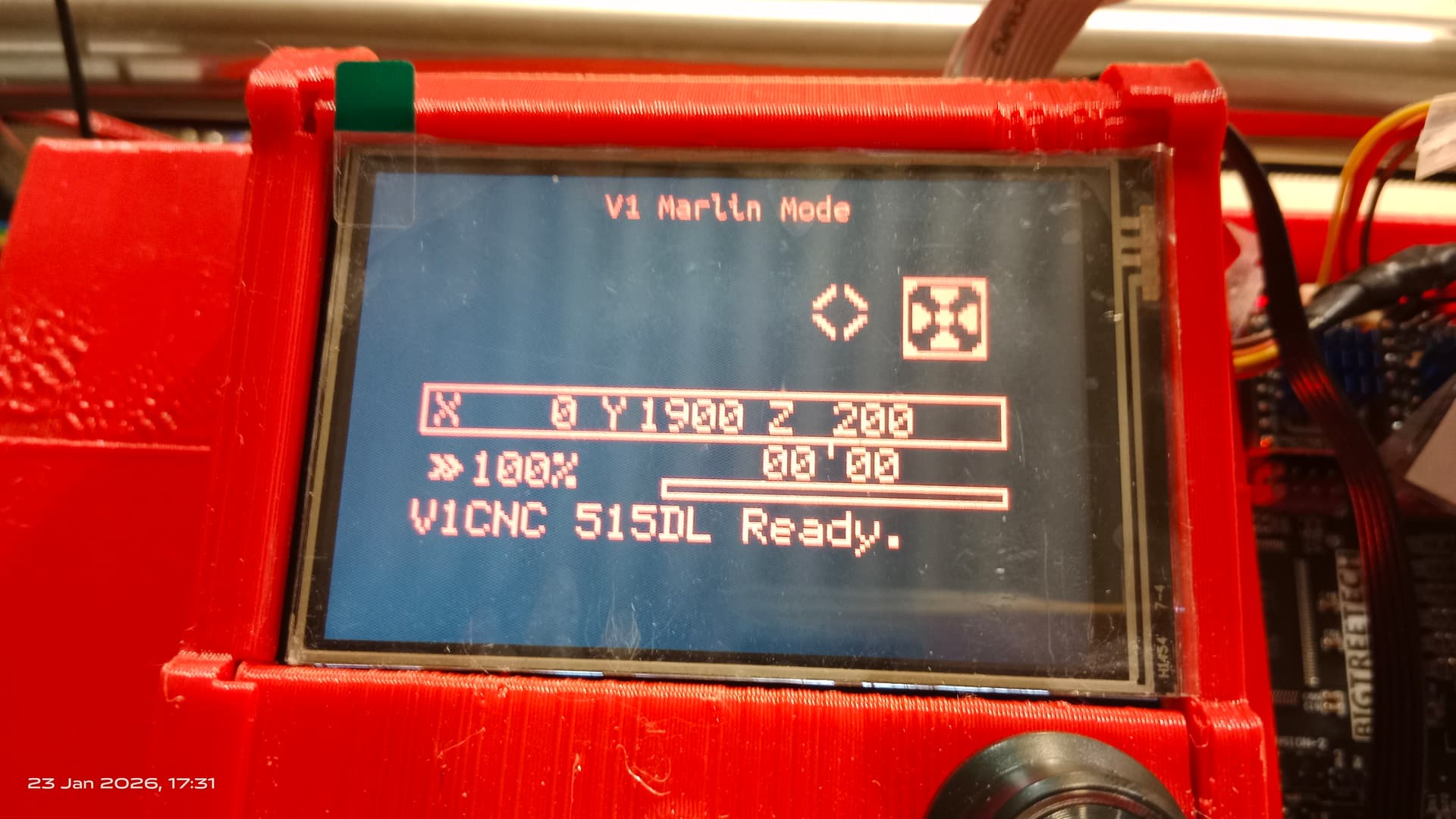

Got my new board all endstops now wired correctly and everything is working as it should. Homing successful.
