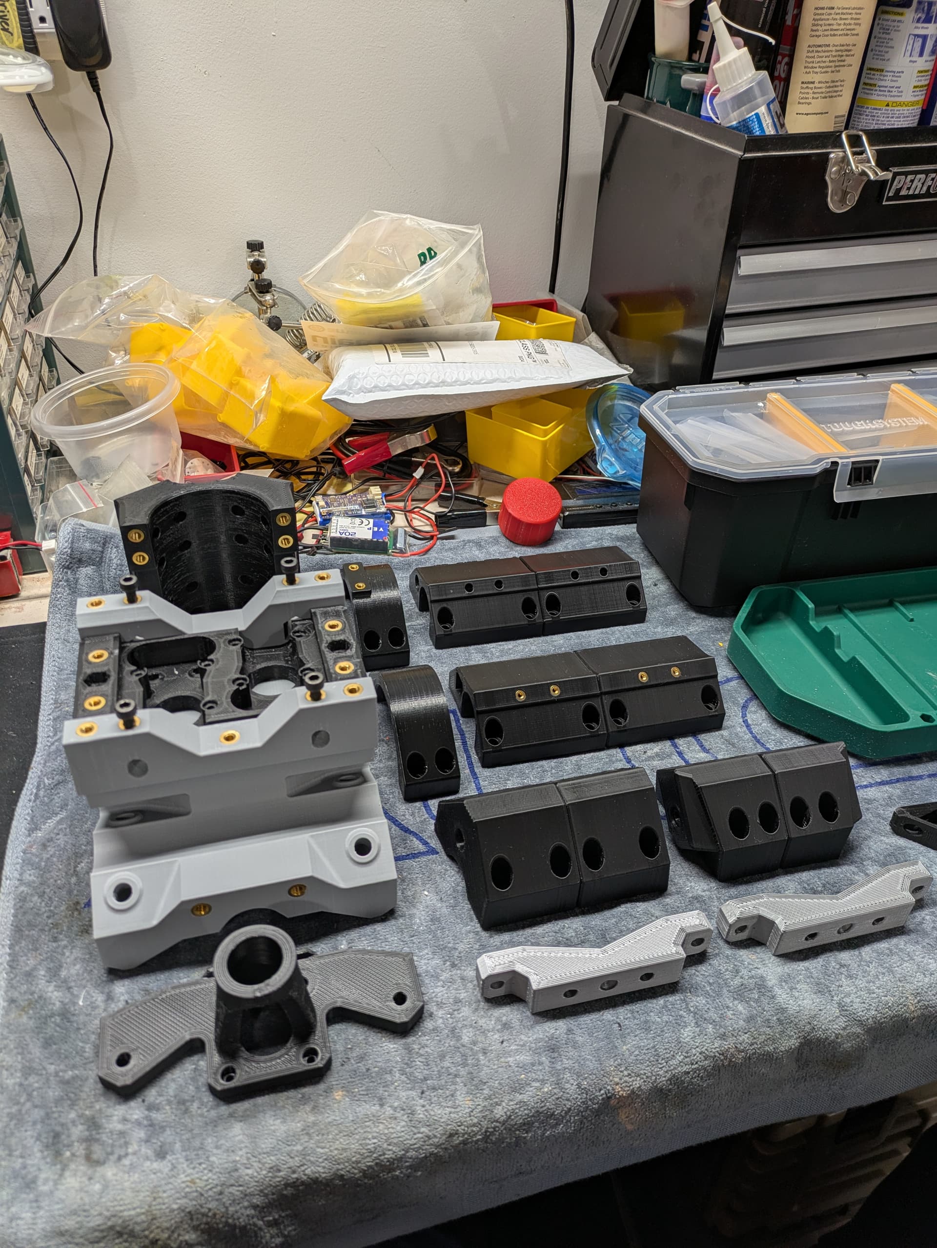

My own take on the spirit of the MPCNC
It’s getting close!
Getting there slowly but surely! Hopefully will have it done this weekend!

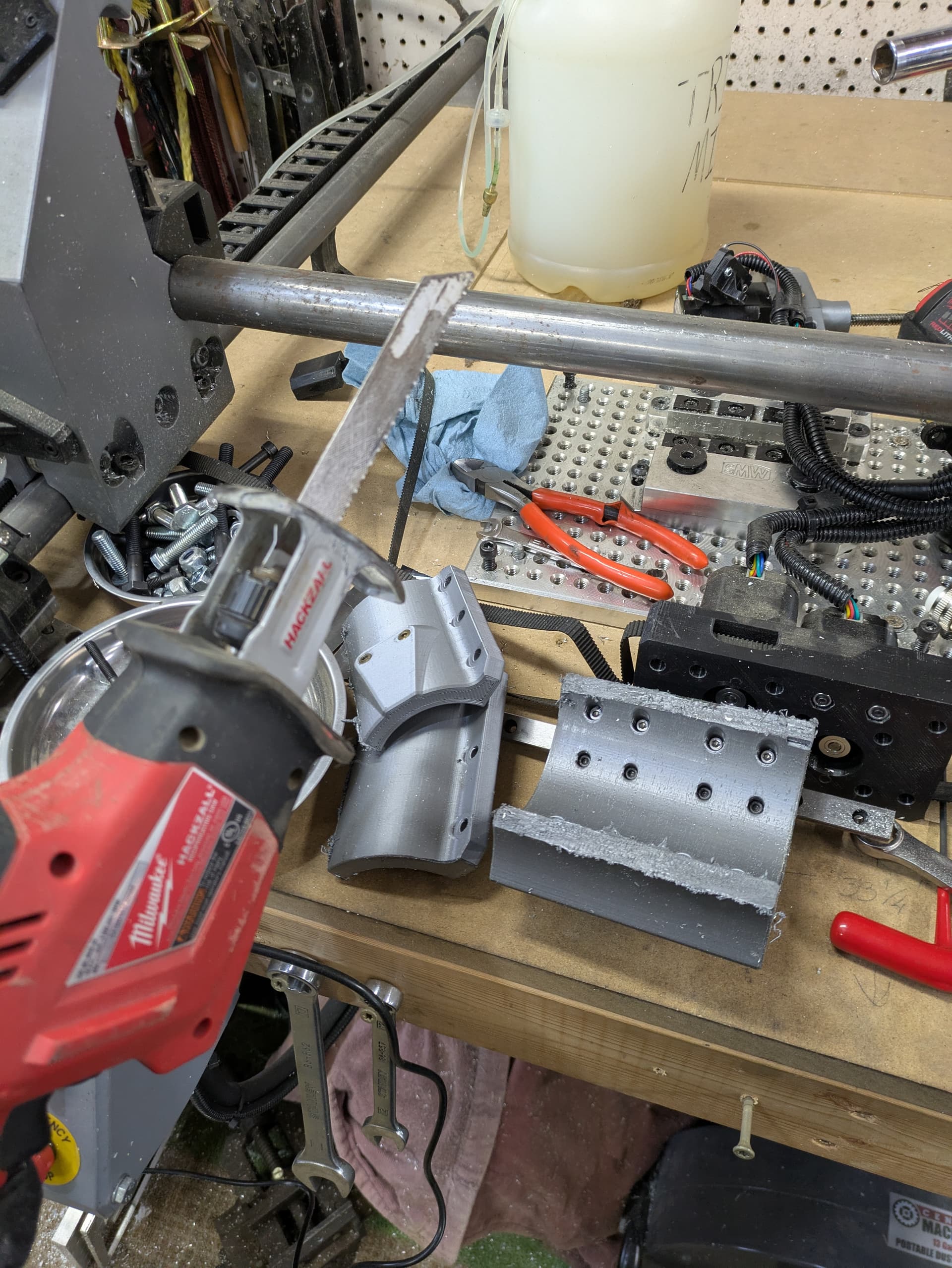

Why am I seeing fresh rail holders? My God man, what have you done!?
Just replacing some that have cracked that are original, figured now would be a good time to swap them lol

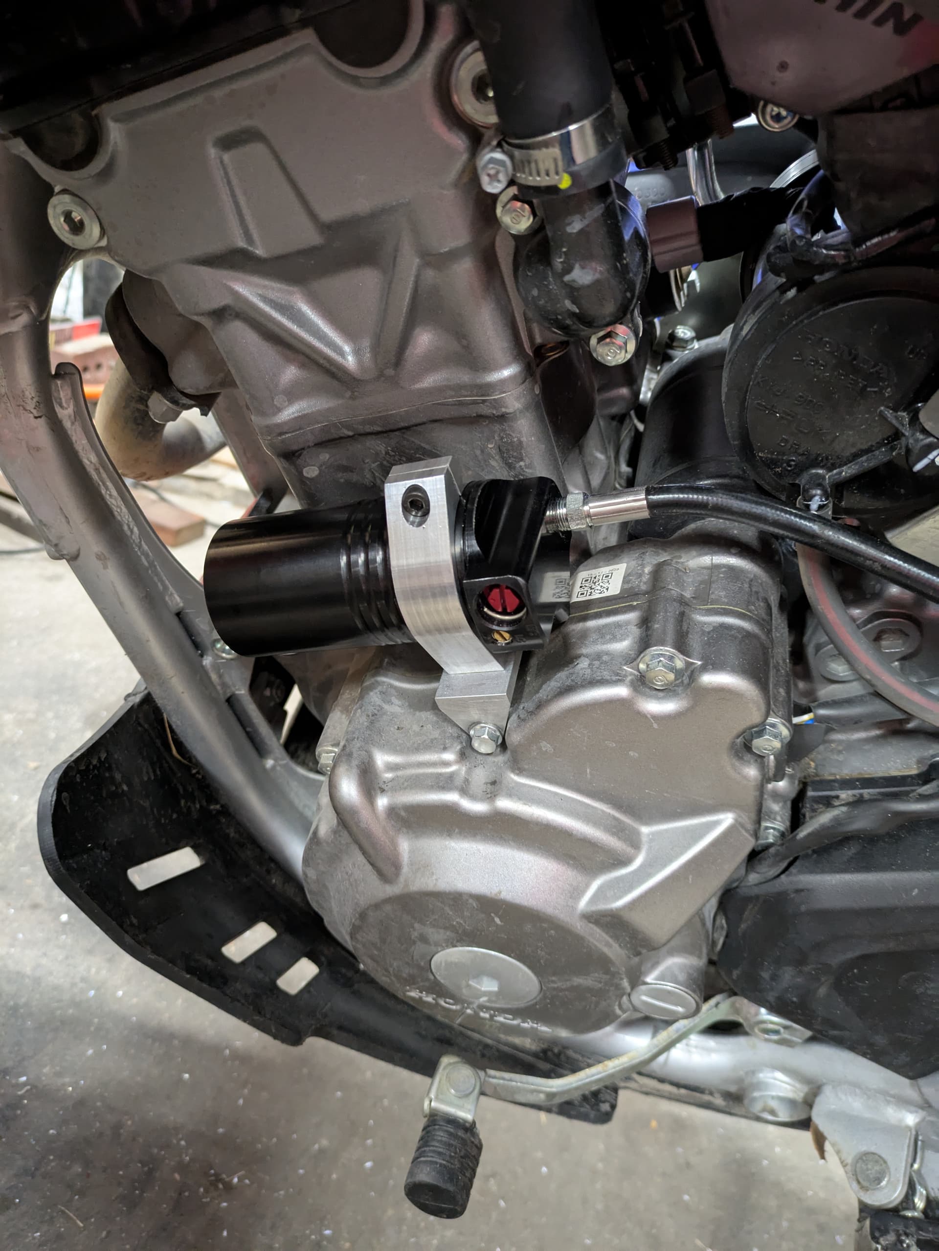

Kicked off my weekend with some progress! Assembly has been quite smooth! May even be able to make some chips fly on a part for my other bike, just in time for riding season :stuck_out_tongue_winking_eye:

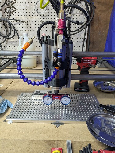

And to show you I too was not happy with how you had to install/remove the screws holding the bearings to the spindle holder

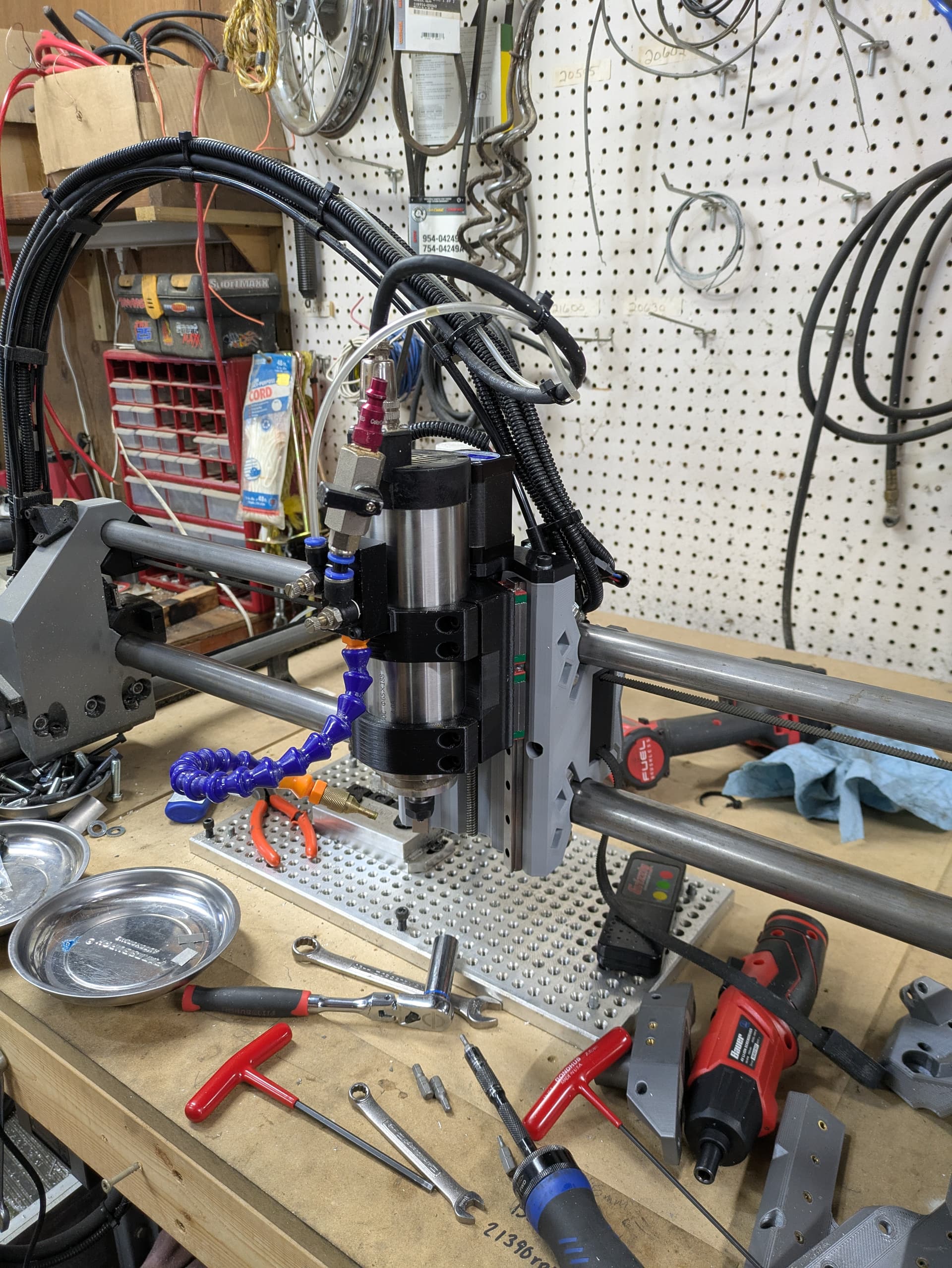

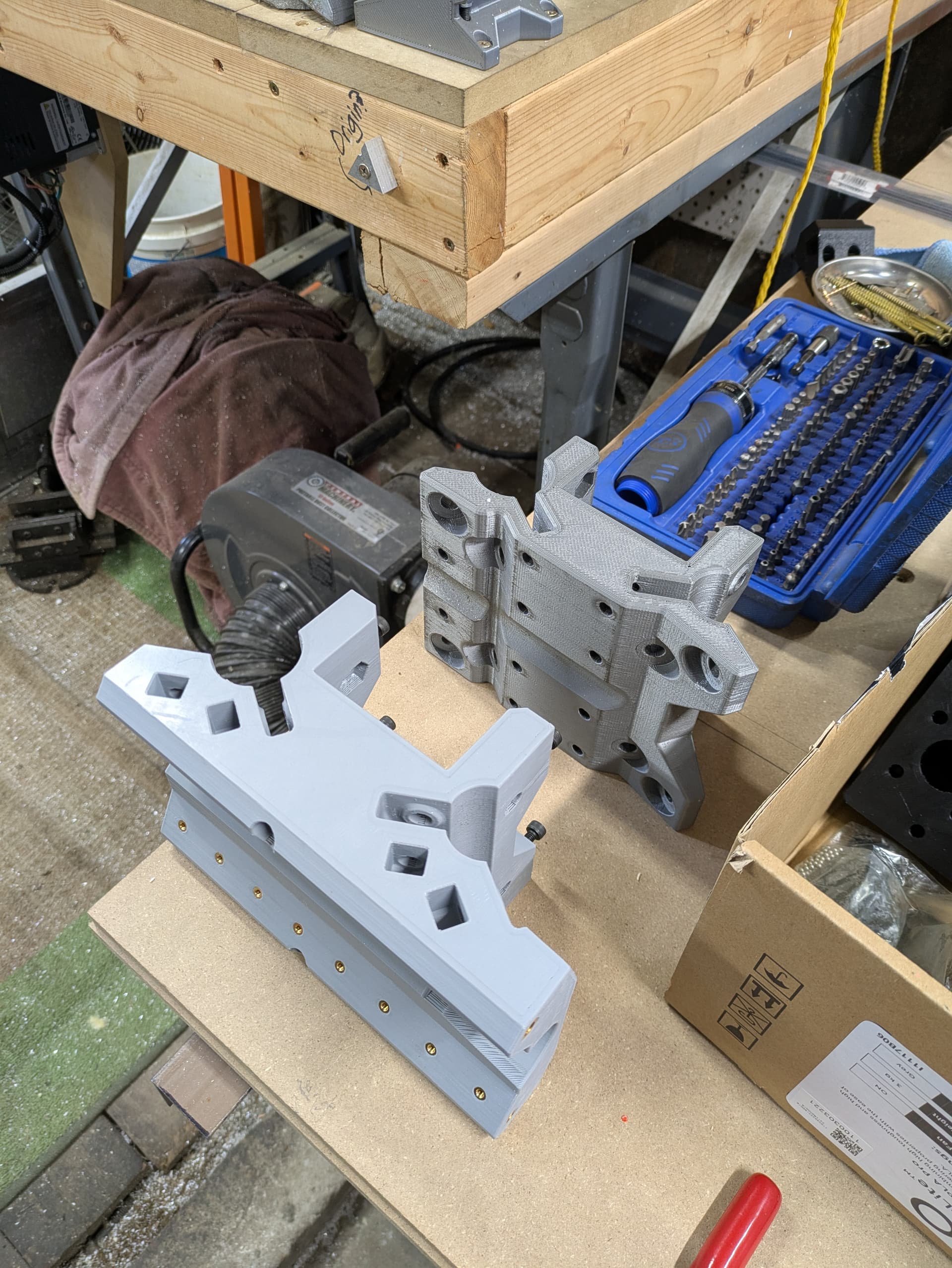

More progress! Got what caps that needed to be replaced replaced, releveled the machine, trammed in the z and x axis, and got the pendant working with it! Just gotta reinstall my fixture plate so I can verify the spindle is true, then I can make some chips!
It is absolutely mint dude. Didn’t know you had kitted it out with a rotary encoder. Can’t wait to get to printing this. What are your thoughts so far? Is it noticeably stiffer?

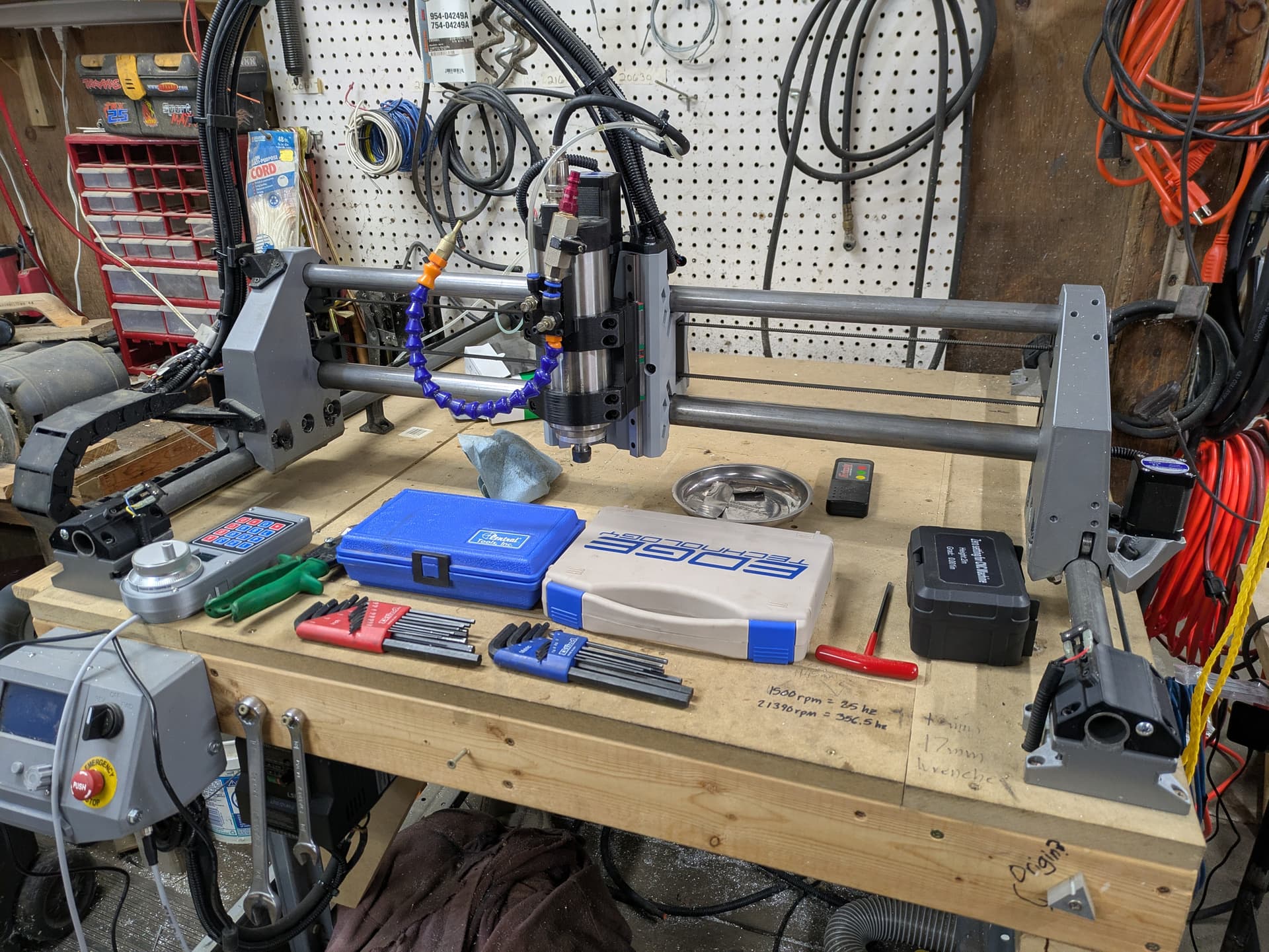

If the v1 Lr4 and Onefinity cnc had a child.
-looks great your machine!
After reefing on it a bit, pretty sure the weakest link for rigidity will be the tubing and belts. The pendant is one Arminth did and I redid the enclosure to hold all the bits nicely in it, just took a while to get it done up and out to the shop to get it connected.
Keeeeeeen to see some chips. What is the main advantage of the new setup do you think?
Hopefully gets rid of or minimizes the chatter I was getting before, otherwise there might be a full 2.0 redesign around using only 1.25" tubing lol

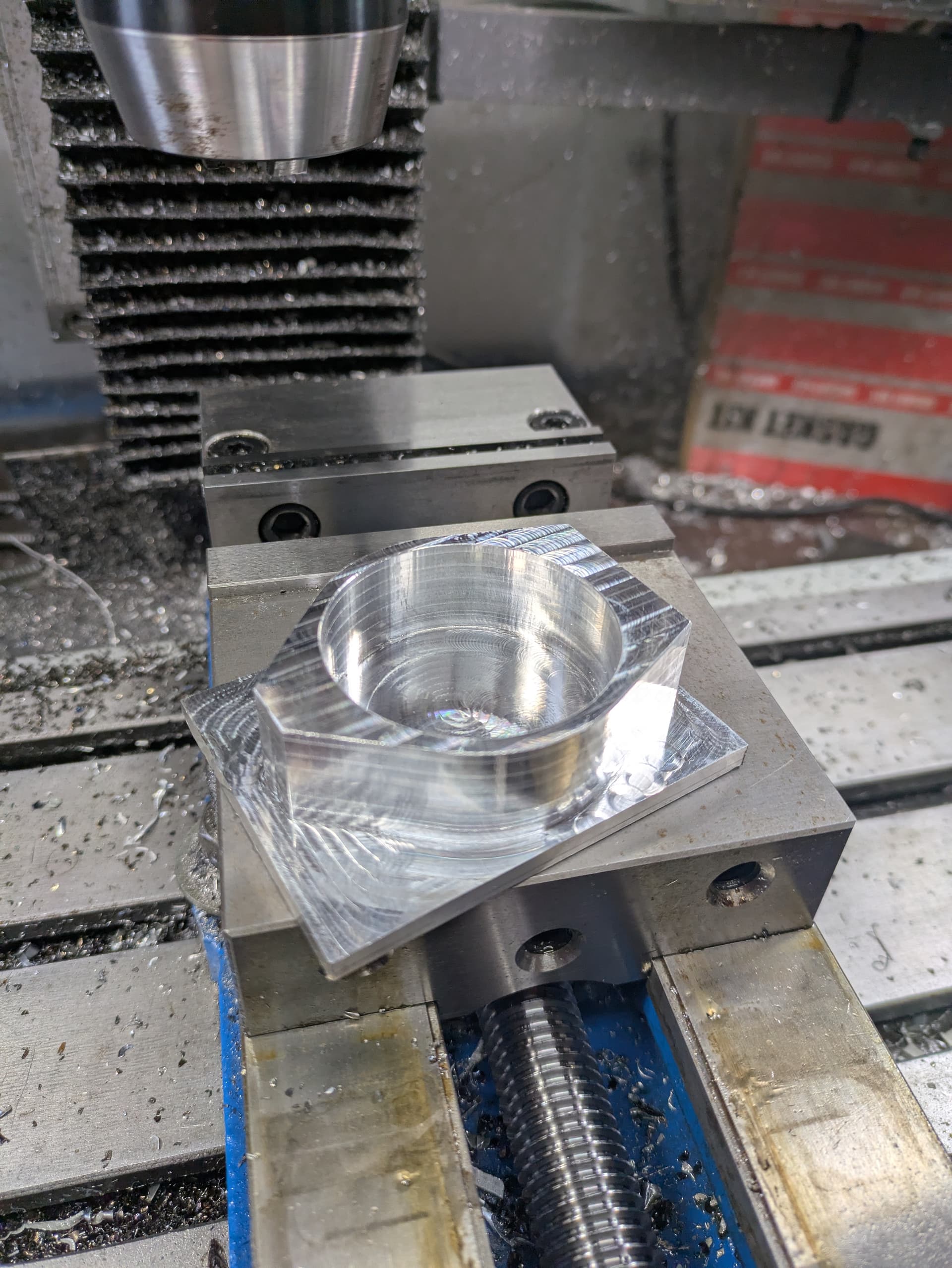

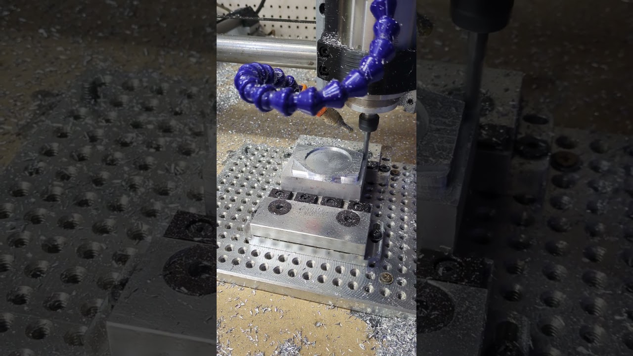

Got the spindle trammed in and made some chips! It didn’t 100% get rid of the vibration when pushing DOC but it did make a notable improvement leaving the top rail and belts as the weak links. Ran my 1/4" 2 flute 3/4" LOC at 60 in/min (~1500 mm/min) with a 3mm DOC and 2mm step over, pretty happy with how it turned out! Took 29 minutes to go from a 1" thick 2.25"x3" chunk of aluminum to a functioning part! Gonna start chipping away at the instructions and BOM update shortly here!
