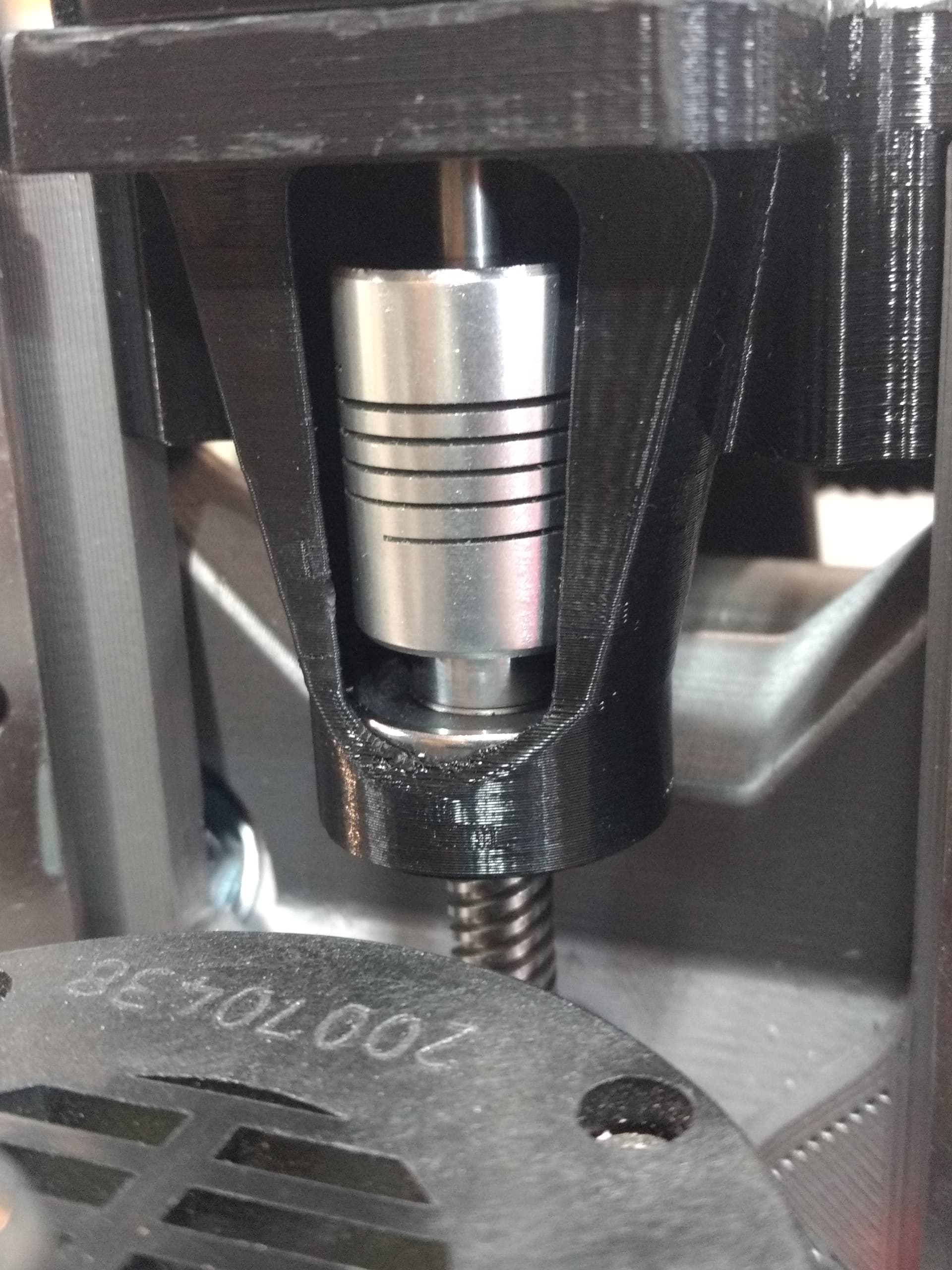

Tool height setter came in today, and of course you have to play with the new tool! Found the backlash to be a little inconsistent between up and down on the Z so I made a short walk over to the lathe and made a spacer to go between the spring coupler and the guide bearing. Backlash is now an even .002" both ways and now I know I will need to account for that .002" for the Z when making parts with a critical depth.

Looks nice, though…
Those types of couplers are horrible for backlash and critical movement.
You should take a look at Spider couplers.

The way it is now setup limits it to basically just what is in the lead screw nut itself, so it is serviceable. Could just machine a solid coupler too lol.
