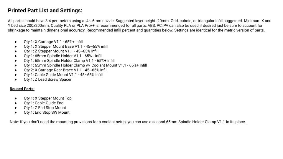

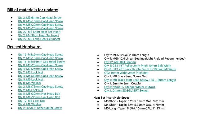

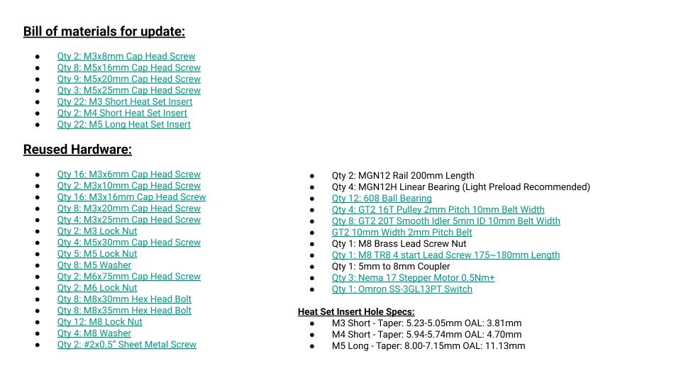

Still working through the manual, but here is the updated hardware and parts lists!
Why did you have to wait until after the long weekend to give me this Easter gift? I could have been working on it all weekend! (But in all seriousness - hell yeah. The manual looks very well put together).

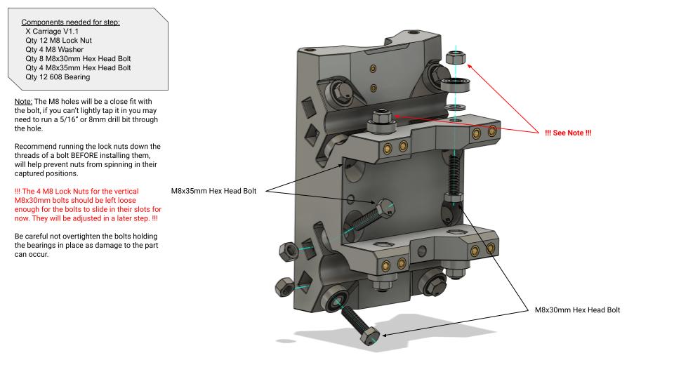

The new manual looks mint. The only thing that jumps out at me is you don’t have a step regarding belt installation in the X steppers. Whilst I think it is fairly apparent how they run - perhaps for new players it wouldn’t hurt to add a picture?
I am genuinely impressed by your forethought in adding the “Notes on Disassembly” as my first question was going to be “Can I replace the center gantry in situ?”.

Page 16 has the belt info, was one of the copied slides from the full instructions
