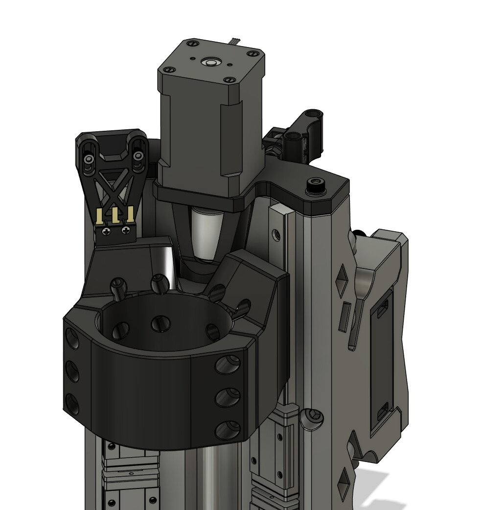

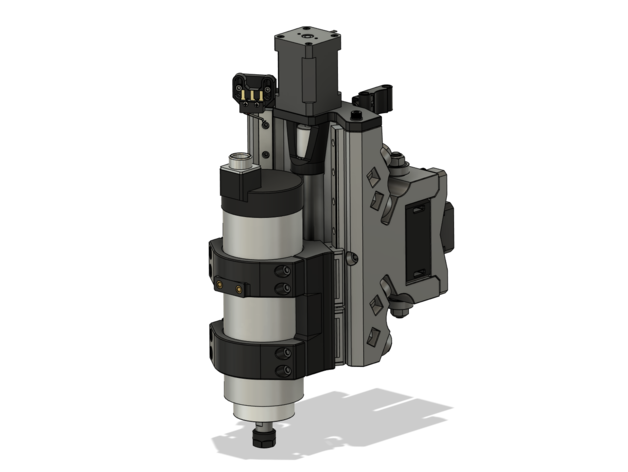

Makita mount is updated! Now to fix the Z limit switch position to actually work with the mount.
It’s coming along now man!

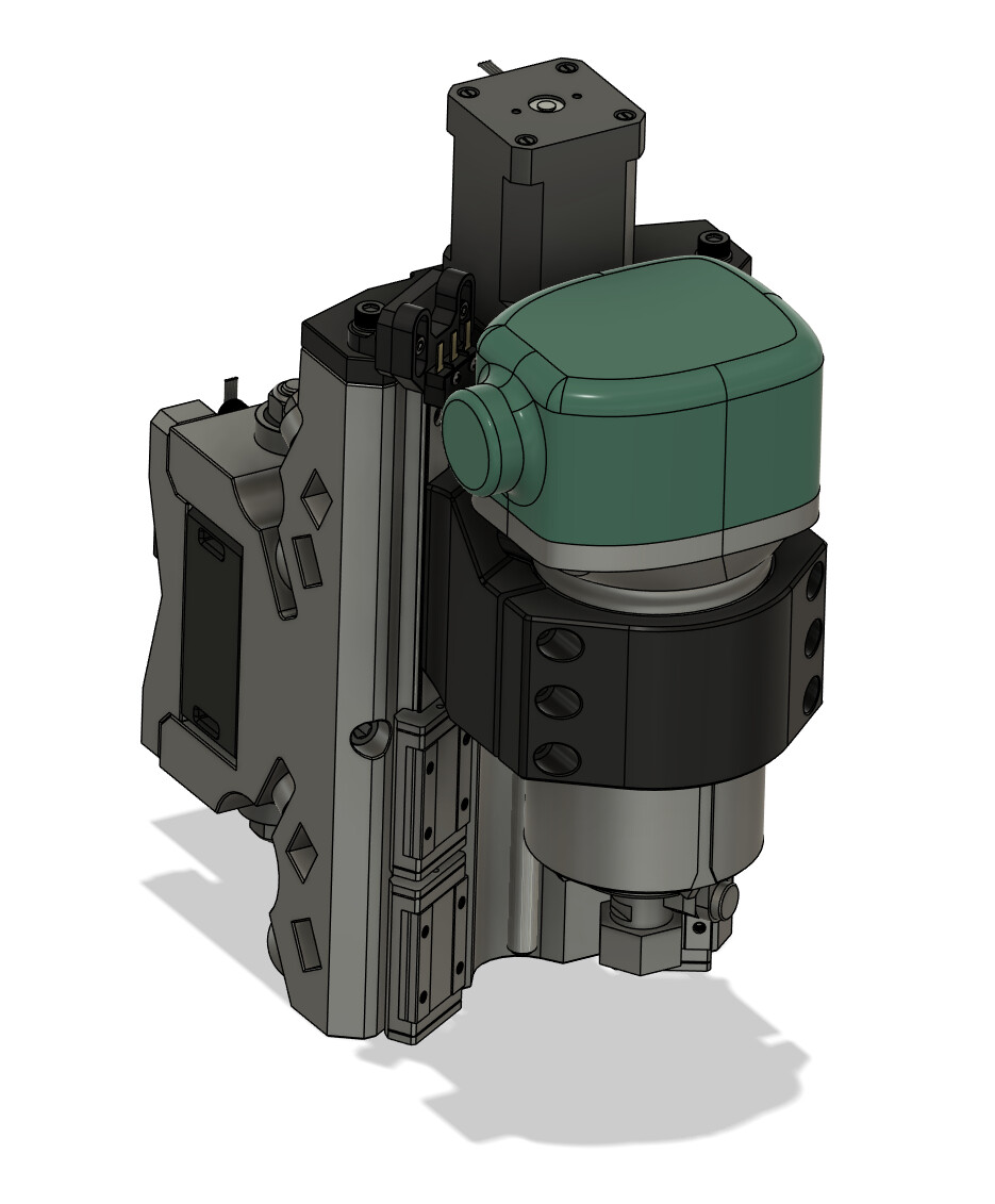

Now to update the Dewalt mount and add a little info in the instructions for the Makita/Dewalt mounts! I did have to alter the End Stop Mount slightly so that is now new as well (needed for Dewalt/Makita setups, optional for 65mm spindles).
Alright Keiz you can breathe now, files are now live!
Can’t believe I missed this by 10 hours - you know what I could have been doing for the last 10 hours! Printing this! I will never forgive myself. I am very impressed with the new design man, absolutely epic.

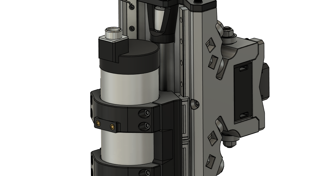

Alex, I’m working on this today and I’m not seeing where the 4mm short heat set inserts (x2) go. Is it right in front of me and I can’t see it? :grin:
They go in to the 65mm spindle holder clamp with coolant mount, some how I missed the steps of installing those inserts and installing the spindle XD

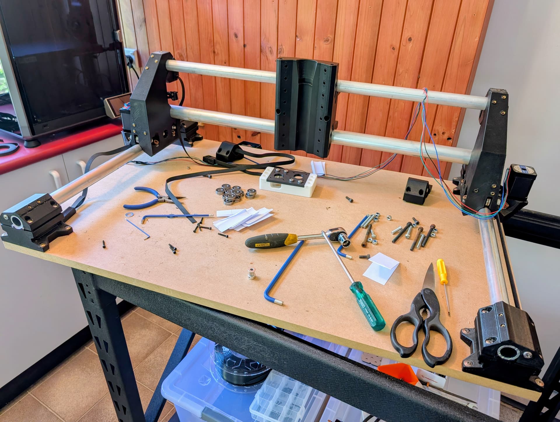

So I have embarked on a 2nd Brutus with the revised core.
For reasons that are inexplicable to me I am getting a fair degree of binding on the left-hand upright, once I have installed the belt.
Things I have eliminated: table and frame are square (gantry does not bind when belt is loose/not installed). Replaced the stepper and geared pully, used a small degree of paper to shim the relevant Y rail (which seemed to relax the binding somewhat but more/thicker shims reintroduced binding), the screws that carry the idler pulleys are loose and the idler pulleys move freely. I have checked all the bearings/bolts on the upright but as I say when the belt is not installed the thing can be moved with as stiff breeze.
The literal only thing I have left to check to is whether one of the idler pulley bearings has shit the bed?
The right hand gantry is installed with a tensioned belt and glides like it’s on ice…
Please tell me there is something obvious that I am missing!?
I mean the belt path is fairly straight forward and really does not interact with much at all other than the 2 idler pulleys and the geared pulley on the stepper.
I am at my wits end.
This isn’t a machine we deal with regularly.
Does the stepper motor on that side spin easily by hand when the belt is off? Do you per chance have the harness plugged into a controller and you’re getting a resistance during motion due to back EMF?
Check all the idler pullies to be sure they’re not binding.
Are the wires on that stepper motor stripped back and touching each other at the ends?
They are?
