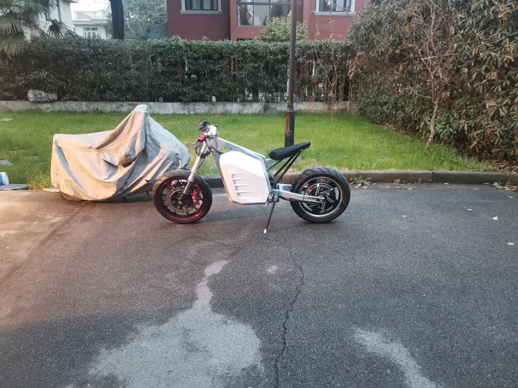

Still a lot of printing for my motorbike project: this should be the final design for my battery covers.
I printed the first one yesterday for the left side, and the right side is being printed right now.
It took almost exactly one kilo of PLA for the first one, the second one will take the same amount. I printed on a finer resolution than usual (0.3mm per layer), but still, the printer managed to do it in around 20 hours.
So, yeah, an entire spool in 20 hours, that’s pretty impressive. Told you guys, this thing is hungry!
I installed a little Xiaomi camera, which is really useful for me because I can monitor the print from anywhere using my smartphone. It can move at 360 degree and has a very nice night mode that can capture really good quality video even in complete dark. Super useful for checking form time to time how things are going during the night.
Anyway, the print turned out just fine, and seems to fit very well on the bike:
I hope the second cover will print well too, hopefully it should be done when I’ll be back at home tonight.
Then will come the biggest print: the actual mold to make these things out of cabon fiber!
Estimated print time is about 50 hours and more than 3 kilos of plastic, but the mold design isn’t finished yet so I hope I can optimize a little. It will be gigantic, tha’ts for sure.

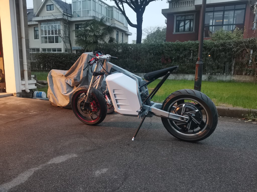

Anyway, the second cover got printed, also in 20 hours and one full spool:
After removing the supports and installed it on the bike:
It printed very well, even better than the first one… except for the first layer: for some weird reason I cannot explain, the first layer is not well bonded with the second one, meaning I was able to peel it off almost entirely.
That’s the first time I see that.
I glued it back on using spray glue so no big deal, but it puzzles me.
