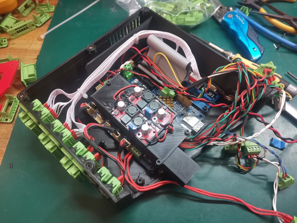

Printed a slightly larger version of the enclosure to accomodate the new hardware:
Now I need to start educating myself on the firmware part…
Ok well the firmware part was very easy, I just had to change the motor port and job done. Took litterally 5 seconds, I was expecting to spend hours on it so that was a pleasant surprise.
I then had to rebuild my whole wiring, which took a few hours. I went for paralleling the motors wires together instead of dual endstop. My printer prints relatively square, so I thought I’d keep the 3 remaining stepstick slots for a triple Z axis using these servo if it turns out to work well on X and Y.
I started by wiring only one motor per axis just to see if it would work and get a feel for the power and speed. And oh boy, I was not disapointed. Here is a short video of a few quick moves. Remember it is just using one motor per axis and my whole print head system weights a ton (more than 8 kilos in total).
There’s just one thing that isn’t great, at least in my particular application, which is that it was difficult to find the correct step rate and top speed. Usually when you tune a stepper motor, you know that you’ve gone too far because it starts skipping steps and you can hear it, it’s fairly obvious. Here, if you go too crazy the motor will try to follow, but I guess the motor controller was too busy to record all the steps that were commanded by the motherboard and instead of moving 100mm for example, it will only move 80 or 95. What’s very confusing is that the error seem consistent and repeatable, it will move the same amount in both direction, so you get the same error all the time.
I had a hard time understanding that, at first so I thought these motors were defective or at least wildly inaccurate, but it turns out I was just feeding them with too high of a step rate that they could cope with.
So what I did was to lower the microstepping to 8 instead of 32, which is done in a few seconds through the motor little screen, and then I was able to get those really high speeds while keeping it precise.
Also, for some reason I don’t understand, I had to change my steps per mm fro 100 to 64. No idea why.
Anyway, the holding torque is just miles ahead my previous steppers, you can’t feel it through the video obviously, but I’m actually pushing pretty hard and this is only with one motor set up at only 2/3rd of its maximum power. It feels so weird to see the head coming back to its position, seems like magic!
At this point I was feeling confident enough, so I decided to go ahead and just do the same for the two other motors, took another hour to rebuild the wiring and then I was able to test.
First test didn’t work, because I forgot to calibrate one motor. I wasn’t sure calibration was necessary but turns out it is, so tha’ts good to know.
After that it all worked well. There is tons of torque and this is about the maximum top speed I can reach safely at this microstepping. That’s very, very powerful. You can see the direction changes and top speeds are pretty impressive:
So now I’ll have to prepare the printer for actual test printings, hopefully this evening if everything goes well.
If tthese motors have the same accuracy as the previous steppers I was using it would be perfect, so I really hope it’s going to work, so far I find these things amazing.
