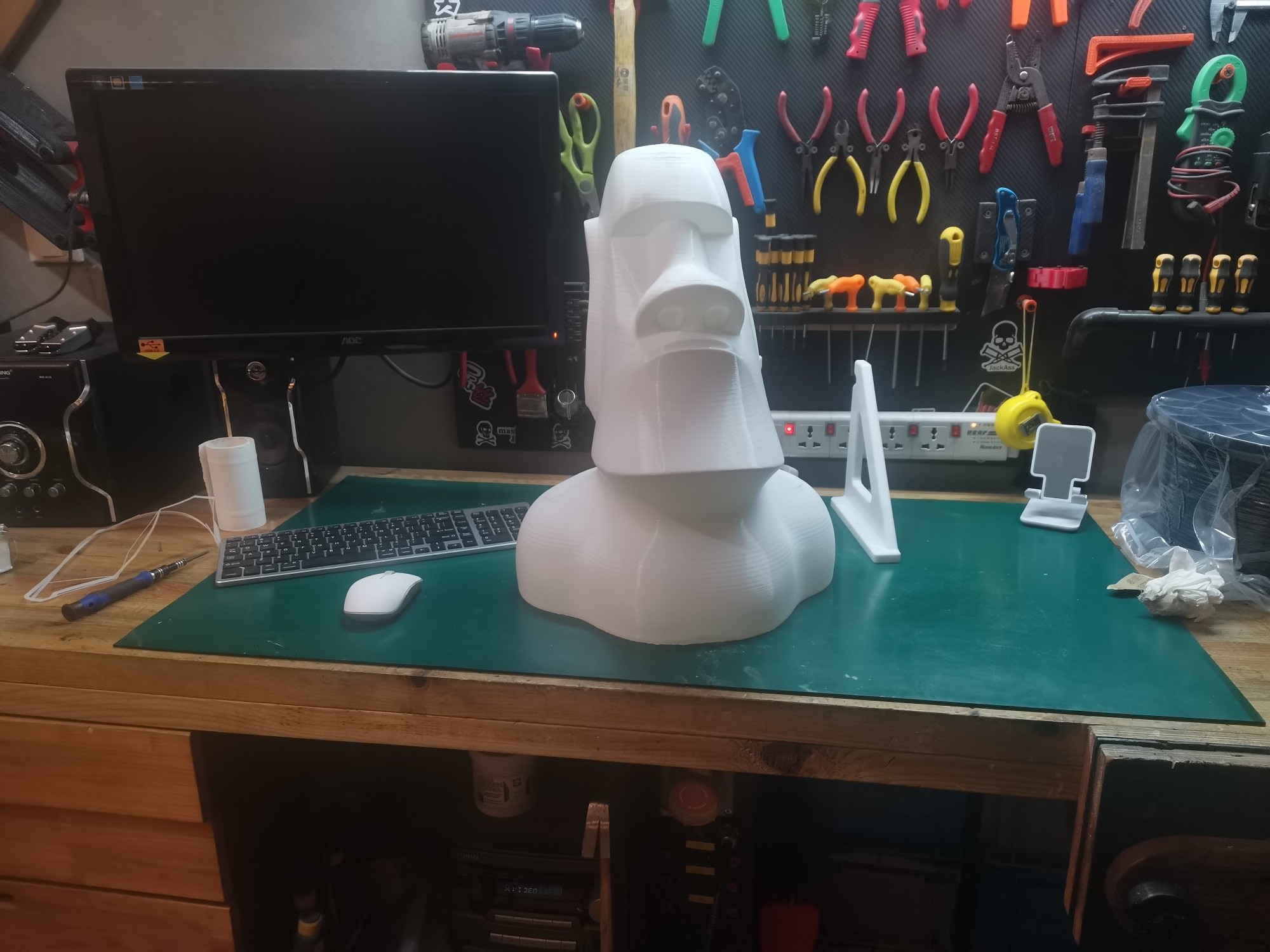

So I tried again the Moai head, and this time it was a success.
I still used the same brittle filament, but this time I fed it differently to the print head.
Since my spool system can be attached anywhere on the printer, I just clipped the spool holder to the top. And since my filament sensor is still using the USB wire system, I just had to switch to a longer cable! So all in all, it took me 3 minutes to solve the problem, thanks USB!
The print measures just under 450mm height, it is completely hollow and made of just two perimeters. retrospectively this was a mistake, I should have gone for at least 3 perimeters since I did not work very well on some overhangs (the top of the head and the top of the nose). Or maybe start with printing the ouside perimeter before he inside one. Well, live and learn.
It took around 10 hours, I slowed he printer down a bit to make sure here would be no issue during he night.

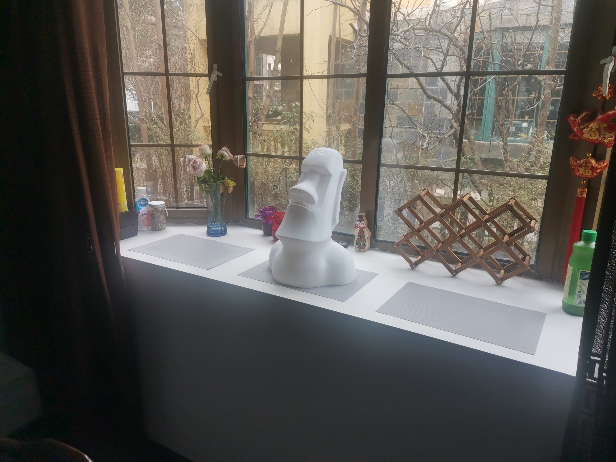

When I woke up this morning it looked like this:
And about 50 minutes later, it was completed!
I think it looks great from a one or two meters distance, I consider it as a nice success.
Only thing I’m not entirely satisfied of is a bit of Z layer wobbling. Nothing really problematic but it could be improved. I think it might come from the ball screws, one of them is actually not very straight and tends to wobble around (can’t be too picky for the price I got them I guess)
