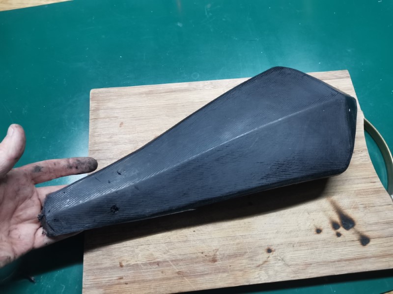

Well guys, great success!
I’m totally satisfied with this first attempt, it went much better than what I was hoping for!

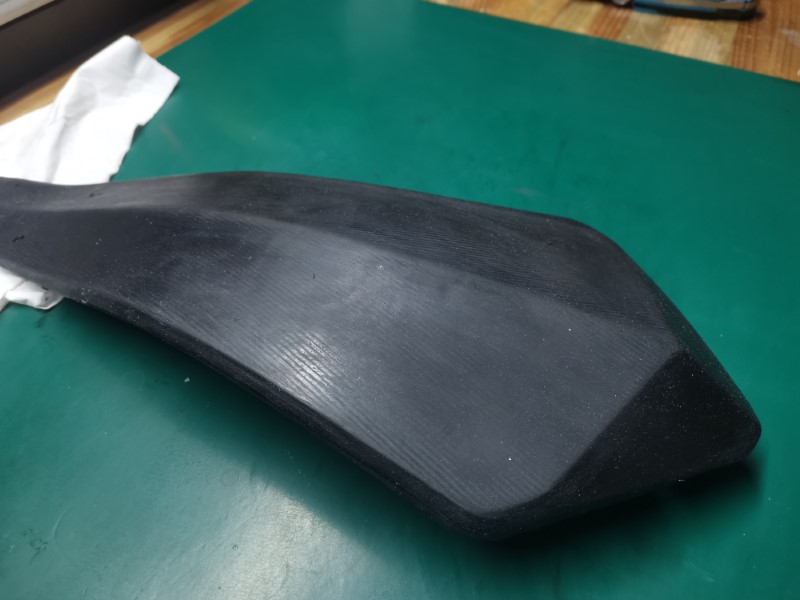

Only screw up was that I didn’t make a good job at mixing, so some spots didn’t fully cure and also the black pigment leaves some dirty marks all over the place. But that’ll be super easy to fix next time. The silicone is very, very soft, maybe a bit too much, I’ll see when I’ll try sitting on it (I’m printing the bottom shell of the saddle so I guess I’ll be able to try tomorrow if the print goes well).
Aside from this, it was perfect, it was not difficult at all to take it out of the mold, and all the features are there. So I guess I’ll use this technique more often, it works wonders!
Wrapping it in leather/vinyl will affect how squishy it is too. It’ll constrain the material and keep it from moving a bit.

Very impressive. Did you use anything on the PLA to keep the silicone from sticking? Like mold release spray?

I didn’t use anything for mold release, silicone supposedly only sticks to itself, so I thought I didn’t need it.
There are some varying stiffnesses existing, I went for the second softest one (apparently the softest one would be too sticky for my application according to the shop I bought it from, and I think he was right, this one is actually quite sticky so I can’t imagine how the other one would be). I’ll probably try other stiffnesses if this one doesn’t do the job.

You could fill some of the holes with more silicone later to stiffen it up a bit too.
