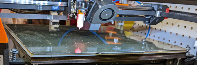

The magnetic build surface has a plastic protective cover film and it is not likely a printable layer surface. I think the first few surface calibration tests will likely destroy a PEI textured sticker if I had one for it… Should there be a pei sticker over it? What surface do you all print on? If it doesn’t really matter, perhaps some blue tape and glue stick for the first print just to test the nozzle height and start laying plastic.
Can you post a picture on the plastic protective film?
I used to print on glass, then glass with 3m blue painters tape, then textured PEI sheet. All 3 ways gives good results.
I think that answers the question (it shouldn’t be the bare metal). The plastic protective film is a clear cover sheet like the film you get on a touch screen when it is new. You can kind of see the film here… it is dirty on this shot:
I’ll need to get a better picture.
I went back and looked at my order… apparently I ordered this:
https://www.amazon.com/gp/product/B09F6Q4CYM
and it is one sided smooth PEI with a protective film, so I should be able to print right to the PEI sheet without the top protective layer with nothing else like tape or glue.
You do need to take that film off.
The product information states specifically to take that off before printing to it. It is sure easier to ask questions on the forum than to stop and actually read the documentation.
