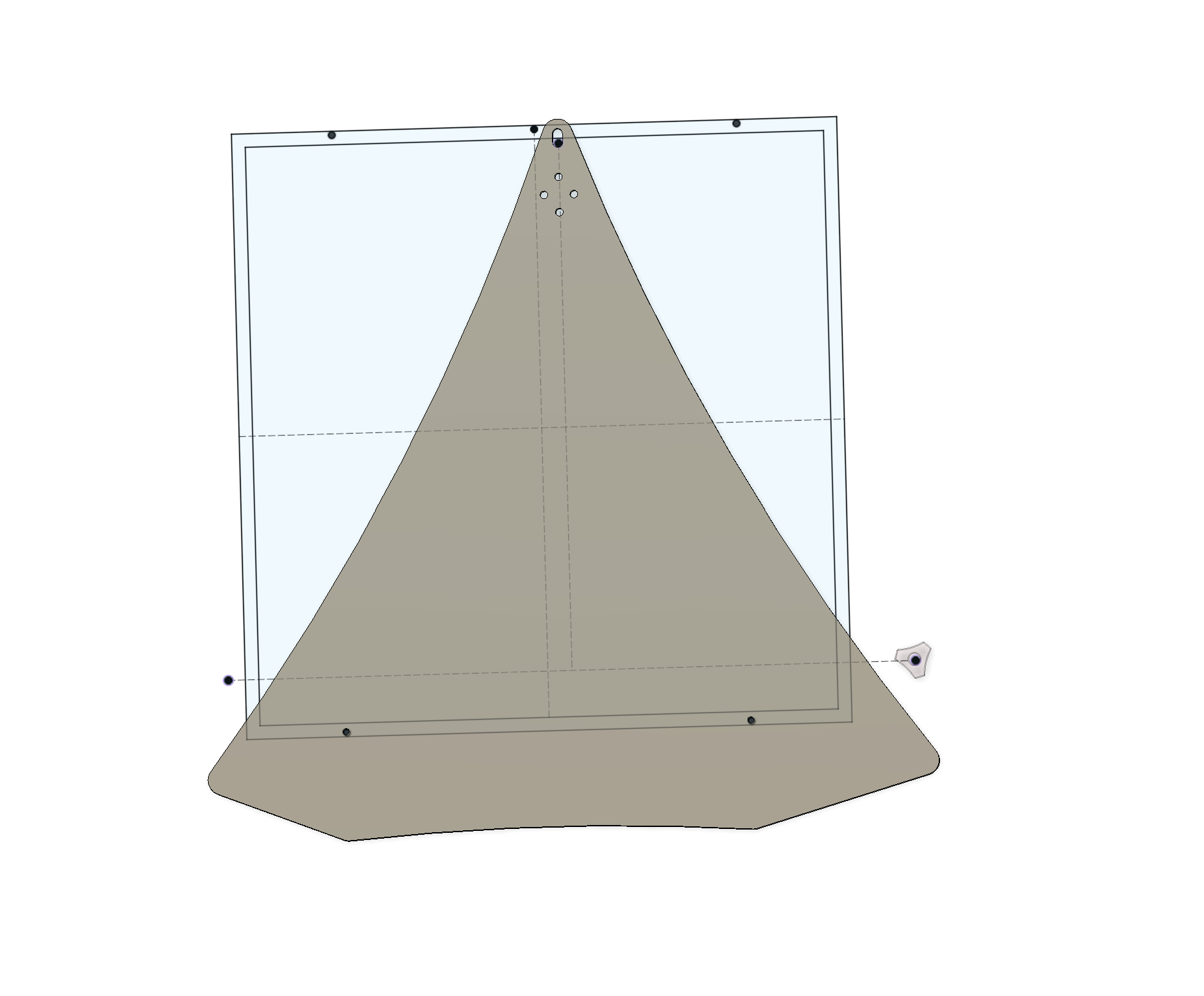

Thinking about this bed deal more. Ive had problems in the past with it not always wanting to finish a bed level. I only have 3 points that the bed attaches…
Bed is 300mm square and the support plate cut like what you see in the pic. I didn’t know it was able to go to 4 points with the bed support or how to accomplish that. I see it now but I still cant quite get the DXF to come out right
Should be something like this…
and have 4 mounting points for the bed. I really think that might support the back corners of the bed better and might keep my bed more level when it heats up but I really don’t know. In this sketch the screw holes aren’t in the right place because the bed is moved back for some reason. If I can figure out how to get the bed to move correctly then I think it will put the 4 holes like it should and give me the correct DXF. Then I could just set in a 25mm offset to the inside and have a better supported bed with a lighter bed support. I have more aluminum that I can cut a new one out of. But honestly I’m really thinking about going to MDF to get it even lighter if that will be enough to support it. I know @vicious1 is super busy but if you have 2 seconds to chime in I would love to hear your thoughts as well

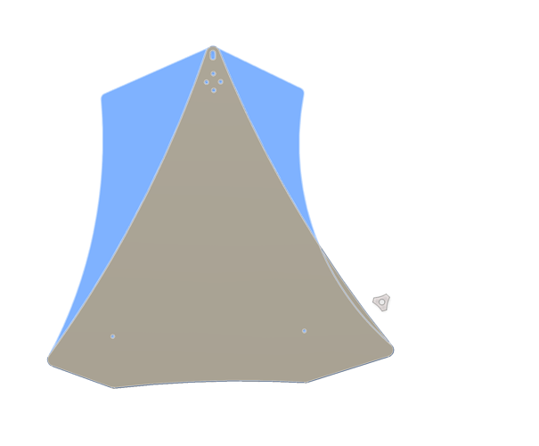

Shared my “plan” for bed support plate in MP3DP v4 - Aza's build - #83 by azab2c. Reality ended up bit different…
  • 1/4" Ply Bed Support Plate, was initially cut based on the sketched outline (faint blue and purple). 2 thick coats of primer paint.
    • However, Bed Support ended up much smaller (Brown outline), trimmed off bunch of material (Red scribbles) so the Filament Spool and drag chains (bed power, and Z Stepper wiring) could fit internally.
  • 1/4" Alu Bed, measured and cut 4 holes for mounting Alu Bed (Blue outline) to Support Bed based on where holes were located in the Mains voltage heater pad.
    • Used 4 bed leveling springs to mount, something like. I use this adjustment option to try and get bed level by hand during initial assembly.
      This reduces how much time Klipper/automated bed Z tilt leveling needs to do each print.
Hope that helps!
