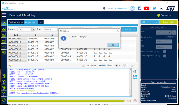

Re-reading from above, when you tried to flash, you set the boot jumper pin, and hit reset for 5+ seconds to properly put it in DFU mode, right?
Yes sir that is correct. And after that I can type lsusb and it will show up in dfu mode
Also, as I’m studying this, you’ve removed all the other connections? (Apparently if the heated bed is connected, for example, it screws up)
Have you tried using the STM32 programmer instead of the RPi?
Yes sir. Board is as naked as it gets…
Yes, with USB and with a ST Link Programmer…
https://www.amazon.com/dp/B07SQV6VLZ?psc=1&ref=ppx_yo2ov_dt_b_product_details
But the only thing I did with STM32 was try and flash the bootloader to repair the DFU. I did not try to put katapult/canboot on it with STM32.
That would be my suggestion…
Ok. Im almost done putting this ASA core on then I will give it a shot. Thank you!
katapult says it went…
klipper as well…
So did you revive the octopus?
As of right now no. Got to the same spot I got hung up at when I originally tried it. Cant get a uuid from it. I stopped messing with it at that point. Going to look at it more later tonight. Too many irons hot right this second LOL. Will report back with screen shots a little later
