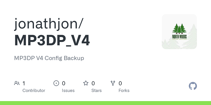

@azab2c or any of you other github gooroos. There is a way to have your klipper files automatically back up to github but I couldn’t figure out how to make it do it. Any of y’all have any success with this or know of a good guide for dummies?
Yeah, there’s several auto klipper printer.cfg backup scripts out there. Looked into, but never got around to implementing.
Klipper Backup Script - General Discussion - Klipper shared by an active Klipper forum member looks promising. Looks like script uses inotify-tools and handle file change notifications/events. That’s more efficient than some of the alternative solutions out there that periodically check for changes. Am not Linux literate enough to know if inotify-tools is good/bad option?
Curious if someone’s doing something similar/easier that they’re happy with?
Edit: ChatGPT4 says inotify-tools is commonly used for this type of file change observation scenario.

I just watched and followed along with this video…
It was easy to do and works great. One thing though, there are 2 commands with web links that don’t show up all the way in the description. I was able to click and open in a new tab, then I copied the part of the command before the link and pasted into putty, then went back to chrome and copied the full link that opened and pasted it in putty. Worked great.
Cool, thanks for sharing where your printer.cfg is backed up.
