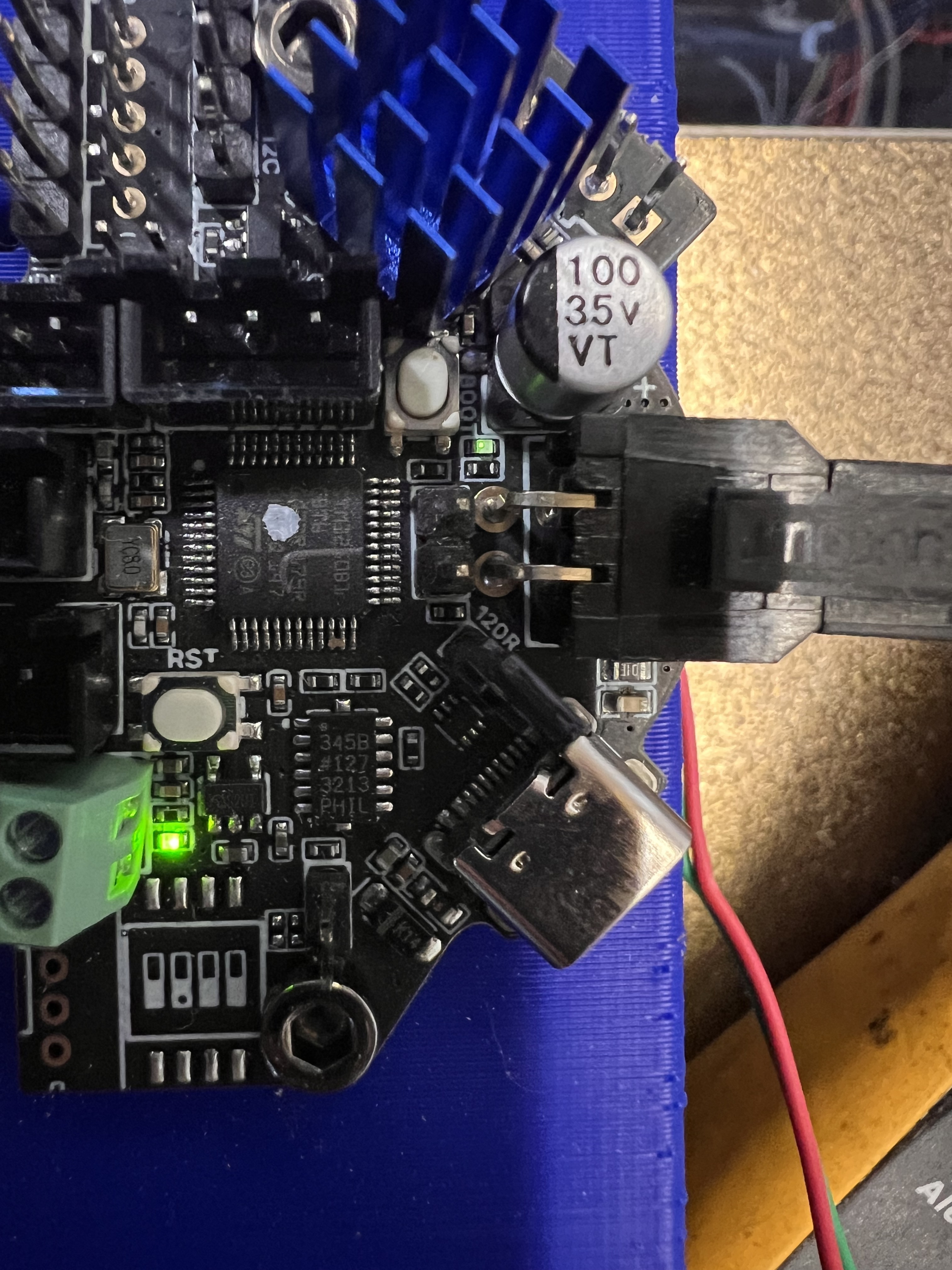

Well finally getting some time to mess with this some more. Got the hot end/extruder all mounted and the EBB36 mostly wired up as far as I know lol.
One question for the CAN guys (@azab2c and anyone else)…
I don’t see anywhere on the EBB36 to wire the endstop switch. So I’m guessing that wire will have to run back to the main board correct???

There is a place for it on the 36. on the left side there is a white connector that is for endstops. PC13, PC14, PC15
Thanks I don’t know how I didn’t see it before. Going to blame it on being tired lol.

I got some help from discord this morning and got past a lot of stuff to get all the way to here…
Looks like I got the same board @azab2c got lol. Swapping it now. A Google search for the problem lead me straight to your post on the klipper forum lol
Just installed the new one and it did the same thing with the dim light. Went ahead and flashed it anyways to see what would happen, this time I turned on the status led light to see if I would get can communication and that’s flashing like it should but I still cant get a uuid from it.

I guess both of my EBB36 are DOA. I don’t get it though. They both flashed just fine. The second one I turned on the status light and it blinked on and off just like it should. But nothing I do will get me a UUID. Just ordered a 3rd to see if I can get one to finally work LOL
On and off every second or so, this one is definitely functioning, probably. Double check baud rates match. Anything in the klippy.log? Vaguely recall needing to check/fix my can bus wiring.
I just built a second cable and triple checked it with my meter before hooking it up. I still cant get it. I have a U2C here and I think I’m going to try it that way but now I pretty much have to start over it seems the octopus is set up to be the can bridge currently. Man all this mess has me wanting to pull my hair out lol. it should NOT be this hard!

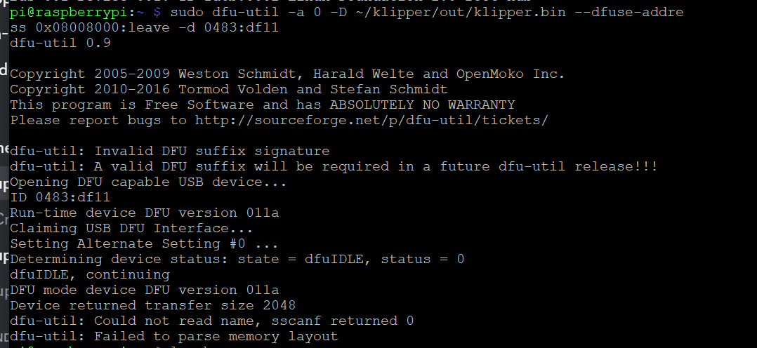

I got klipper flashed to the ebb36 but had to do it over usb using make flash. I should have been able to do it over can but I have to have the uuid to do that and I never could get it. doesn’t make any sense why i can flash a boot loader and firmware but I cant get a uuid from it.
Come to find out the problem wasnt with the ebb36 after all. I hooked it up to a U2C and had just it hooked to the Pi and I got a uuid from it. So its communicating. Tried to start over and reflash everything on the octopus and I think its bricked. Keep getting this error…
I am thinking there is a way to reflash the stock bootloader and fix it but I haven’t been successful with that yet. The first guide I followed had me use STM32 to flash the canboot and I think that’s where things went wrong. The more I look around since then no other guide mentions using that. But I have come across mentions of being able to use it to fix a bricked board but no one explaining how lol.
Well I finally got it moving today!!! And with Canbus to the toolhead!!! Wasn’t the way I set out to do it but I did get it done lol.
I’m pretty sure I bricked the Octopus board. But I do believe there is a way to fix it I just didn’t have the patients to go down that road right now. Leave that for another day lol.
What I ended up doing was going back to the SKR Pro 1.2 and using a U2C. And that worked great! Its amazing how much stuff you can hook up on this little board and run over just 4 wires!
