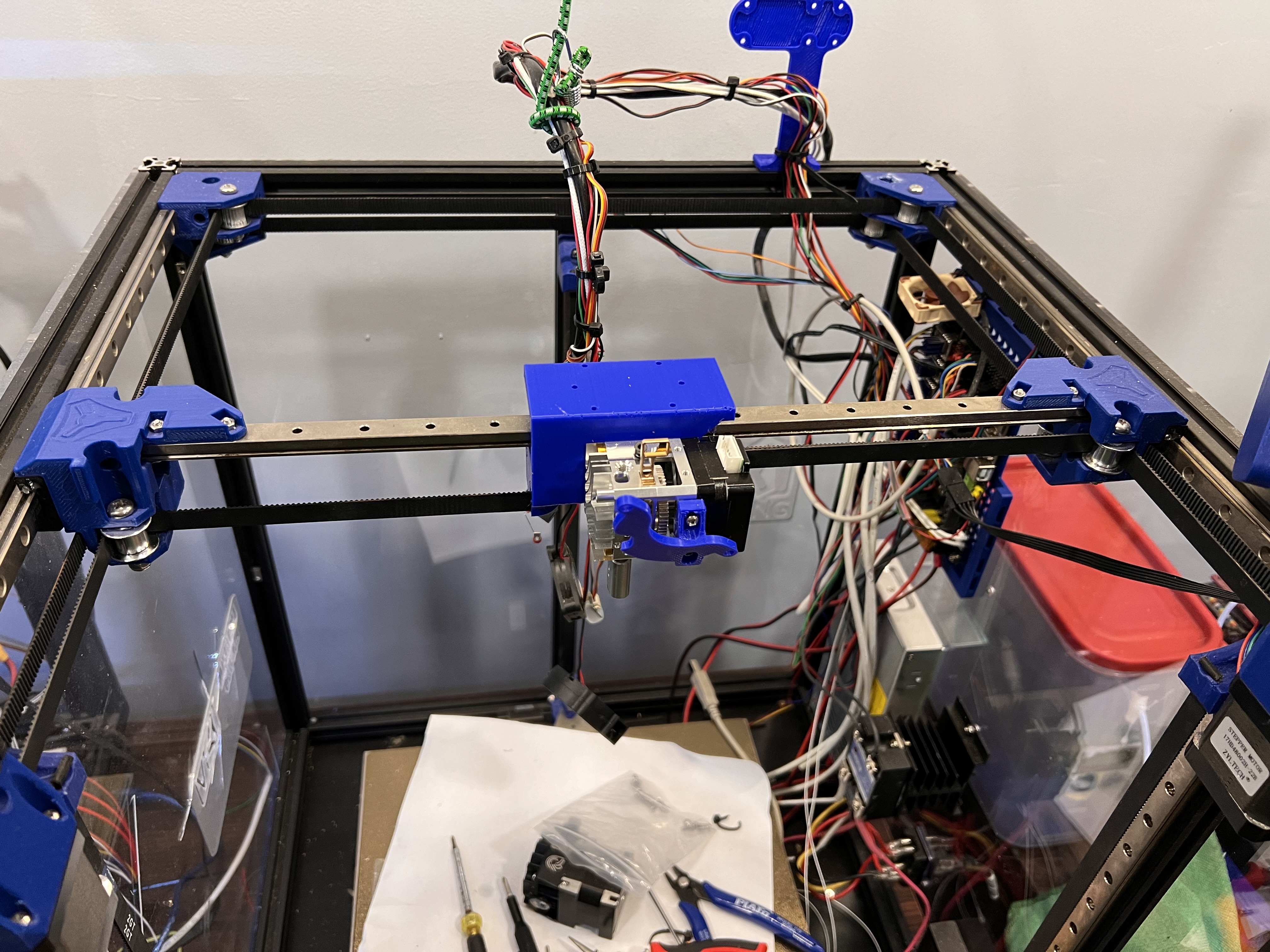

Amazon just delivered. Time for an upgrade…
Good luck! Like that you’re going with larger screen, nice! My 3.5" screen is awkward to use. Fortunately printer is very close to PC, so am mostly using mainsail web app to interact/control.

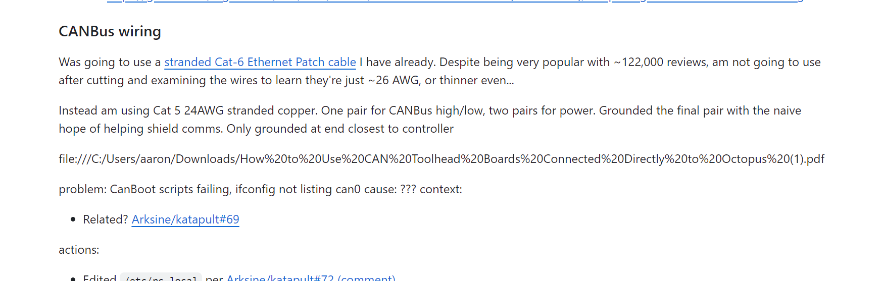

Just created playlist of CANbus content I watched when setting up https://youtube.com/playlist?list=PLC3VDmXcVPU93-3EvwPKBNJz9Ci7V2tVx&si=ZLq9mTfzBpy6lD-H, watched bunch of Voron Octopus CANBus content given how similar the setup is. Includes some CANBus content not related to printer build, partly because am curious about using CANBus for other projects.

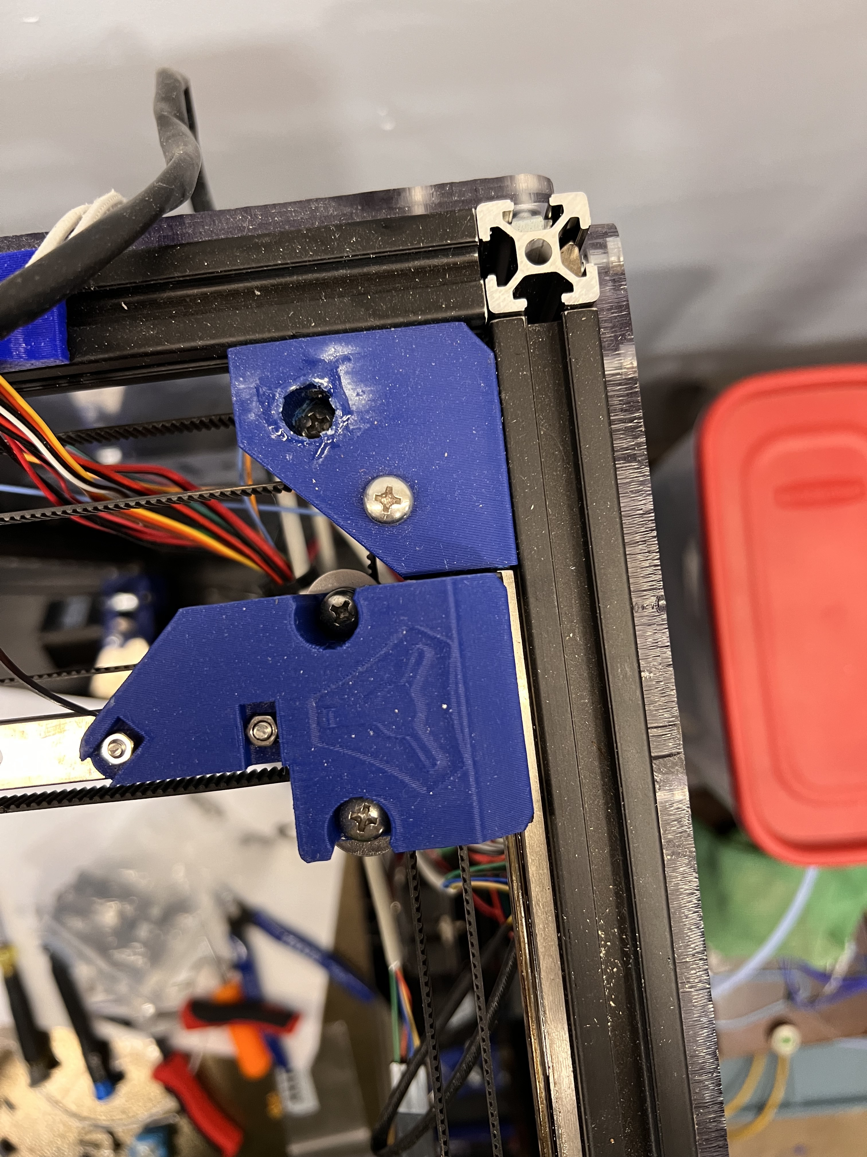

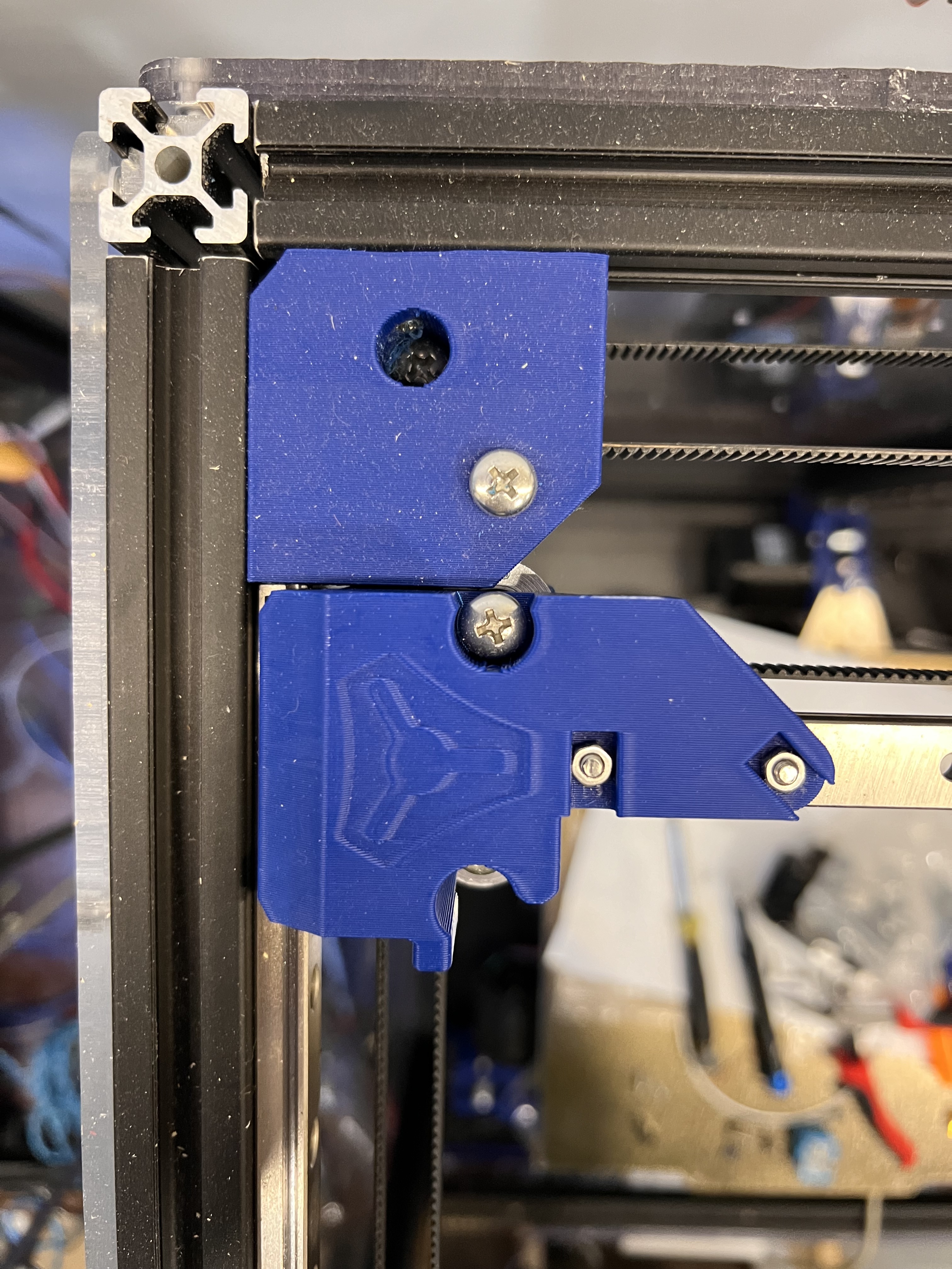

Making a little progress. Got the belts all reattached on the new core. And for the first time ever I was actually able to get it to land square in the back. I’ve fought with that so many times it’s not even funny
Man this CAN Bus stuff is WAY more confusing than I thought it was going to be LOL
@azab2c am I missing something to be able to view this file?? I don’t see anywhere that lets me open it, but I’m github dumb lol
Took me days… Klipper forum has bunch of posts sharing my struggles. Folks there were helpful when I got stuck.
Looking…
Just came across this video…
And he has what at quick glance seems to be a pretty good write up, and he is using the same boards I have, my octopus is the Pro v1.0 so a little different than yours but not by much.
Looks like my Klipper/CANBus notes should have referenced https://klipper.discourse.group/uploads/short-url/oKyxrVja7wW0J8toGB1pqfaGp4z.pdf mentioned in this very helpful Klipper Forum post.
Fixed link in my notes, added to Related: section. Definitely wouldn’t call my scraps a guide, was mainly a place to dump info for myself, but shared incase others benefit. Cheers!
