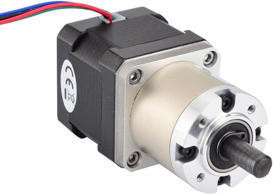

And given "Voron 2.4’s Z gearbox. A 16T pulley and an 80T pulley are coupled with a belt to provide an 80:16 gear ratio. " from Kyleisah on klipper forum
Maybe cheaper bulk bought flying Z Stepper with planetary gearbox with low ratios, e.g. 4:1 maybe?
Individually low (so z hop doesn’t suffer), but high enough resistance when 3 are used together to resist violent drop of a ~4lb bed, ‘slow’ drop seems ok.
Special steppers might seem expensive, until you’ve killed a Controller board or 2… And weighed up pros/cons reliability/corner-cases/assembly/aesthetics of other alternatives? Hopefully something with less quirky ratios exist than this $40 0.067° step angle Stepperonline exist.

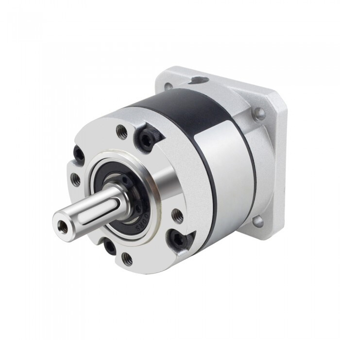

Or some 5:1 gearbox bolt-ons?
First search hit was this, I didn’t look at backlash specs, or shop around for better quality-price. Minor Z Stepper mount mod required, chamber has room. Aesthetically nice imo.
Guessing worm gear would be safest though, especially if planetary low ratio gear boxes are not resisting motion enough. Even if the plate falls slow-moderate speed, the geared stepper may still spin fast enough to create board killing back emf.
