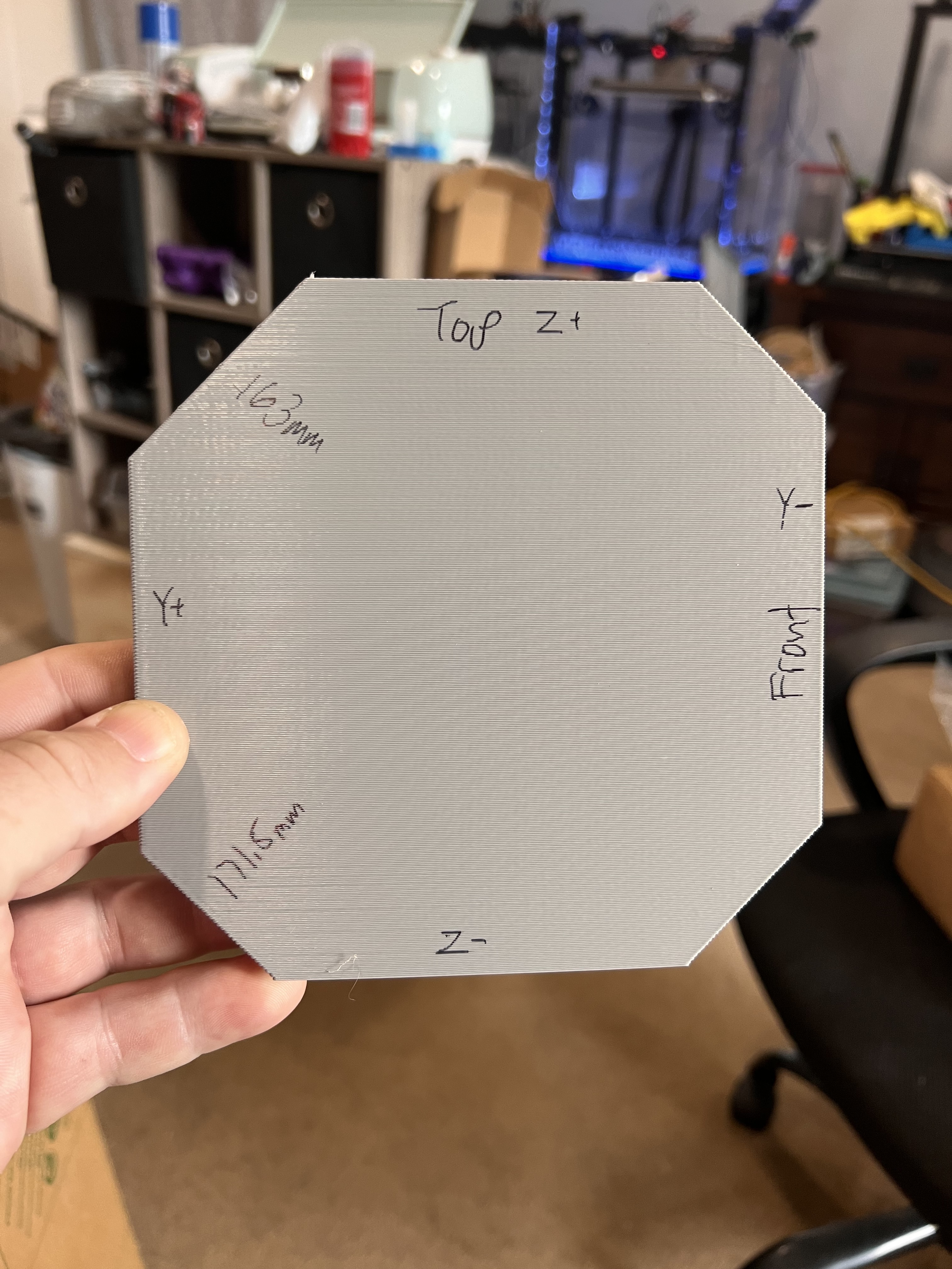

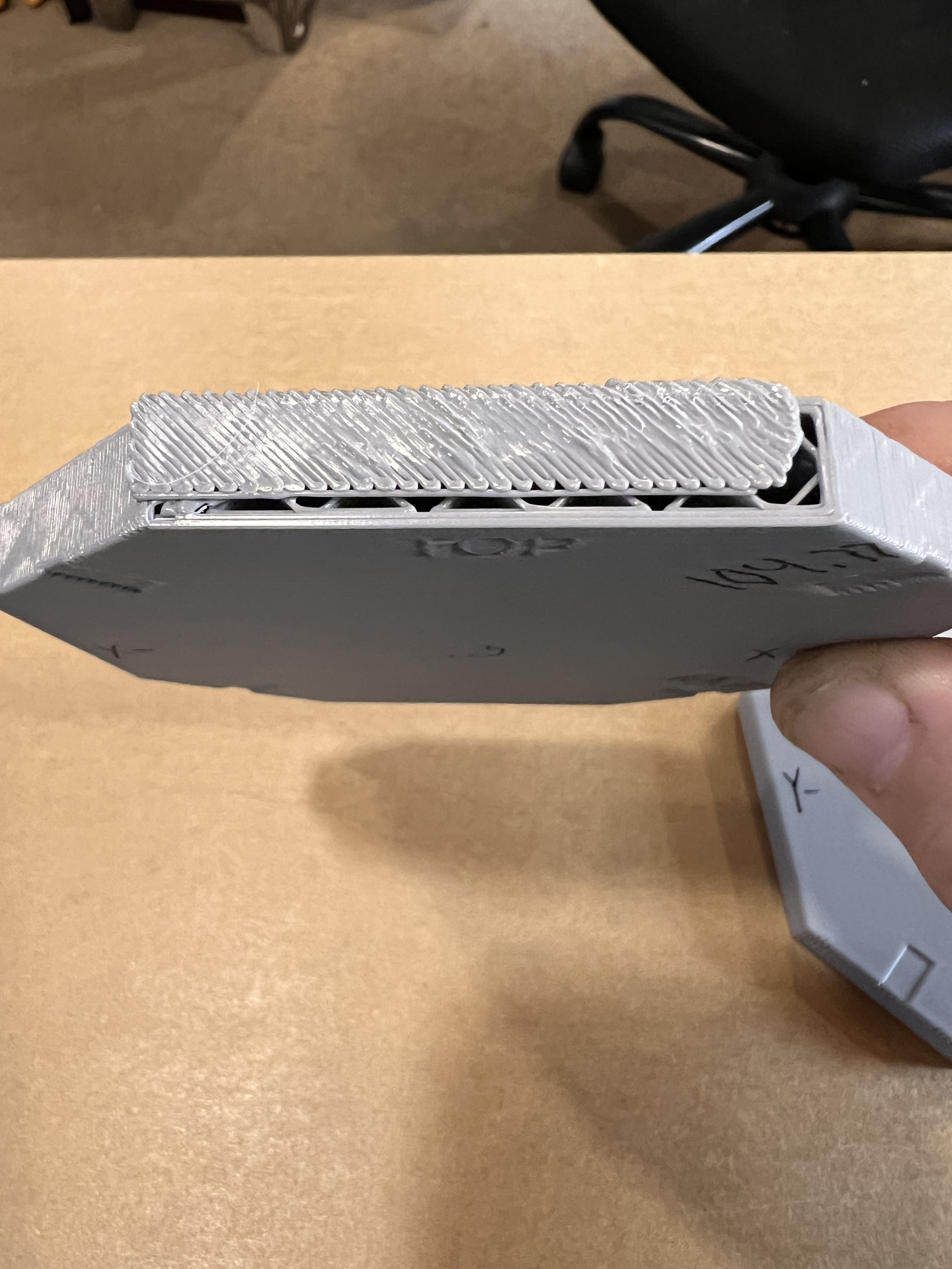

that looks to me like your extruder was starving and you didn’t get enough filament… did it get caught on something? or was the extruder skipping steps or slipping on the input? nozzle partially blocked? cheap filament? I’ve made way too many things that look like this.
Taking another look at the photos, and I started thinking that the XY error does kind of look like a 45° thing… which would be one of the CoreXY motors, and yeah, one Z motor is dropping a bit more than it should.
What do you have motor current set to, and … you did jumper the SKR to put the steppers into UART mode, right? :eyes:
Anyway, get potential mechanicalbissues dealt with first… a motor skipping steps sounds pretty distinct. I can hear it when my printer does this (typically because the print has warped and lifted and the print head has hit it and got stuck) even when the printer is in the other room.
Its brand new Hatchbox PLA that was dried and put in a Dry box with a monitor that shows 10% humidity. It was and still is feeding just fine. I did my best with the pics but the start gaps are only on the back side. its a straight line there. on the other side its leaning like only the back Z motor skipped steps
To me it looks like it only moved in y. It’s hard to get a good pic of it

Well I have a print going now that SEEMS to be going good. No skipped steps so far at least. I did find one major deal (at least I think it is) in the slicer. Infill was set to 300% speed. And that’s where I watched it start skipping steps earlier tonight. I brought that down to 150% and its doing much better.
Another change I’m thinking about making is lowering the Acceleration down from 3000. This thing really jerks sometimes and I think that’s part of the cause of missed steps as well. This being a larger printer than Ryan builds I just don’t think it can quite handle as much. Or he may be running much different settings in his slicer… I’m not sure. I know as much as I thought I knew about 3d printing I still have a TON to learn LOL. Any tips or advice will always be welcomed!!

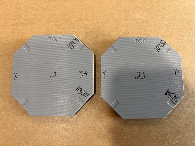

Well it finished the test. And the print looks good. But that’s where it stops. Its 8.5mm out of square… That’s measured with a tape measure as I made the model too large to fit my calipers over it. printing another now that I can measure that way, also printing it in the other orientation.
The one I’m printing now is in the opposite direction so we will see how far that one is out. Then to figure out how to fix this mess.
How do you know how much the motor hold torque rating is? Do you measure it or the stepper depth? I have some V1E steppers and some 6 pin steppers and some 4 pin ones… I was thinking the depth was of interest for this, but not sure. I’m seeing new z steppers in my future.
@orob please don’t take my build as anything negative toward MP3DP… This as all been my errors not anything on the design.

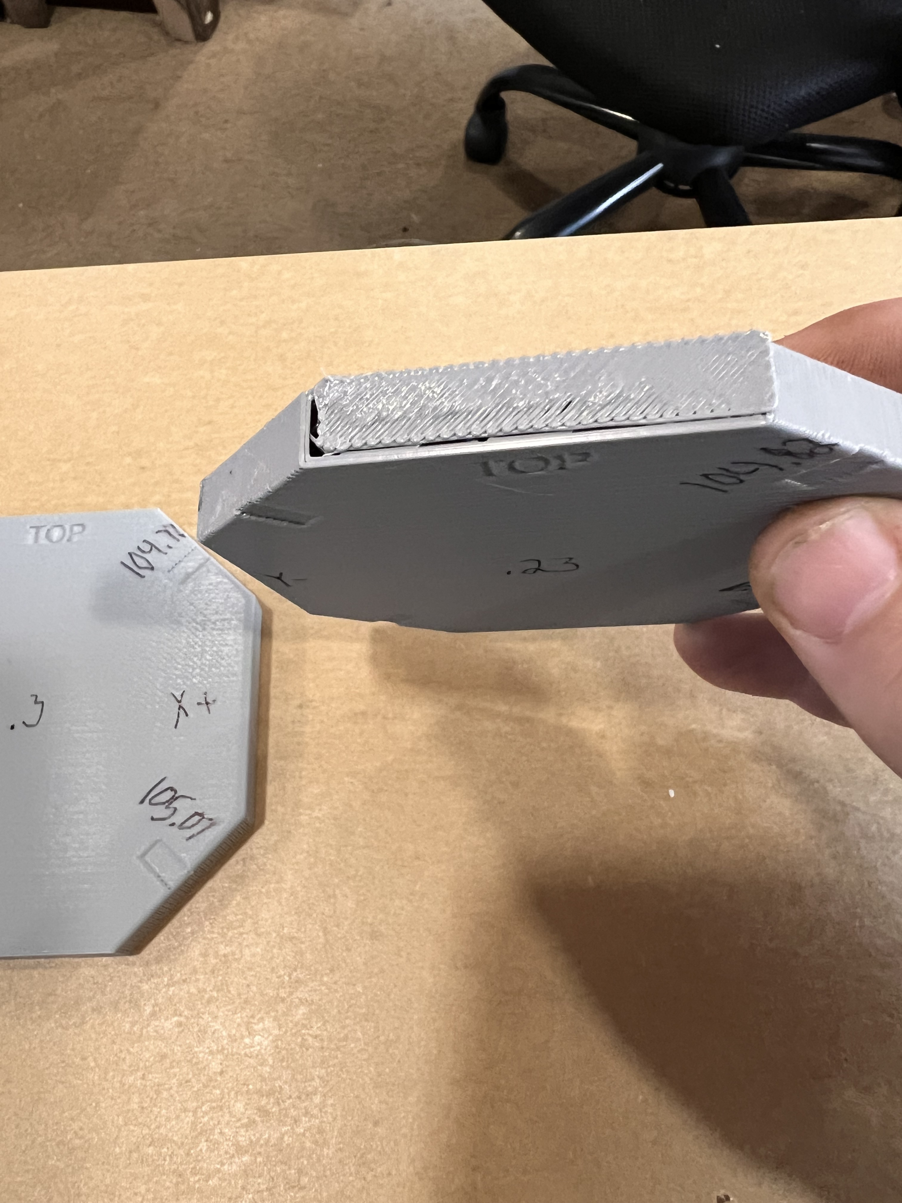

Ok both new parts have finished printing and for some reason are not near as far out of square as the first larger one. So that has me questioning some things. Also they both skipped steps at the same spot at the very top.
Just realized I’m an idiot yet again. If you take a close look the chamfers on the corners are not the same. That’s why it measured different. Couldn’t see the forest for the trees… Well that makes me feel a little better about it now. I know I set them all the same on the new smaller one. So now the question is how do I take that little bit of error out? or is that enough to even worry about?

One thing I find crazy is both of them skipped steps on the exact same layer
