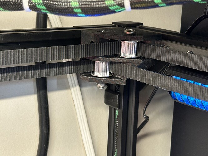

Idlers and Pulleys all freely rotating, clean and moving smoothly when pushed around by hand?

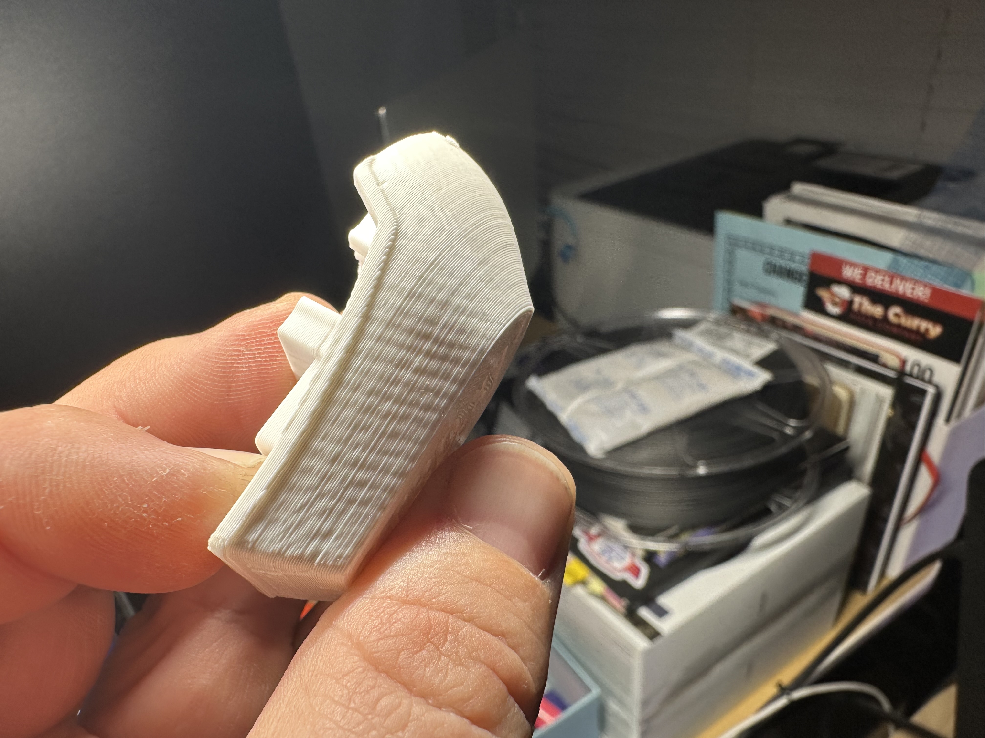

Is this with or without accelerometer based input shaping?
Input shaping is on and my understanding that it is correcting for oscillations that happen due to rapid accelerations and these normally fade. These on the picture always have the same spacing no matter what speed I am printing at

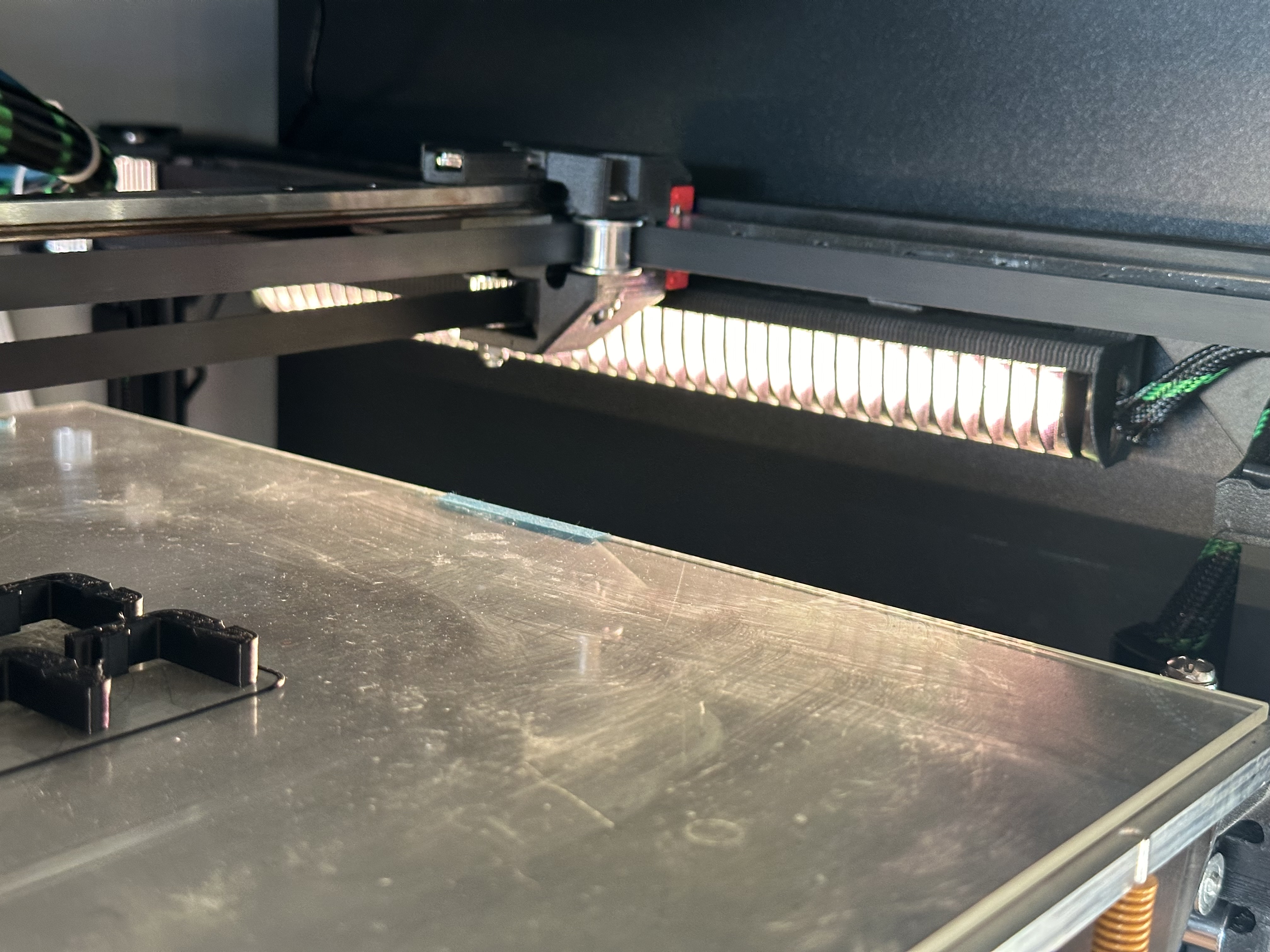

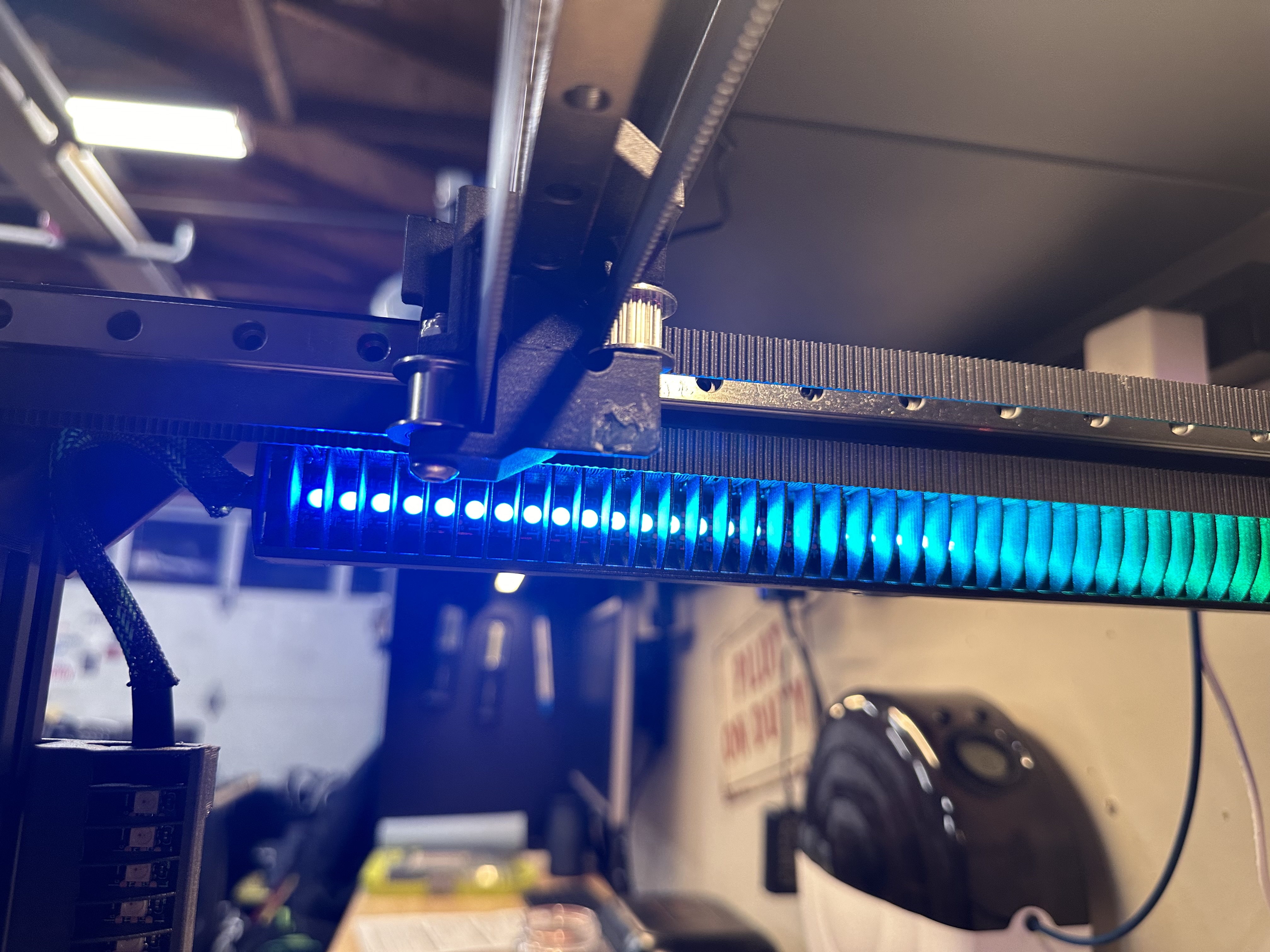

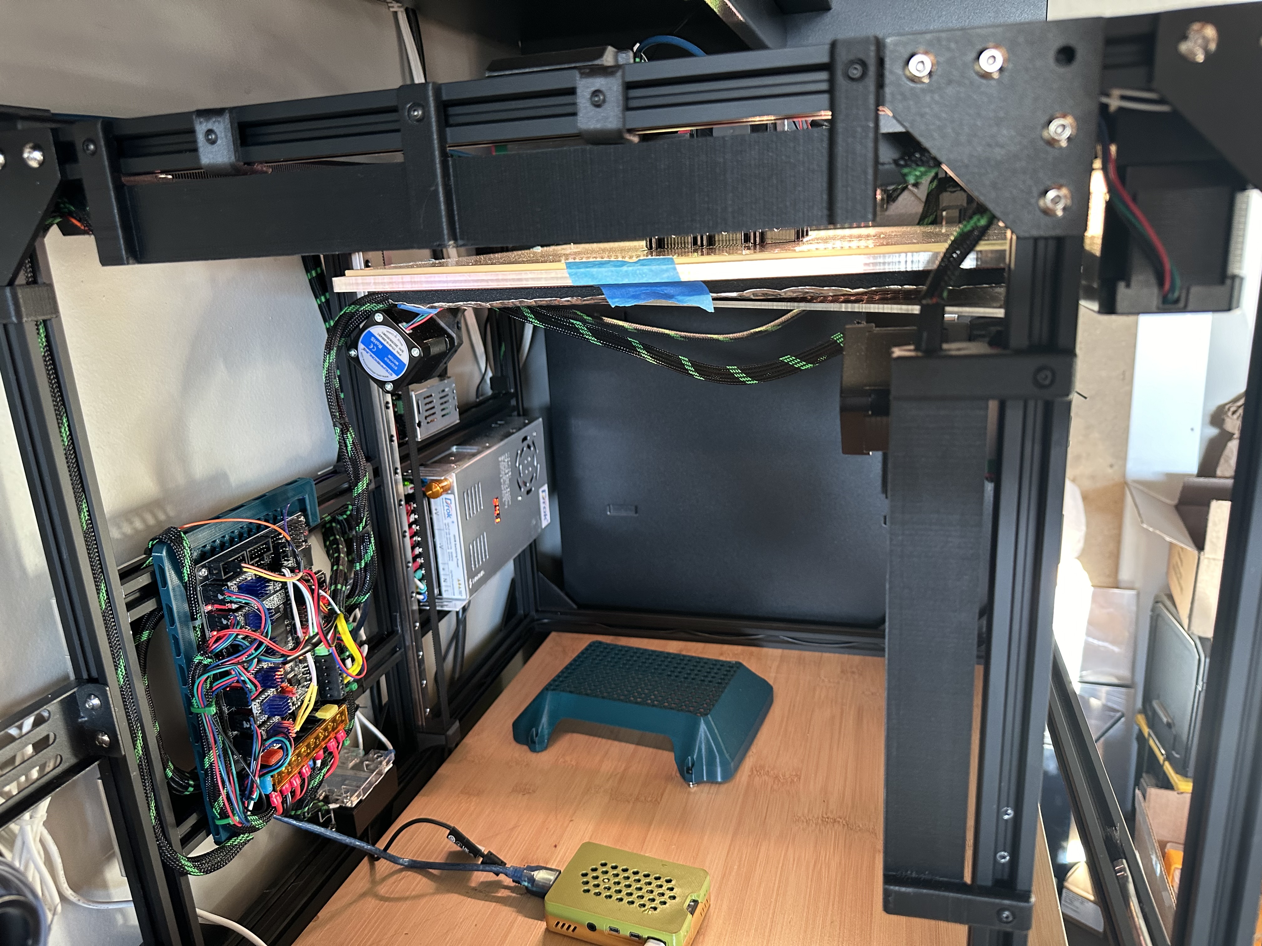

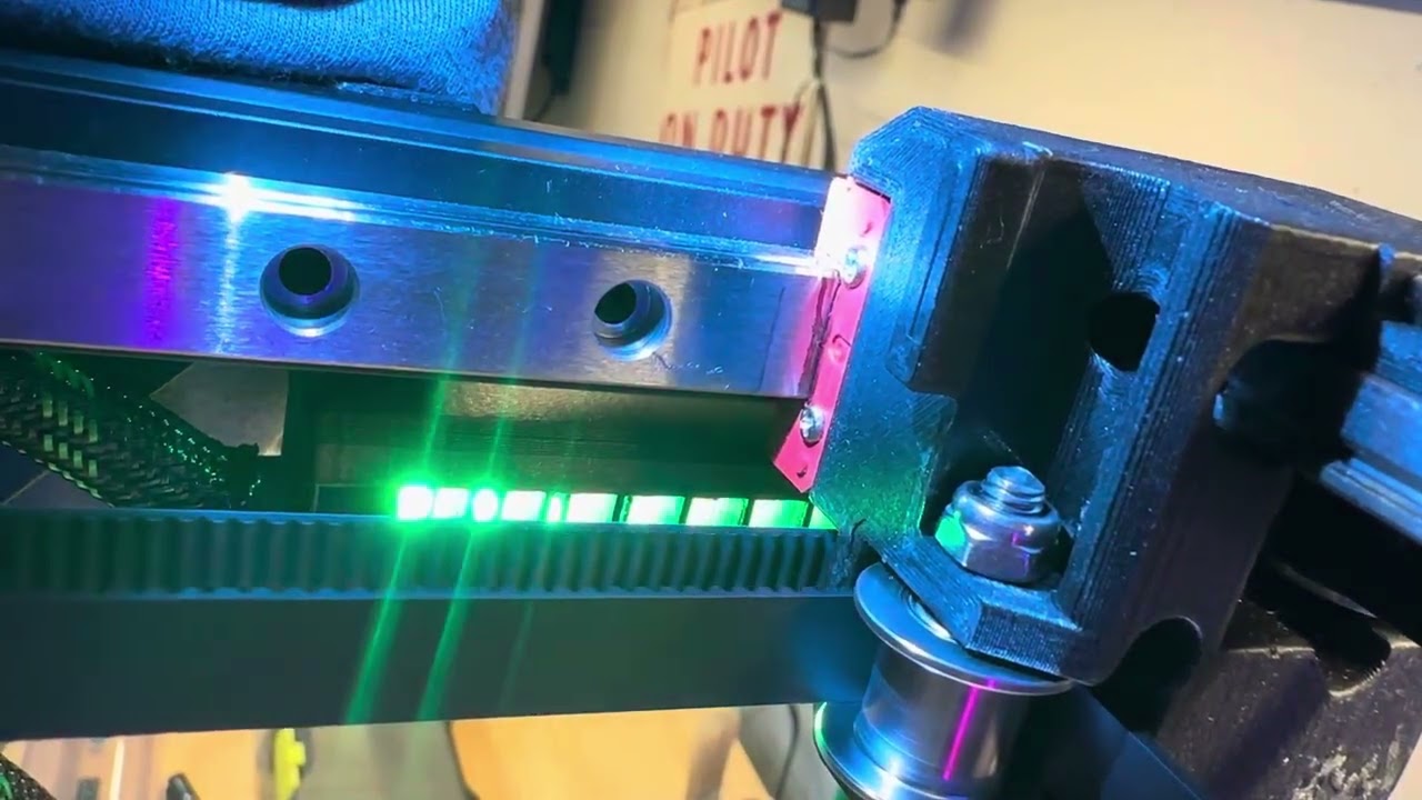

Quick update: added addressable LED lights and camera, also switched to klipper
Still can’t figure out that to replace painter tape with to hold glass bed, painters tape works surprisingly well tho.
Also, figured, painter’s tape torn by nozzle on a prime run makes great nozzle cleaning tool

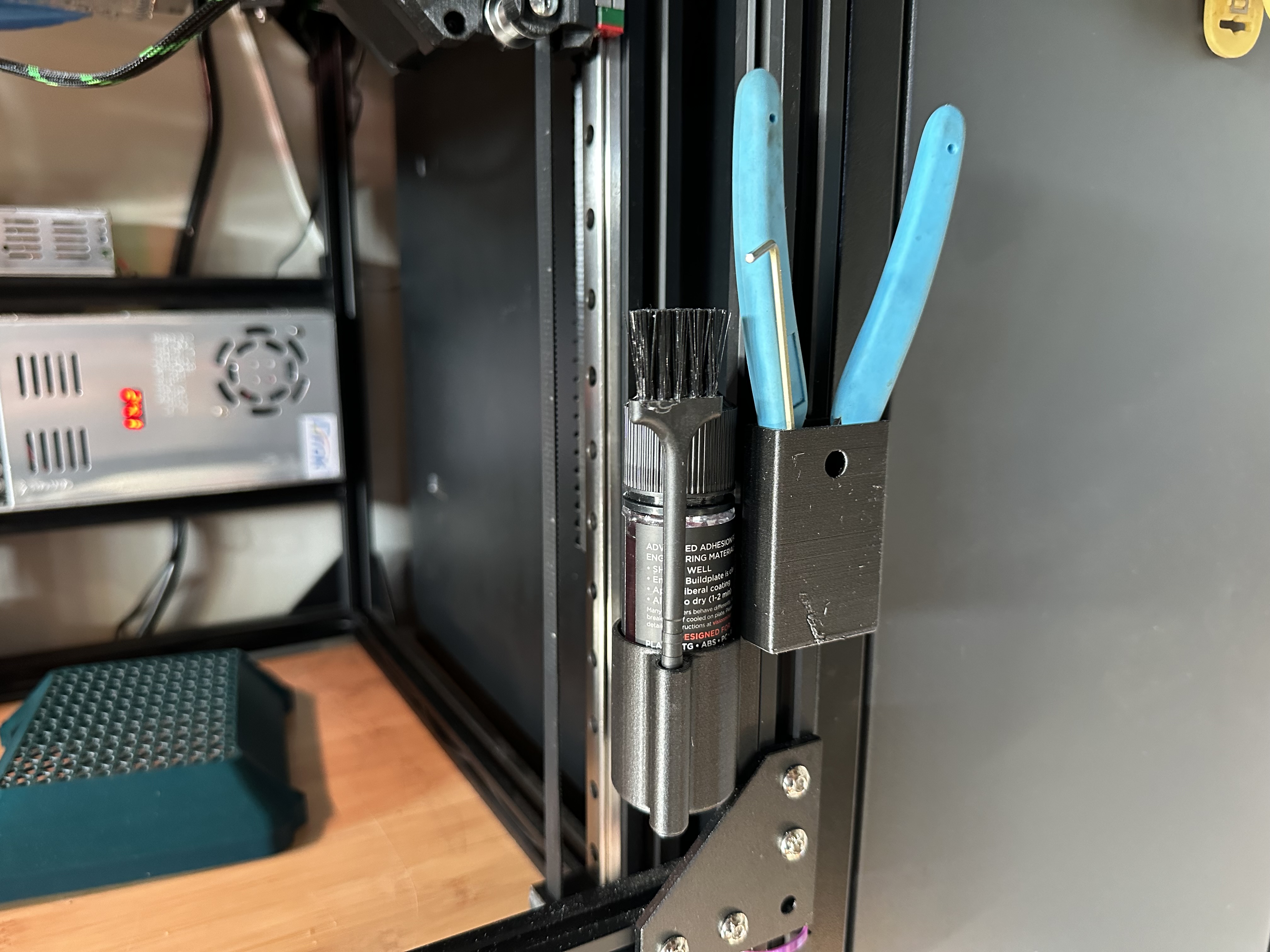

Added some tool holders, too
Looks good sounds good.

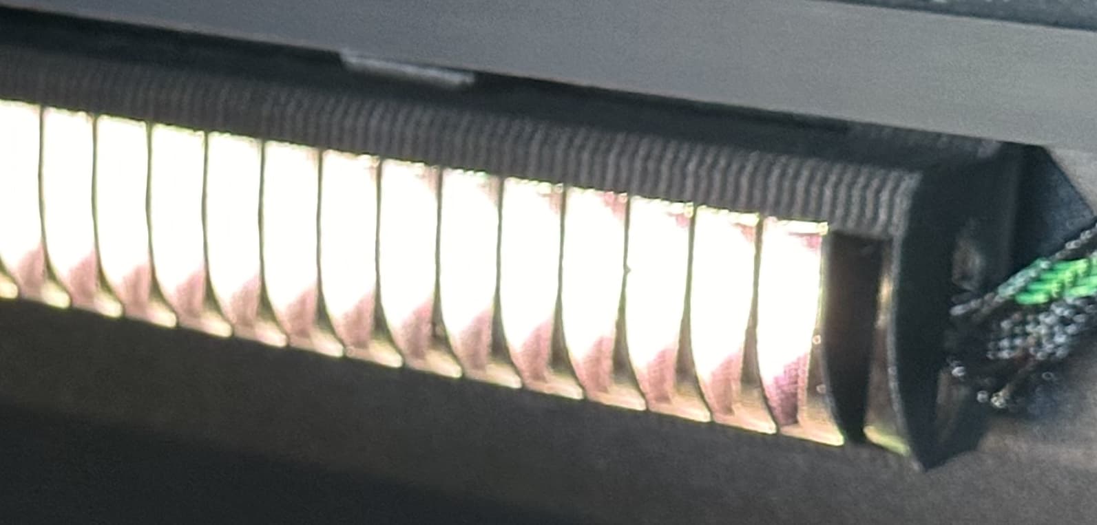

Nice lighting! Like the diffusers/grill, saw similar on a Voron at OpenSauce. Great to see on a V1E MP3DP!

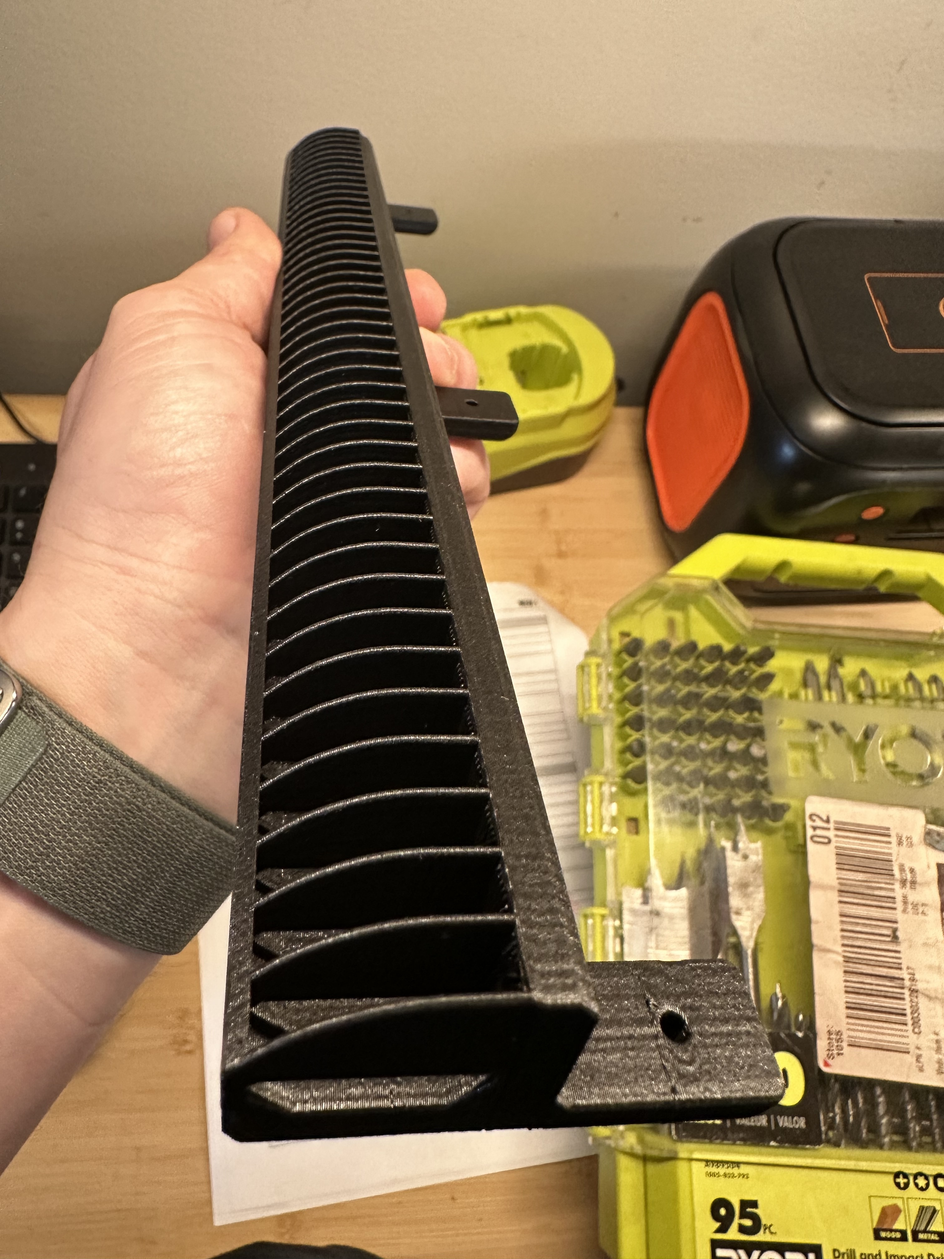

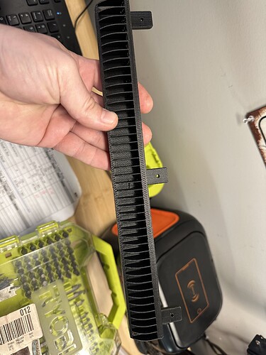

I had to design my own grills/diffusers due to custom size and mounting and since I am new to CAD these printed not very well. I am not sharing since printing them is a PITA :smiley:
Err, are those layer lines running along Z axis in this pic? Meaning that you printed these diffusers vertically with bridging well tuned? Even more impressed.
Exactly. It wasn’t too bad but definitely not a design for 3d printing

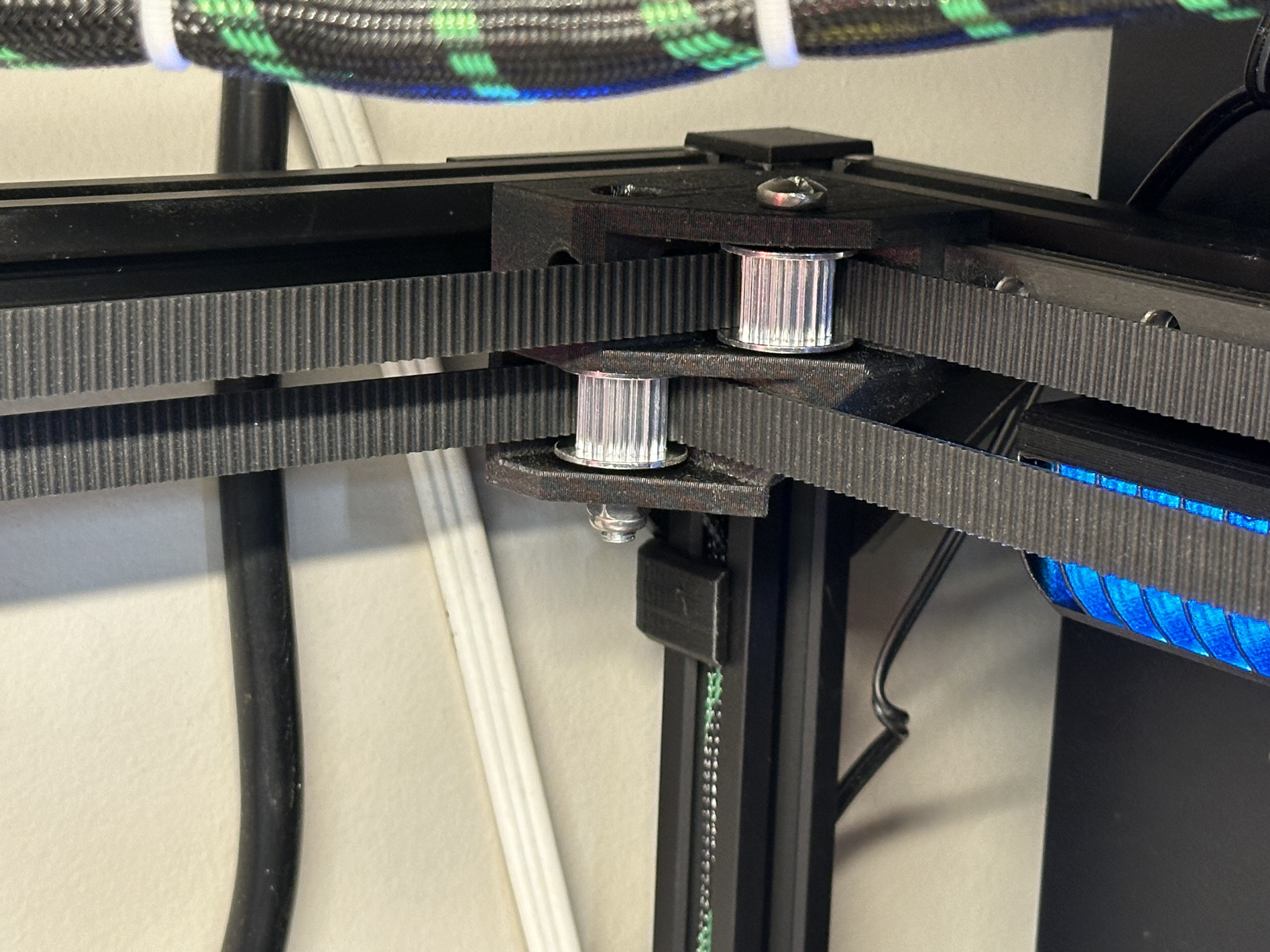

@vicious1 in response to your comment about pulleys, I believe I have correct ones. I also made a video that shows how Y axis moves slightly if you watch carefully when X axis moves

White PLA? Able to share your Cura/Prusa settings and gcode? Never printed a benchy, happy to try and see if I repro indents, curious if they’re build specific, or something to expect at the speed/settings you’re using.
2 things:
  1. the waviness you are seeing, could that be from the belts riding up or down on the pulleys from something in the drive train not being aligned? My front left motor will tweak a little and the belt will ride upwards on it. the undulation you see could be belt notch spacing.

That’s PETG but I have the same pattern with all materials and models
I think you have a pulley that is offset, like not concentric hole, watch the pulleys as they move fast to see if you can see one wobbling.
It is one of the pulleys or idlers must be not running true. That is pretty bad.
Make sure there is no black gunk built up on any of your idlers, one of my printers did that. Lumpy bugger.
I actually replaced one of the motors that had a bent shaft. At some point I will probably order expensive E3D pulleys and belt since I can’t see anything else wrong with mine at this point. What you say makes perfect sense but I just don’t see anything with a naked eye
