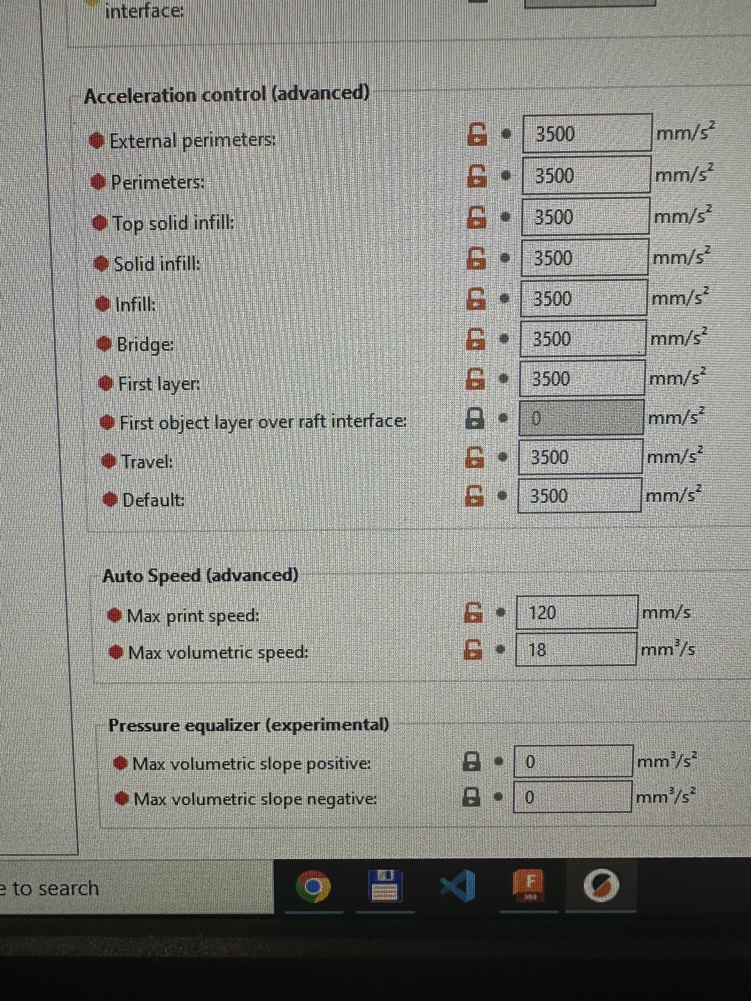

Fast settings were to test limits. My day to day printing is 120mm/s for PLA and 70mm/s for everything else. I slow down for small perimeters, too. Acceleration is 3500 with some input shaping. I can share my prusa profile but you will have to tweak a lot like starting / ending gcode etc, your extruder specific settings
I really need to figure out what is up with my printer. I’m running 1000 accelerations to keep it from skipping steps. Stock marlin I believe was 3000 from Ryan and it would skip all over the place there. I believe it did at 2000 as well. Gonna have to do some testing and see if I can figure out why.
3500 is an acceleration my printer can continuously perform thru the length if 325mm bed without skipping steps. I did tests described in Determining Maximum Speeds and Accelerations | Ellis’ Print Tuning Guide
On shorter runs I can do 6000-9000 but that gets violent pretty quickly. My XY current is set to 1.2amp
Yeah mine should be able to do the same but it surly cannot lol. Going to have to dig in and figure out why.

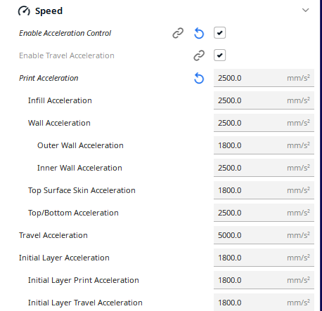

Increasd XY current from 0.7A to 1.0A, will observe temp using the V1E thermal stickers. 0.6 nozzle, 0.3mm layer height. No input shaping, will see what difference that makes later.

Interesting, will override my Outer Wall, Top Surface and Initial acc from 1800 to 3500 for this print.
Am using 500mm/s instead of 1000mm/s shown in screenshot of your settings.
