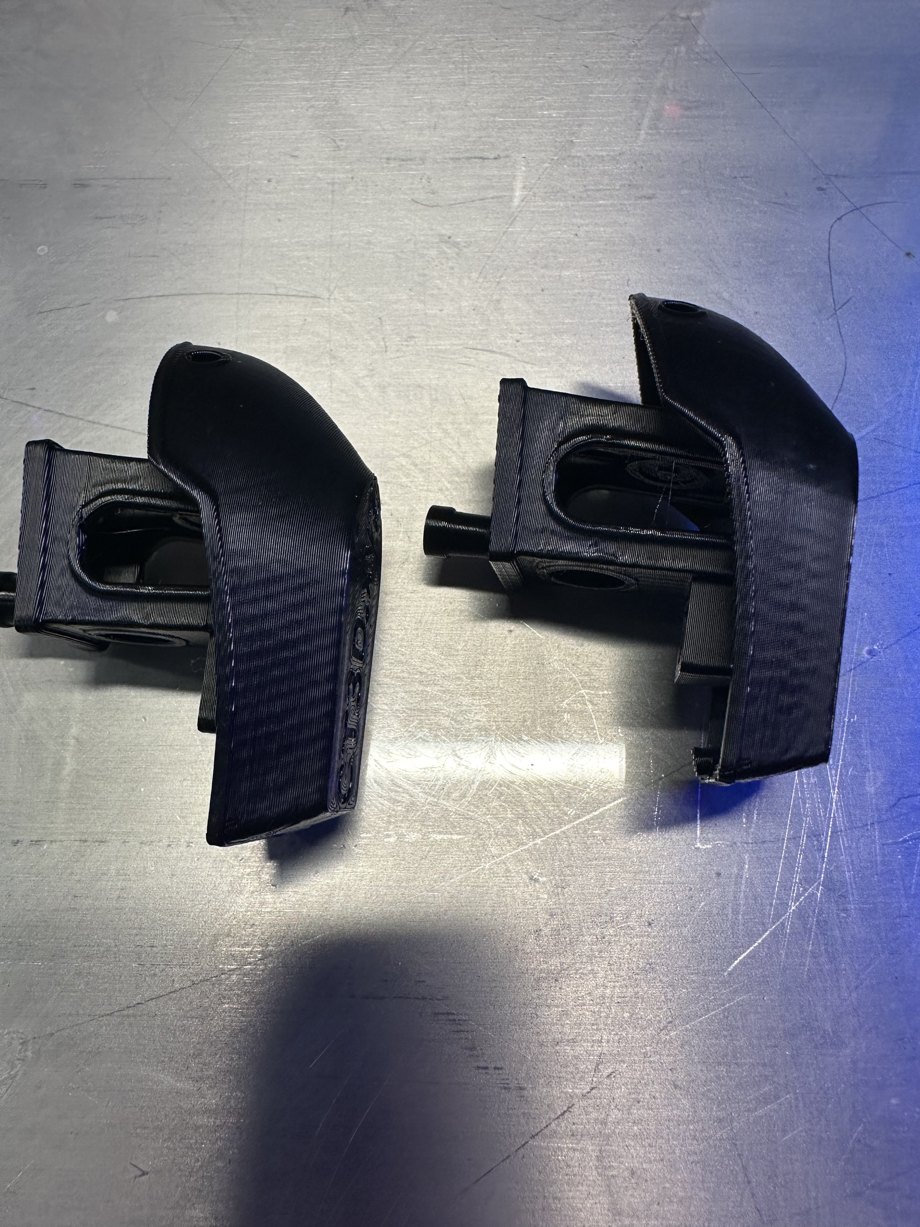

PLA is the main one that likes a lot of cooling correct? seems like past that you get less and less. I know for asa its no cooling, although I do run just a little bit for a nicer finish and to bring the speed up just a touch. But I’m only running 20% with Ryan’s fan duct
Also, one thing I learn in 3d printing is that many times issues related to over or under extrusion. This is the very first thing I do with a new setup or material - print a hollow cube with 6 walls making sure the sum or 6 0.4-0.45mm walls is equal to 2.4mm (without air gaps)

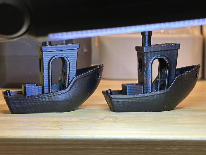

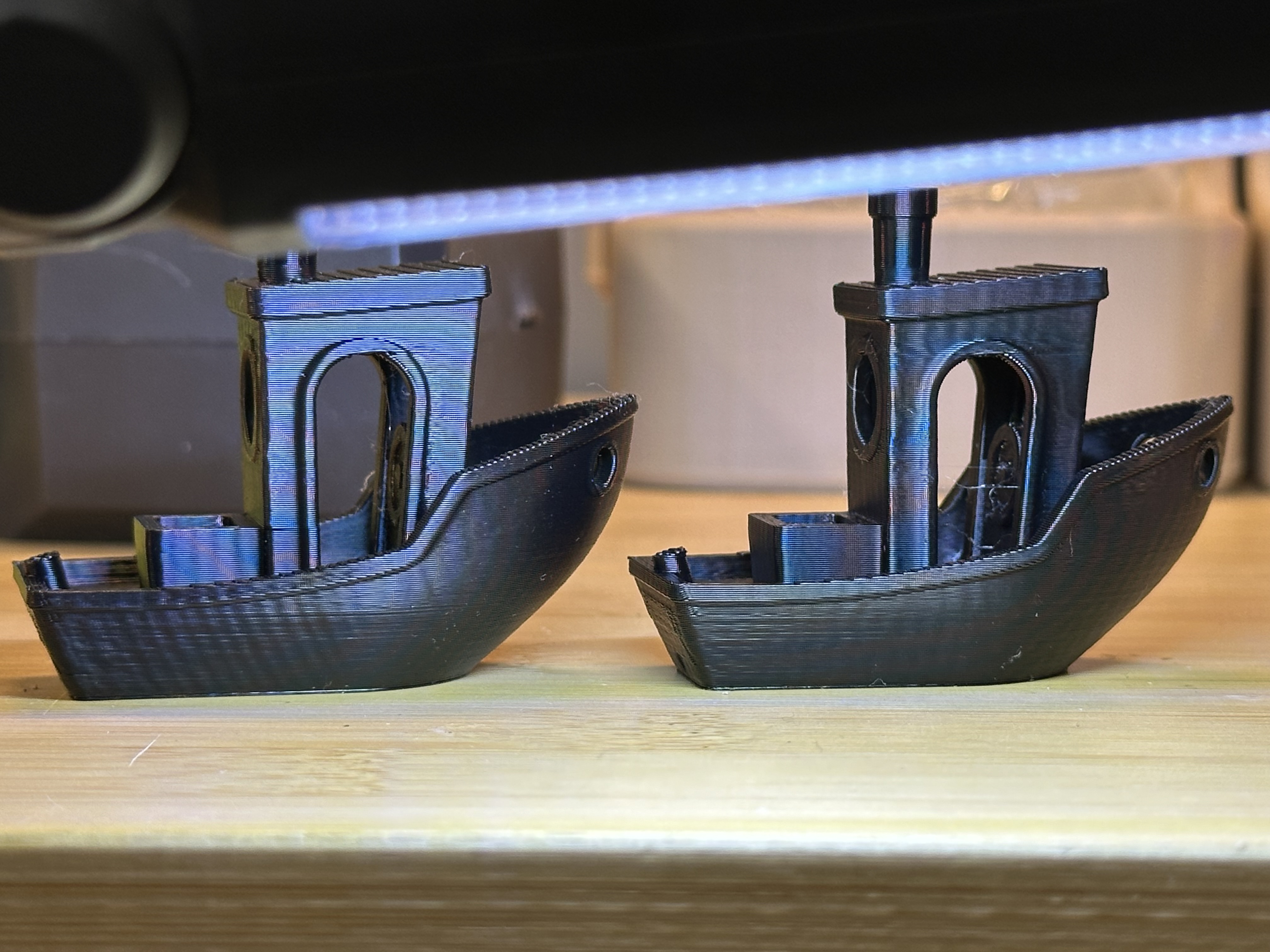

Update on the wavy patterns. I just replaced all XY pulleys and idlers with the ones Ryan sent me. I did that without changing the belt and tension. Left is before, right is after. I think it is a bit better but still able to see the pattern. New belt (different brand) will arrive tonight, I will try swapping it next
Sucks it wasn’t a complete fix but at least it was an improvement!
It really might be a second bent shaft…
I doubt because I was printing a cube another day placing it diagonally. This isolates XY motors but wavy patterns persisted on all sides of the cube. I can run this test again tho, when I replace the belt
That is odd. Have you tries thin lubricant on all your linear rail bearings?
I did. Similarly, I printed cube with a normal orientation to isolate gantries in case if the issue is bearing with no luck, again, I will be doing these tests again after I replace belts. There are not that many variables left

Any chance you have your belts really tight. Try this, go super loose, the corners of your prints will be soft not sharp. Only tighten it enough to get decent corners. Too loose and you get soft corners and a rough surface…but…too tight and you just get a rough surface (sometimes ringing but that is hard to see with input shaping).
The tension is way looser than you might expect.
Yeah. That surprised me too. Way less than I would have thought
Once you mentioned tension in the beginning of this thread I always check it to make sure it is just slightly above being loose. If too much tension printer also gets loud.
I just replaced XY belts. I can play a bit with belts tension but I think I will call it a day. Bottom line is - my belt and pulleys didn’t match perfectly
