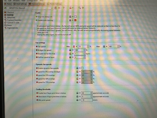

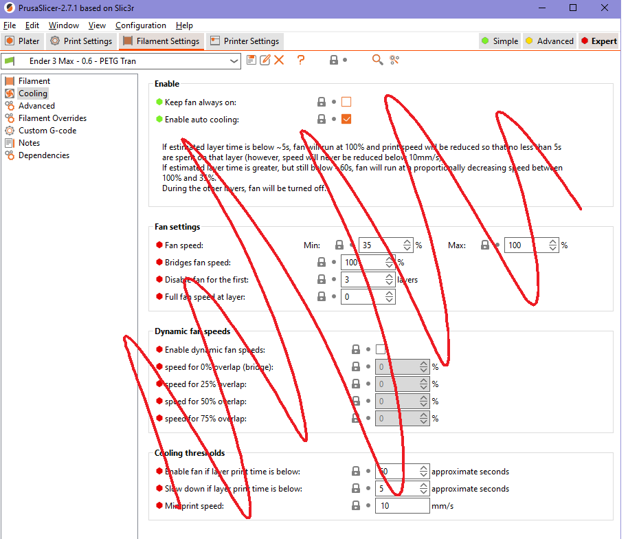

Able to share your profile, or cooling settings that are working for you? e.g.

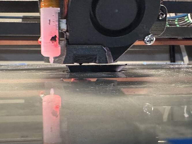

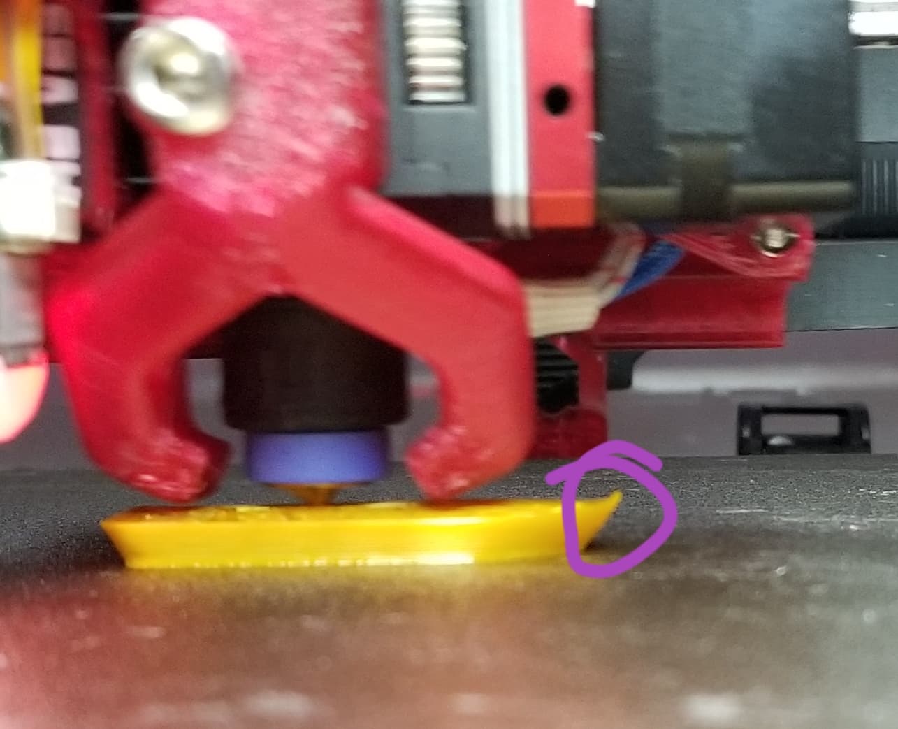

Yep… Updated my part cooling fan duct setup, is better, but… Still seeing issues with lower section of bow. Am digging around and trying different temps/speed too.

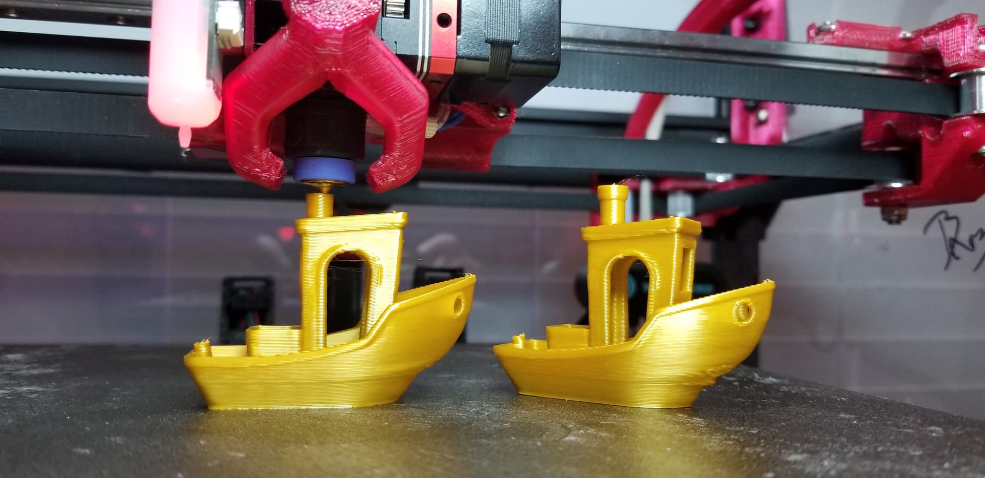

My hunch it’s not cooling tho. Printing benchy with fan set to 0 to see how it will look
Couple questions: how many walls? Do you print outside or inside walls first? Is filament dry?
Also, just a guess, any chance your voltage is 12v but fan is 24? That way you will be capped at 50% of it’s power. I am getting some curling at 50% fan and below

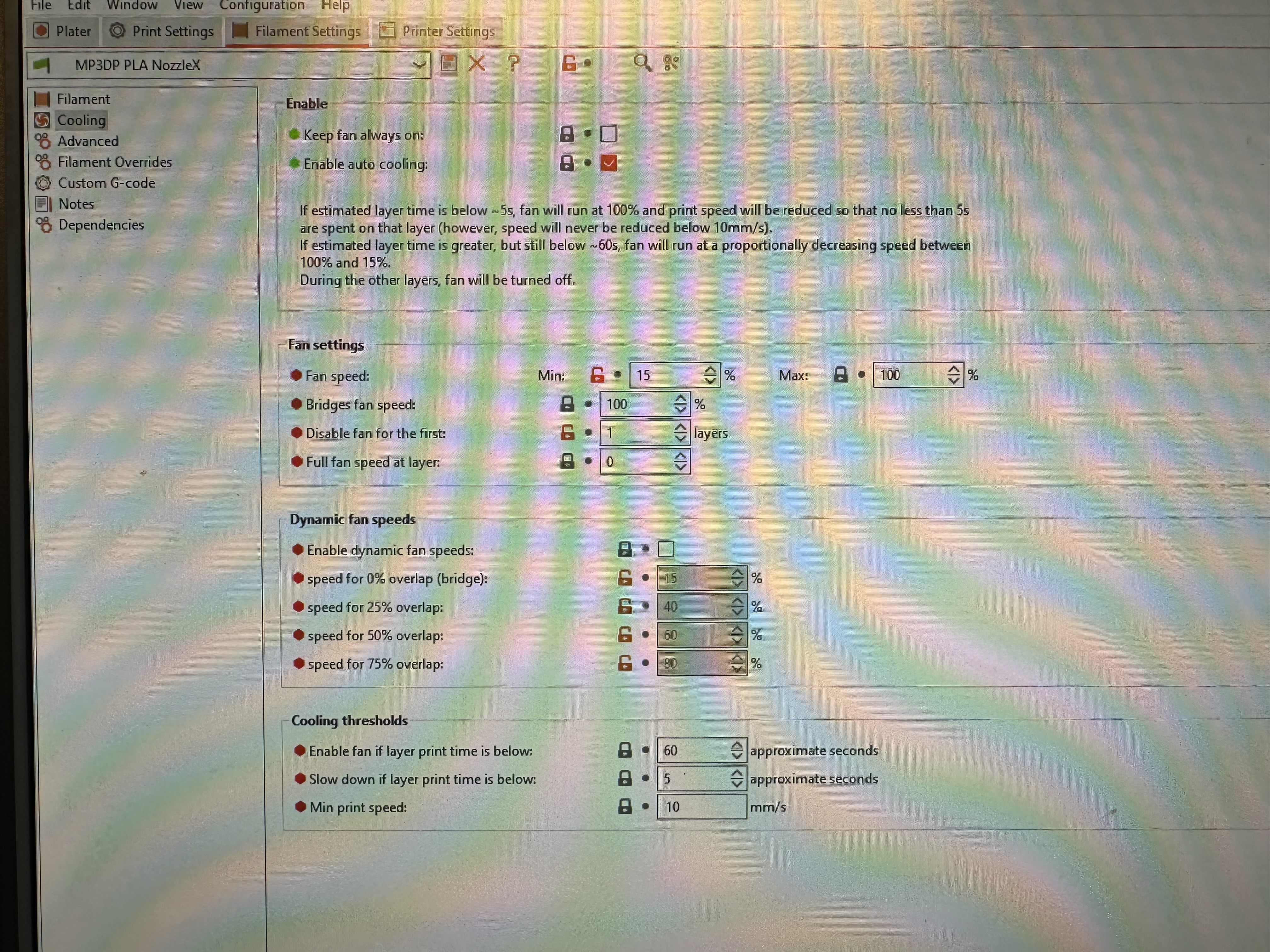

Cheers for sharing your cooling settings, that’s a helpful reference/comparison point. Great to know what speed and acceleration settings people are achieving.
Have BIQU H2 Revo CAN Bus setup, similar setup to @probrwr. Mike got a nice 200mm/s 4000 acc Benchy. His part cooling fan duct is more direct and better than mine. I’d use the same fan duct if my lid wasn’t in the way.

  • Good idea to check voltage, seeing 24V on the EBB36’s Fan port, Fans are rated 24V.
  • 0.6mm noz, 0.3mm layer height, 3 walls, alternative extra wall, 40% infill. This is how I print most structural/V1E parts. Probably overkill for a Benchy not going into naval battle…
Fortunately, am getting better results at higher speeds having read, tweaked and tested more. I have some more calibration/flow tests to tryout…
