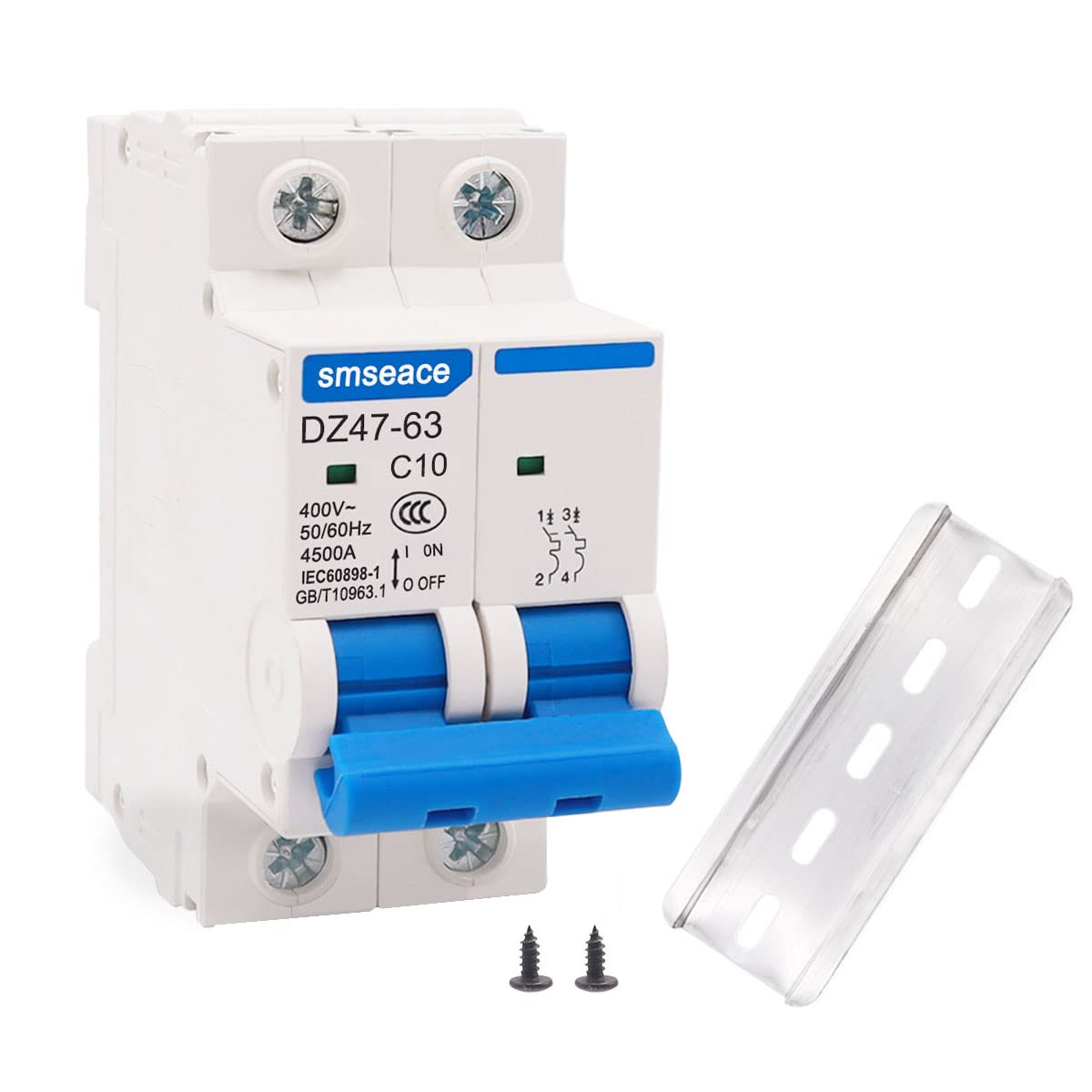

I have my entire machine going through a wifi switch. Then it goes through a backup on/off switch on the front of the machine.
I don’t bother powering the printer separate from the pi. Inside the control box, I have a second breaker on the AC line coming in. I still need to add a breaker to the power wire going to the heated bed (mine’s AC powered).
Right now my assumption is that a short in the AC line to the heated bed should trip the main breaker on the machine. But I’m not sure if that’s fully safe.
wifi switch, great idea if it doesn’t glitch like mine :smiley:
Fused power switch (10amp or something)? E.g…
https://www.amazon.com/BIQU-Rocker-Switch-Socket-Module/dp/B07KS2TQ45/ref=mp_s_a_1_3_maf_1?keywords=Fused+power+switch&qid=1699063049&sr=8-3
I have a fused power rocker to the 24v power supply. 24v goes to the 5v converter for the pi and to another rocker that toggles power to the bed and the octopus control board. Main power stays live for the rpi, but the board and bed can be easily switched and recently that has been helpful without corrupting the pi SD card.
I already have one of these sitting on a shelf. I figure I can just mount it on the rail next to the master breaker.

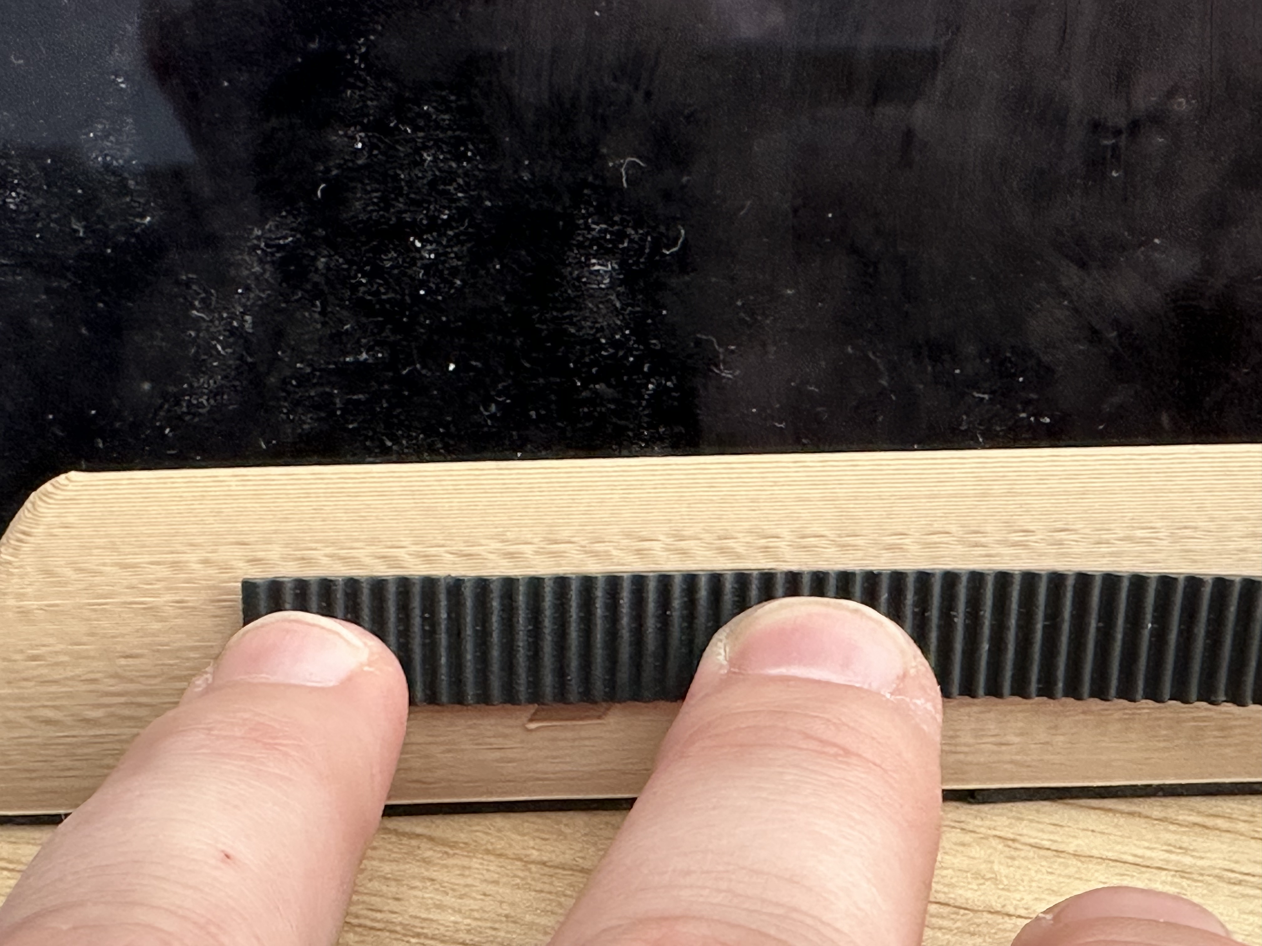

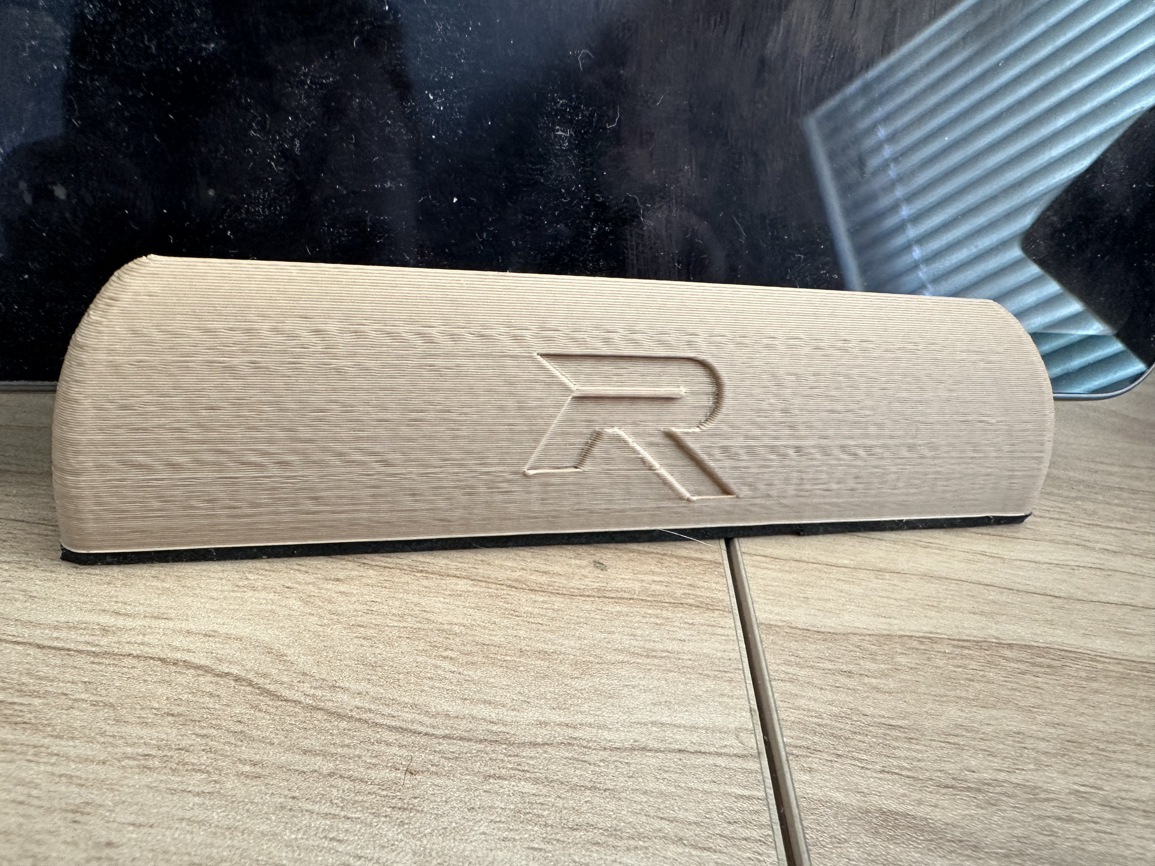

One problem I still can’t solve is these wavy patterns. These are not induced by vibration since they don’t fade. I see them if I print very slowly or very fast and spacing between these waves is always the same. Replaced all plastic parts and tried different XY belt tensions all the way to a super loose, no effect. Thinking about changing belt / pulleys to a different brand…. Distance between waves is close but does not match tooth spacing exactly
does the spacing of the waves match the circumference the balls in your linear bearing trolley?
