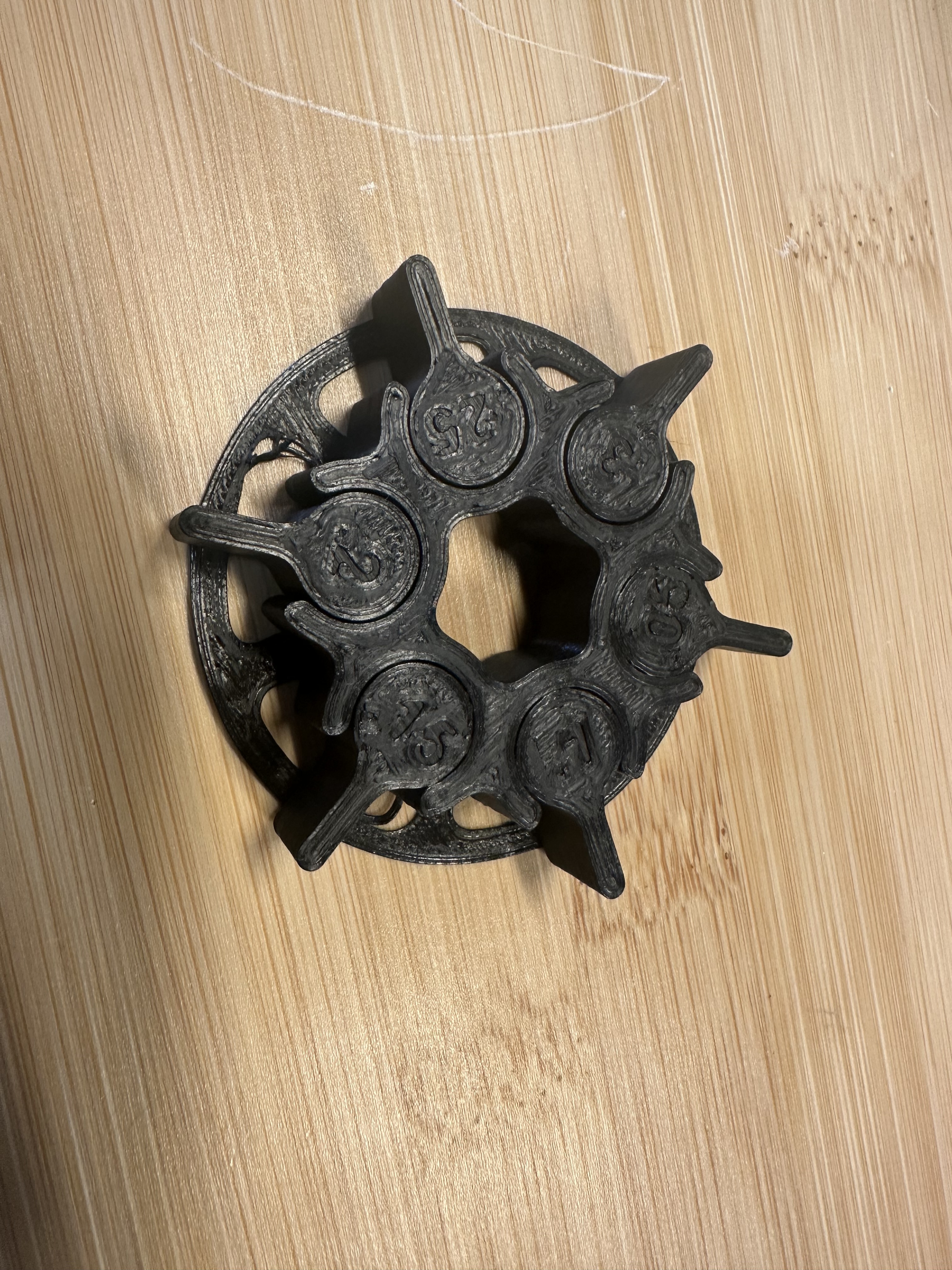

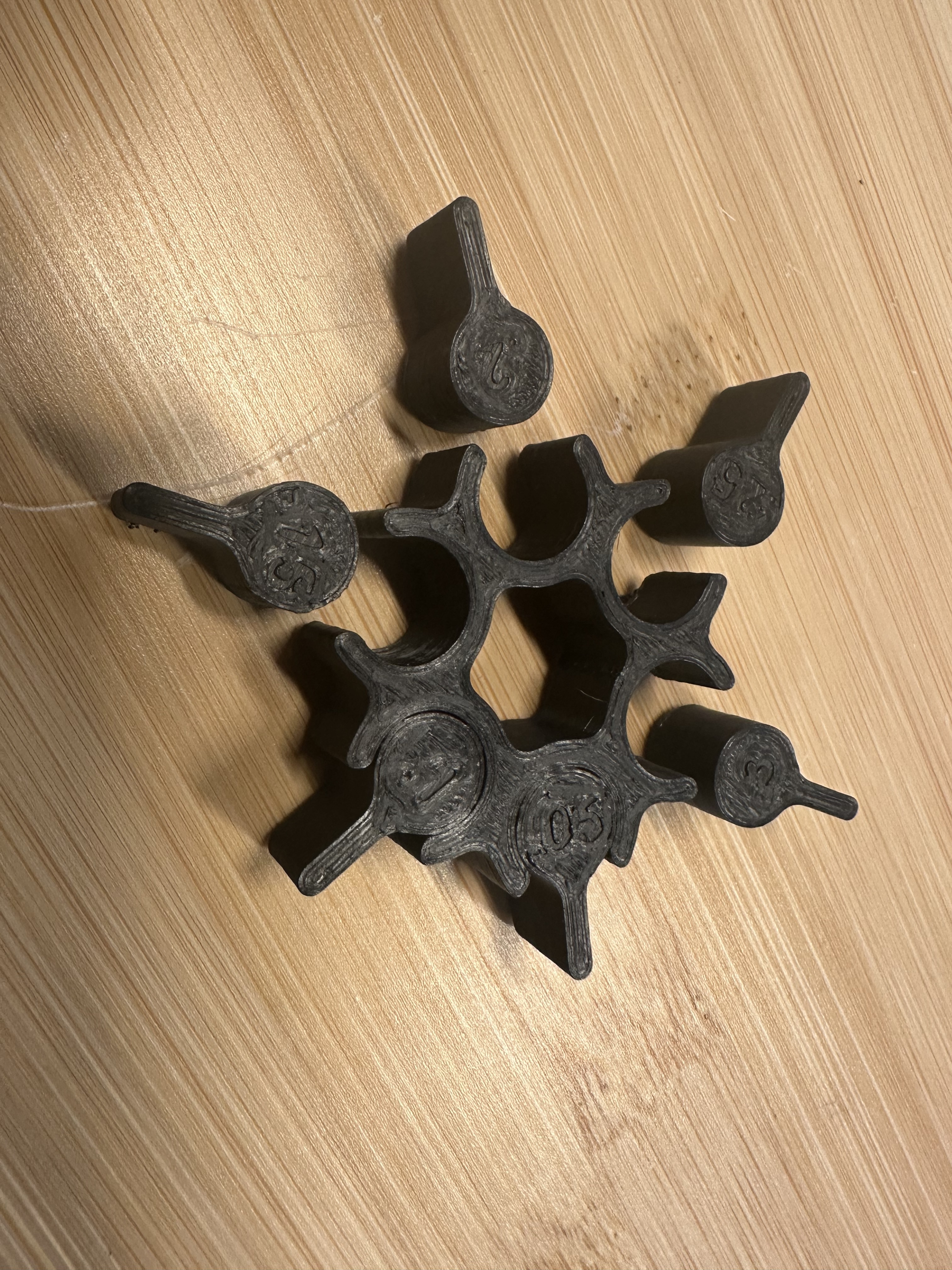

Pretty happy with 0.15mm tolerance test. I was able to pull 0.1 as well but there was no “clearance”

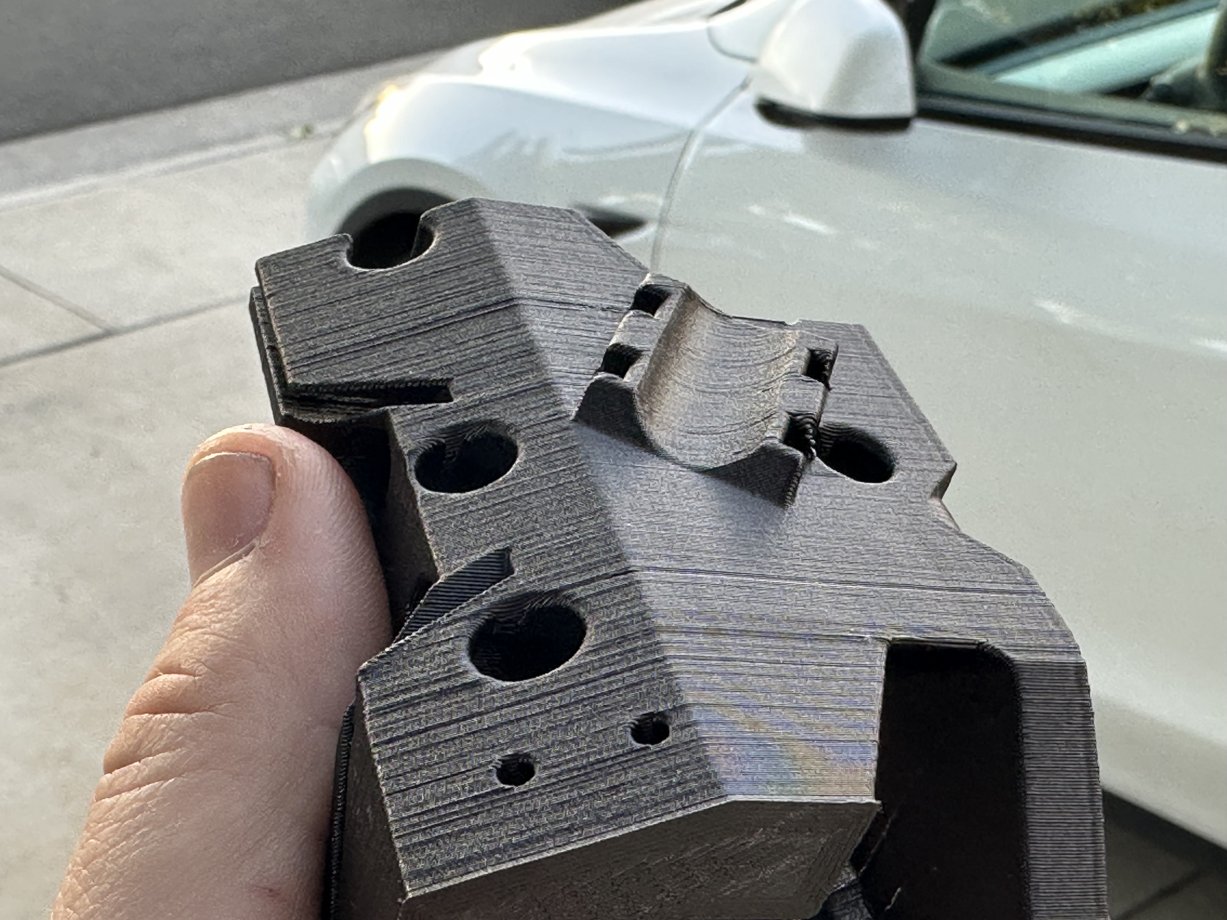

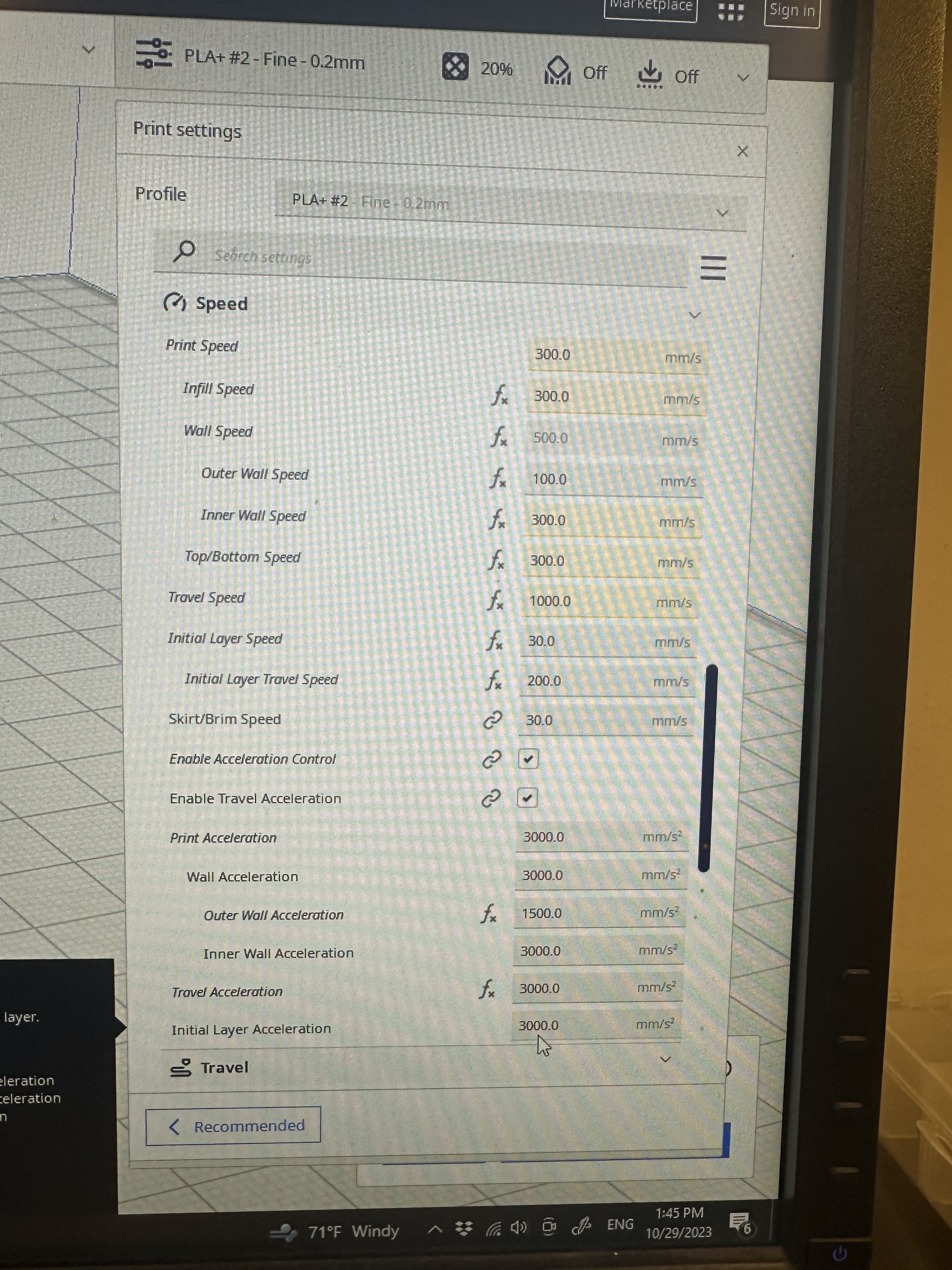

I spent last 2 days tweaking profile for CF-PETG and now starting to re-print all printer parts in carbon. They came out absolutely gorgeous! One thing I might want to tweak is a bang-bang bed heating. I think horizontal rippling in sides that I did not see on PLA is from the bed temp variations
Ooooh weee that looks real nice!
I need to reprint all the core components in PETG now so that I can get back to trying to print ASA again.

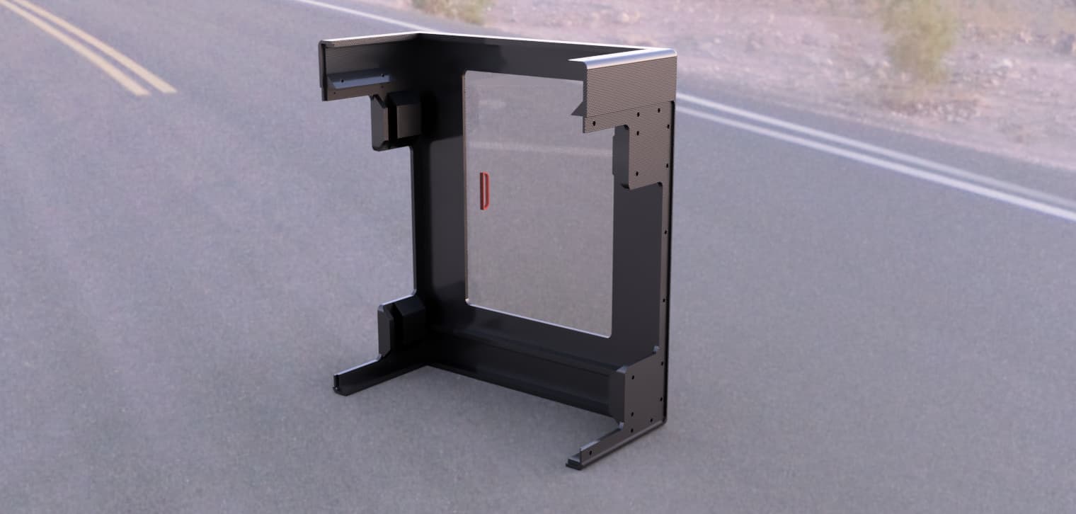

I started working on a design for a modular enclosure. Planning to print with CF-PETG. Obviously, work in progress, need to carefully think about all access panels. It should become a new frame support enforcing correct geometry. Let me know what you think
Modular sounds great, curious to see what you end up with. Have fun!

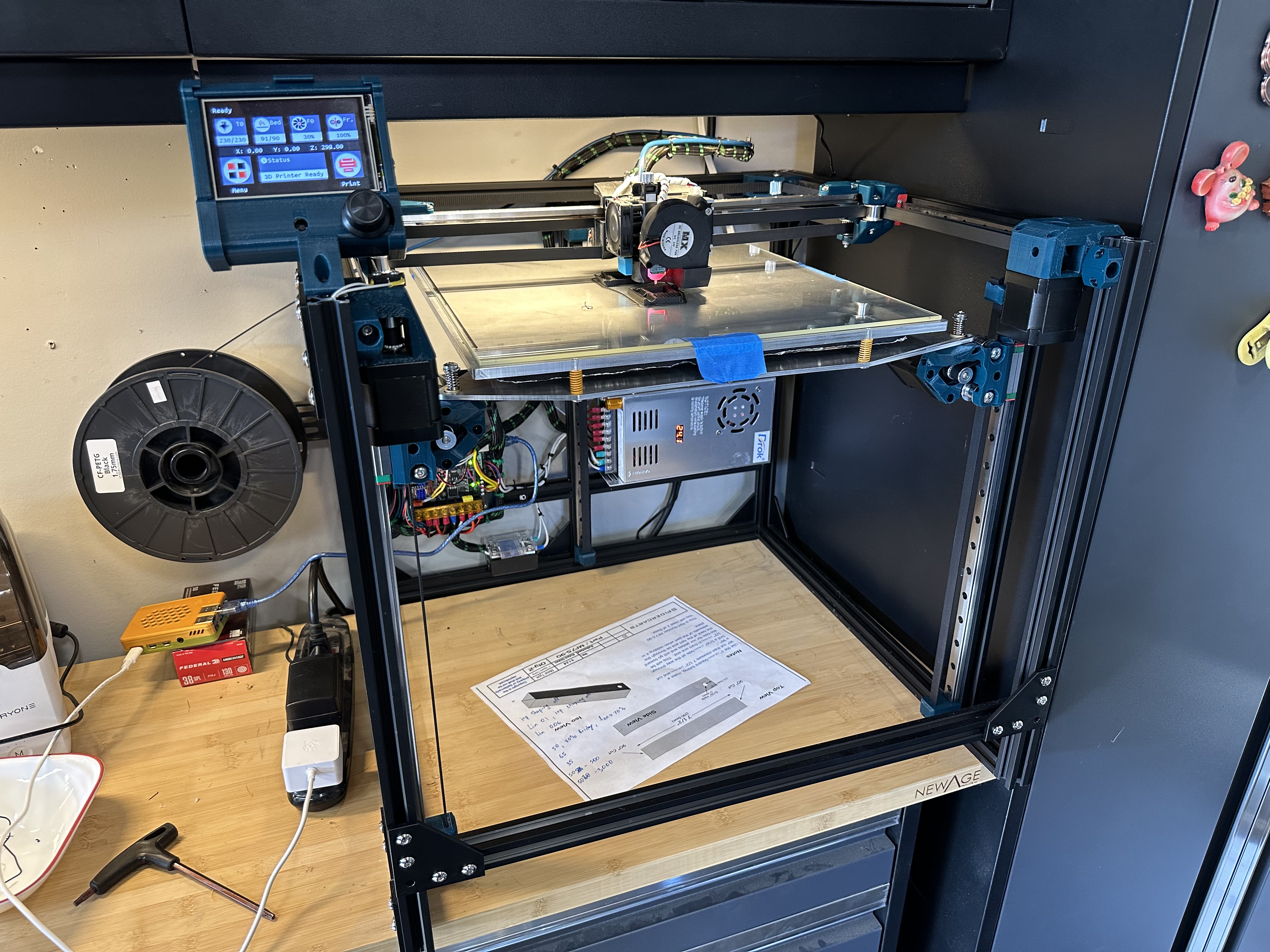

Also looking for suggestions how to secure glass to the thick bed. Painter’s tape surprisingly works well (even hen bed is heated to 90 degrees) but doesn’t look good
Another advise request: I want eventually to have a power off switch for the printer but continue to power raspberry pi. So far I have 2 options: have 2 power supplies powered by a single power cable, that way PRI always on and printer can be switched off by shutting down main power supply. Another option is to make a voltage divider, power both RPI and main board from one power supply but keep that power supply always on by adding a switch between main board and power supply but then I will have to put a switch that will disconnect all power wires from the board
Im using spring clips right now but i REALLY dont like it. Thinking about trying to print some “ribs” that i can screw down to the bed (my aluminum is just a bit wider all the way around than my glass) and it secure the glass from moving. Not sure how well an ASA part would do with the bed at 90ºC for a long time LOL. I think it would be fine at the normal 60ºC for pla though
