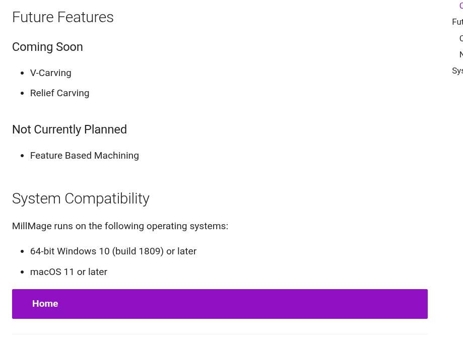

what is the status of millmage? Does it have vcarve? I have not heard anything about Millmage at all lately.
I had HUGE hopes for it as lightburn was soooo ahead of everything else for lasers. (There was something else it was missing for woodworking but I cannot remember what it was.)

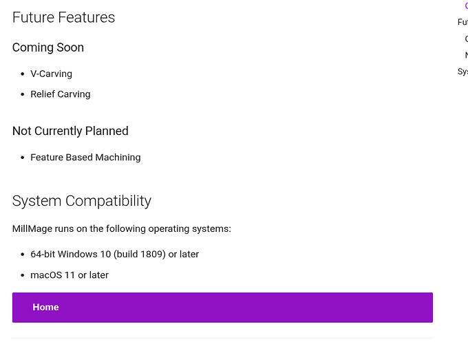

so it is on rc11, but still says (relief was what i was thinking of, but I also noticed someone said it does not have trochoidal either)
They’ve been making a lot of progress. It’s not going to have everything at release and that’s fine. It’s a tremendous amount of work to get a product of this size to a release version. It’s just going to take time.
It looks like they added trochoidal in RC8 but I haven’t tried it.
