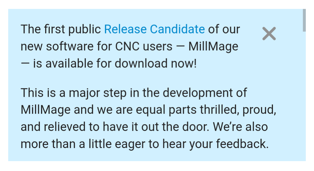

Millmage public release candidate?

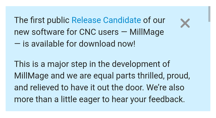

Just saw this on the lightburn site…
Ooh, and it’s publicly available with a 30 day trial.
ha… it’s been so long, I kinda forgot this was even a thing I was waiting on…

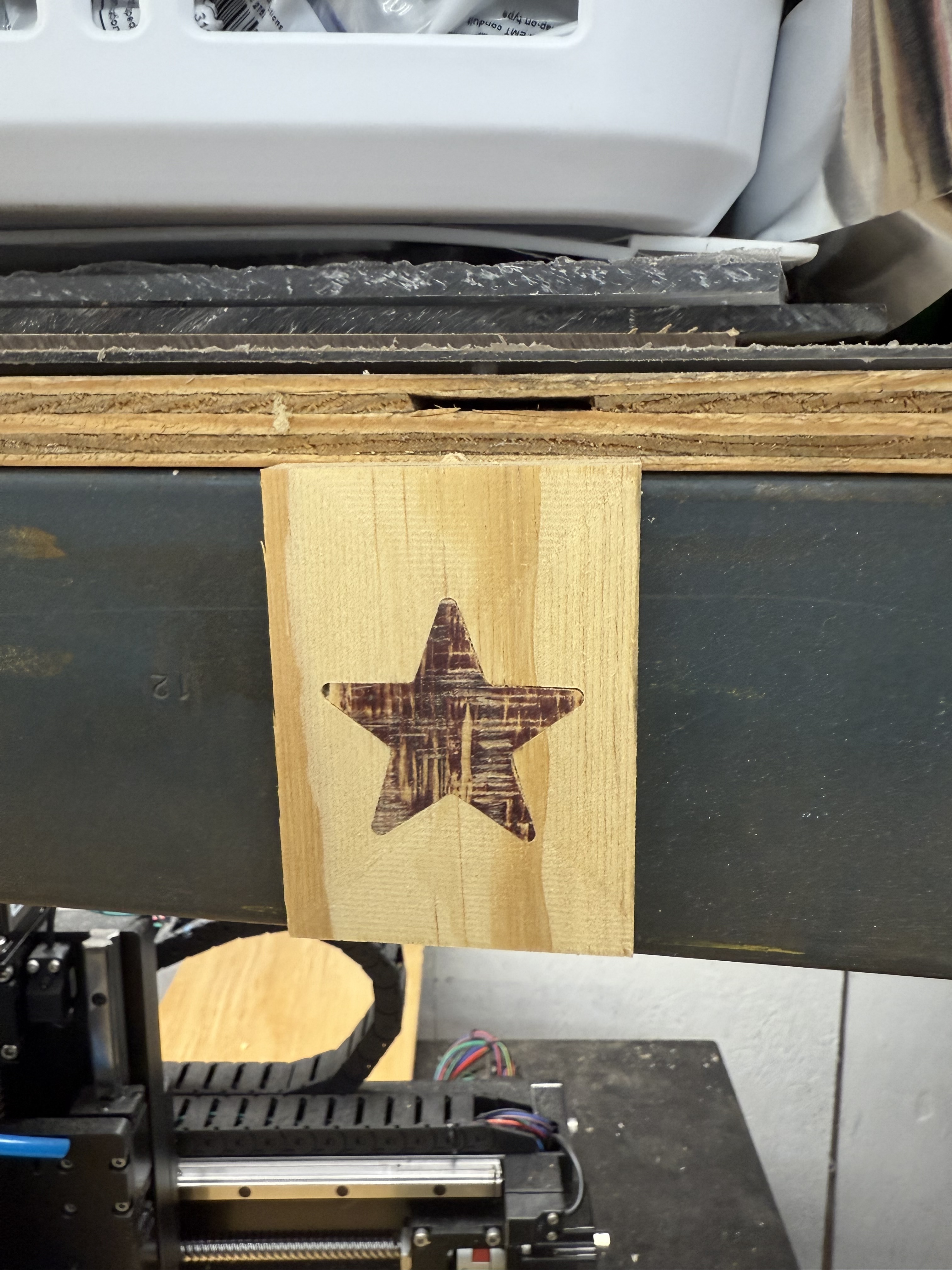

Had a quick play and couldn’t see a way to do pocketing or get the inlay M/F to make tool paths that looked like they matched.
Did you pick the “Pocket” operation? :grimacing:
Inlay is a little interesting but does work quite well. Female pocket will make the shape with corner radii that match the tool radius and gives the option for some shape allowance.
Male is just a profile operation that does the same thing, matching corners to tool radius and doing some slop allowance. I’ve only played with it a little but my first try worked really well with a simple shape.
Sorry, I meant pocket with islands. Inlay is the same - a single solid shape looks okay but ‘nested’ shapes seem a bit odd.
My bad. I was being overly conservative based on what you and I talked about. That’s awesome to hear!

Ah interesting. I’ll take a look at the nested shape inlay. The star I showed is the closest I’ve looked at those tools honestly.
With pocketing with islands the sorting is similar to LightBurn, so make sure all the shapes are selected and it should work well.

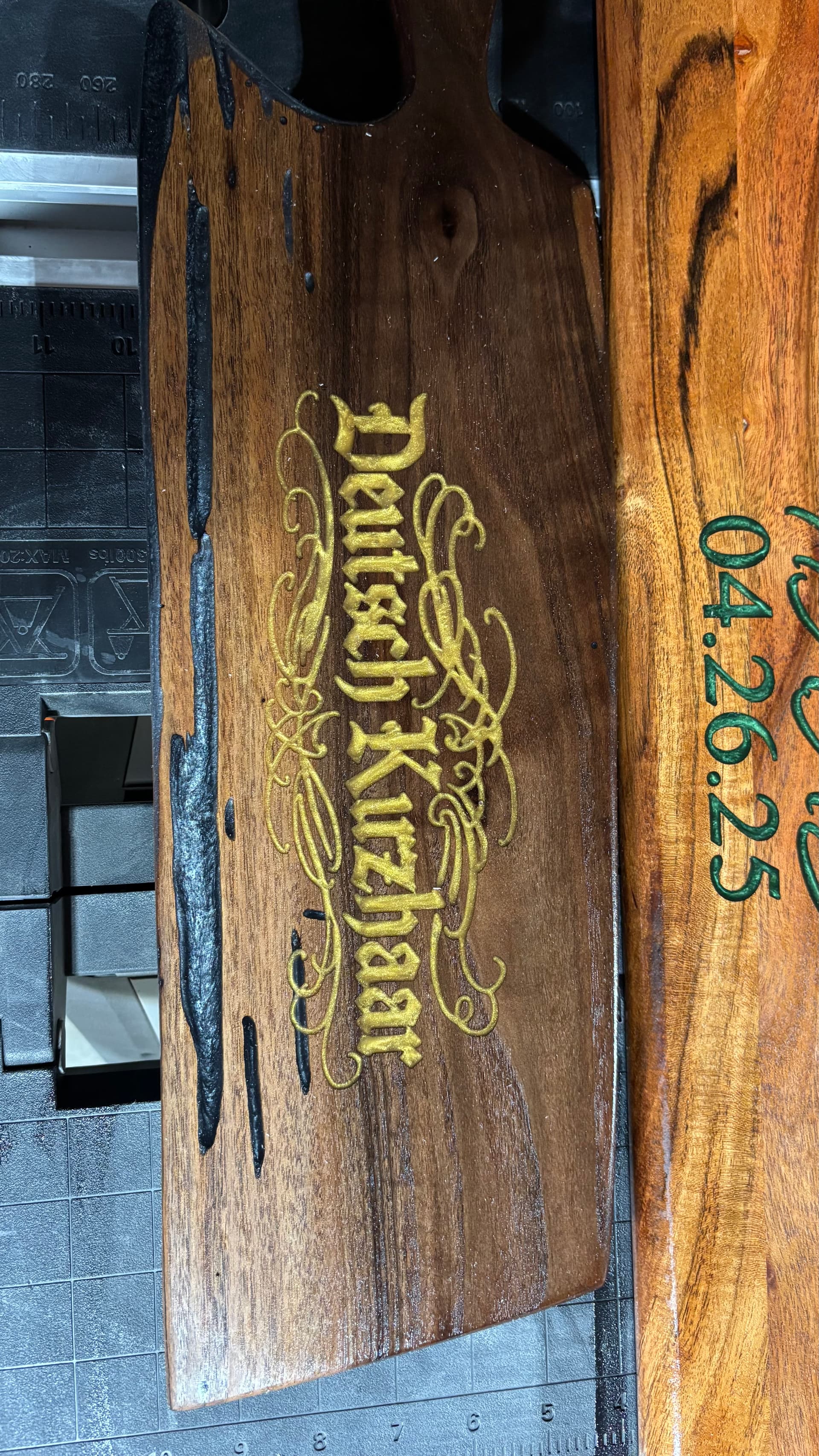

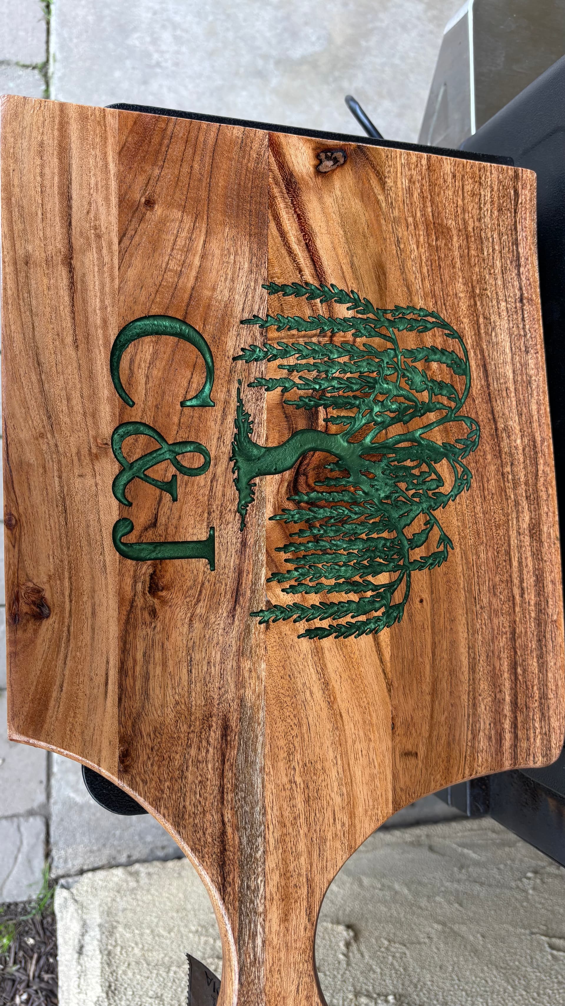

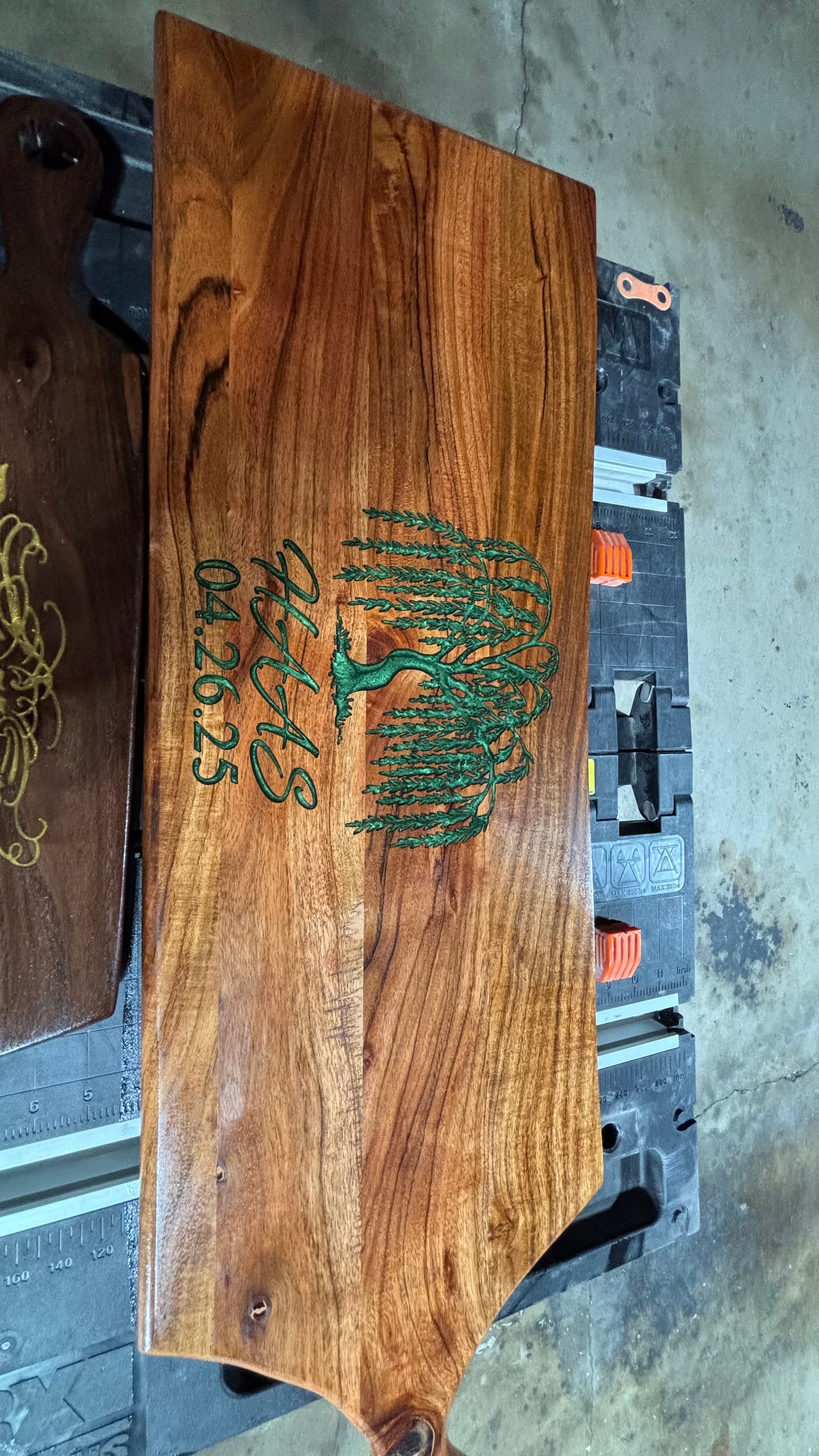

I did these using MillMage.
