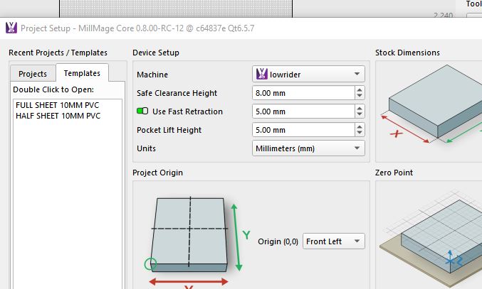

Have you used the new template tab, saves so much time , no more having to set retract , clearance pocket lift height at start of every new job

ill rephrase it, the template tab to save different sized work dimensions and thicknesses so you don’t
have recreate them every time
Yeah I looked at that just a little bit ago. Very nice addition.
