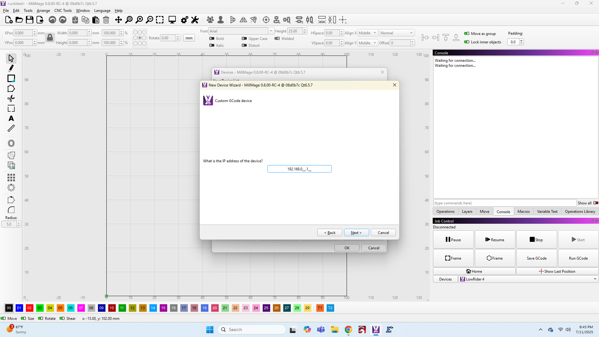

I am one of those individuals. I have been eagerly awaiting the release of MillMage since I am already using LightBurn for my Laser. Since it doesn’t require learning yet another new piece of software (so similar to LightBurn). I am not the brightest, but have been able to figure out the software side of things up till now… I know it is supposed to be as simple as plugging in your Jackpot’s IP Address, but no matter what I have tried, I cannot figure out why it will not connect. All I am getting is “Waiting for connection…”. If anyone has any ideas, please shoot!
Is your computer on the same WIFI connection as your Jackpot? Or are you using the Jackpot in AP Mode?
I have tried it with computer on Jackpots wifi connection, but to no avail. Not familiar with “AP Mode” sorry.
AP Mode is using the WIFI that the jackpot puts out. STA Mode is having the Jackpot hooked to your home WIFI. I have only tried millmage over the STA Mode. I cant speak to how it will work over AP Mode.
STA sounds like the mode I am looking for. I was literally just able to connect via AP mode after re-reading some old posts and trying again after changing to my laptop and getting a lot closer to the machine. This is already a huge improvement after all the weeks frustration!!! I guess I will look into the process of hooking the Jackpot to my home WIFI and STA mode so I can use my desktop which is in the same room, but not as close. Edit: Found it here: (Jackpot STA mode is easier to recommend now)
Thanks for your help @Jonathjon !!!
your IP is wrong , i had same thing happen , you need to keep re typing it till the ( _ _ ) go away once i got rid of then it connect straight away i didnt change any settings in fluid nc
i think i deleted the 68 than typed .0.1
192.1.0.1
than went back and put the 68 back in
was only way mine would connect
Thanks @Terry_O_Sullivan ! I ended up connecting to the jackpot via cable, updating and assigning my wifi to it. Now I am connected via STA through home wifi connection. Running GREAT!
