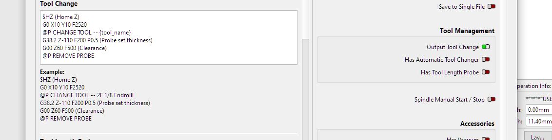

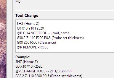

I do remember there being some issues (at least with how we use it) with tool changes early on. I have it turned off now because if you have it on, it does that right at the start of the job every time, even for single tool job. I wish there was a way to tell it to skip the first tool change or assume the correct tool is already there at the start. And that may be done already, I just haven’t tried it. For anything that needed a tool change I just go back to estlcam.
The @ Commands are intercepted by MillMage. They never actually get to the board. Depending on the custom g-code flavor you are running there may have been a bug in RC2 that got you that we fixed in RC3.

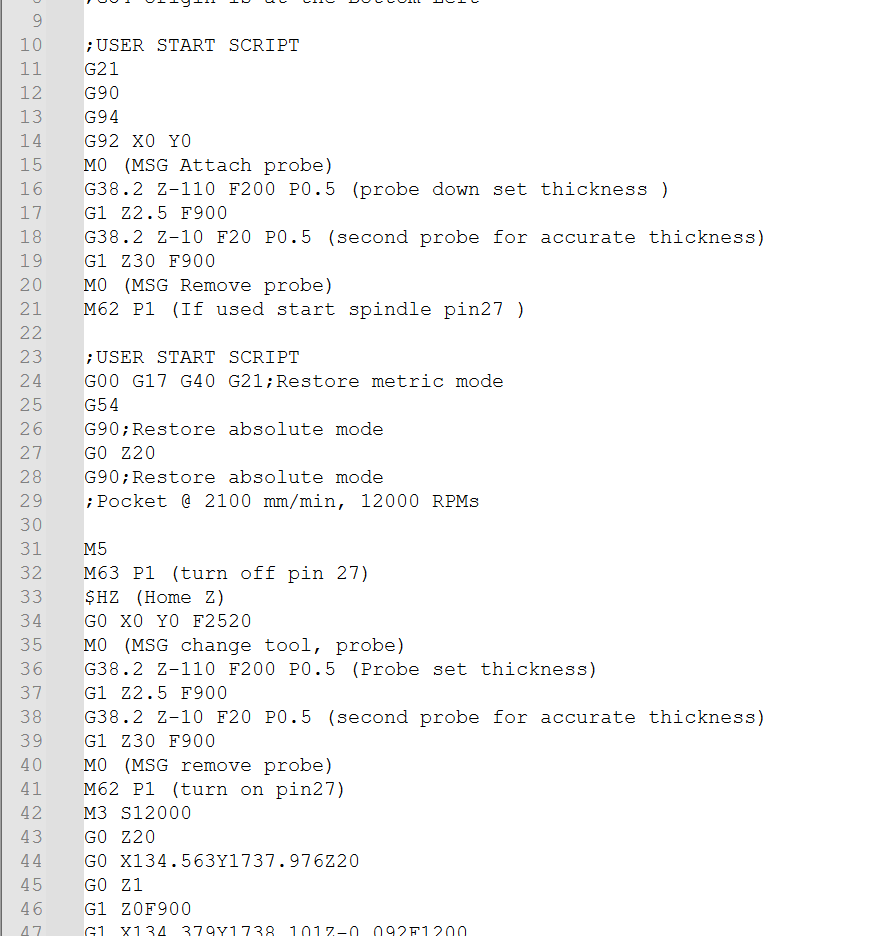

I tested this again this evening and its still doing the same thing. I made a post on the Lightburn forum hoping I am just missing a setting or its something they can add a setting for in the future.
I agree that it would be nice to have the option. I haven’t tried it yet, but I was thinking of trying some fancy gcode with a variable to work around it. So, the starting gcode declares a variable like:
#<IsInitialTool>=1
Then the tool change gcode would be something like:
o100 if [#<IsInitialTool> EQ 1]
  M0 (MSG Attach probe)
  G38.2 Z-110 F200 P0.5 (probe down set thickness )
  G1 Z10 F900
  M0 (MSG Remove probe)
  M62 P1 (If used start spindle pin27 )
  #<IsInitialTool> = 0
o100 else
  M63 P1 (turn off pin 27)
  $HZ (Home Z)
  G0 X0 Y10 F2520
  M0 (MSG change tool, probe)
  G38.2 Z-110 F200 P0.5 (Probe set thickness)
  G00 Z10.0000 F500 (Clearance)
o100 endif
So, the first time, it sees the variable is 1 (it is the first tool), so it runs the starting gcode and changes the variable to 0 (not the first tool). For the next tool, it will do the tool change gcode instead.
I didn’t test this at all. I’m not sure if it will work. Something else I was messing with was making me question if M0 works properly inside if statements but there were other things in play there too.
That is all way above my paygrade. So if you get a chance to test it and find it works, please let me know. Its super annoying to have to edit the gcode every time for that.
Now that I think about it. I guess I could just take the probe stuff out of my start gcode and let the tool change provide that every time. Still not how I think it should be. But is a work around.

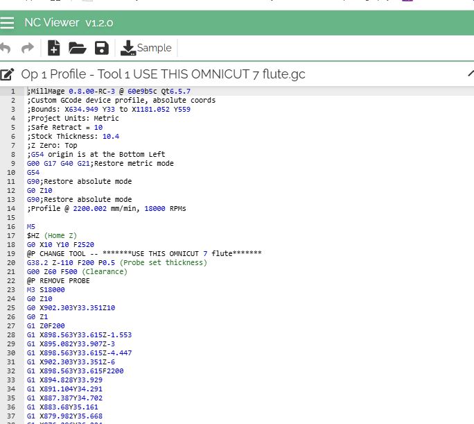

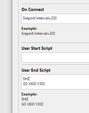

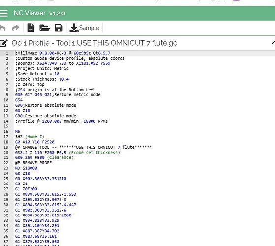

just looking at ur screen shoot
in MM under custom g codes did you write a code in user start script box
i just looked at one of the files ive cut with MM direct , just saved file to compare and its totally different
i had some issues initially due to filling in some of the custom gcode boxes where i thought the text would go
machine was doing weird things
theses are the only boxes ive put codes in now
You need to change M0 to @P in MM if running direct from MM or it freezes at tool change.

just spotted something else line 31 -40 look like the settings once you set up probe in MM
have you done the probe set up in MM ?
that is where your 2nd probe is coming in …
i did probe set up in MM and ended up with double probing
go to custom g code tab ,delete the probe text
if running job direct from MM, box will pop up on screen that u havent probed
just click ignore and than job should run sweet

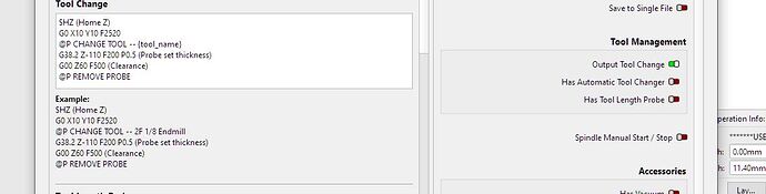

re tool change codes i wonder if :
HZ (Home Z)
G0 X10 Y10 F2520
@P CHANGE TOOL – USE THIS OMNICUT 7 flute
G00 Z60 F500 (Clearance)
@P REMOVE PROBE
needs to be split apart some text in tool change box
@P REMOVE PROBE
and some in the tool length probe box
HZ (Home Z)
G0 X10 Y10 F2520
and see how it spits it out when saved as gcode

Right now I have the custom Gcode set up the same way we do in Estlcam. That is one of the reasons I made the post on the lightburn form. Its possible I have things in the wrong spot. I don’t have anything in the probe section. Only the user start, user end and tool change

I assumed at start that commands would go in user start box also , but that caused me issues ,so deleted them,
did my gcode screenshot look more like what your expecting yours to look like

i spent about 2 hrs , swapping code’s around in the custom gcode boxes and doing air runs until i got it to run in the sequence that looked the same visually at the cnc (not the g code file) as when i was using the webui for fluid nc
less seems to be more in the custom code boxes .its like some of the customs are not overriding the defaults in MM and double ups occur or even conflicts and freezing commands
as in line 11 and 13 of my screenshot G90 runs twice, for the life of me cant find where why or how its there twice, takes like 4 sec to run it twice ,so i just deal with it

Mine runs perfect if I have export tool change turned off. With it on, I always get that top tool change gcode inserted. I am about to go run this code now with the top code deleted and a tool change later in the code so we will see how it works.
I am thinking about giving the way you are running it a try, but need to move some things around so I am closer to it before I pull the trigger.
try deleting the user start code and leave tool change in
how far away is cnc from computer , i was dropping connection or not even getting connection with brand new fluid nc with computer 1 foot way from board, i went and bought a tp link archer tx20u plus external Wi-Fi adapter havent had an issue since with connection , my laptops 6 m away my my lowrider now
I cant do that right now. Well not without being a pain. The start gcode is what sets the zero for X and Y. Its easier for me to just delete the extra tool change gcode for right now lol
