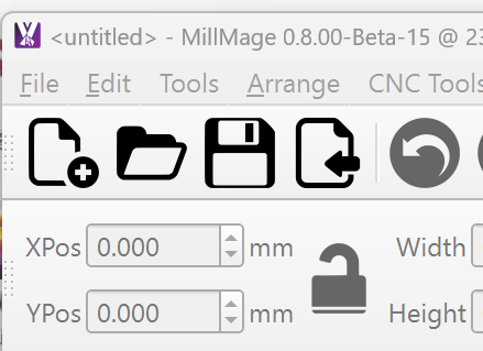

I installed it but was too stupid to load a dxf as of now. :yum: Will try again with more than two minutes…
4th from the left next to save is import. That’s how I do it. If you go to open you have to change the file type at the bottom, its only looking for lightburn or Milmage files when you first open. I don’t remember having to change that on the import button
@Jonathjon
Have you downloaded MM RC2? They have made a lot of changes since Beta-15.
When I opened it this morning it prompted for an update and I did that one. Do I need to go somewhere else to download the MM RC2?
Mine says its 0.8.00-Beta-15
Edit: found RC2 and installing it now

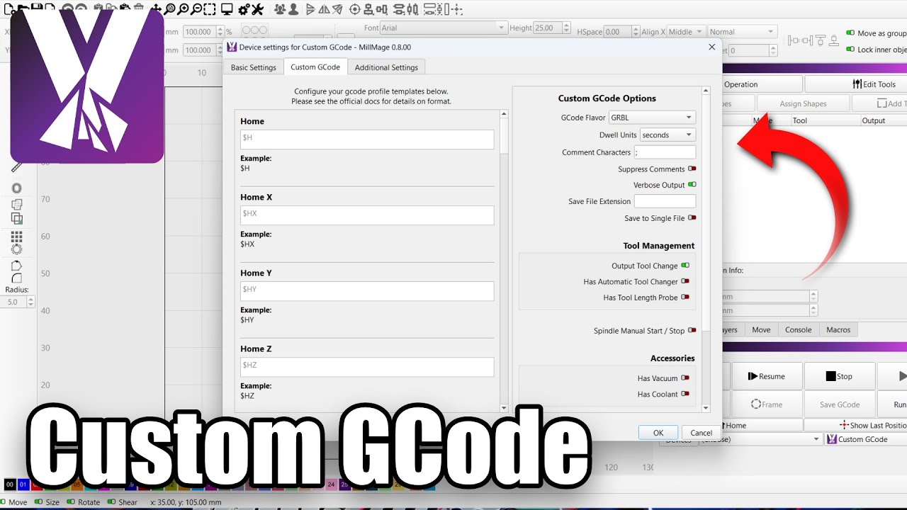

have you had any issues with tool changes freezing ? , they are aware of this issue happening, 2 days ago tool changes working sweet yesterday they started freezing on me
just came across this video in one of their posts
at the 3.10m mark he puts
@P for the pause command not M0
does fluid nc understand @ commands
