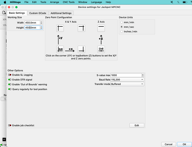

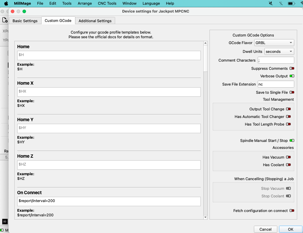

oh that is cool that millmage will frame , ive been waiting for it to be released , ive been using lightburn for bout 2 yrs, so does millmage pretty much have all same features as lightburn , are you running millmage with the jackpot board? if so would you mind screenshotting you machine settings custom gcode tab etc , much appreciated
Yes, MillMage has the same features as Lightburn. I am running it with the Jackpot. I have one device set up for USB and another for wifi. Here are my settings:
awesome , thanks . Q: any reason why you havent enabled jogging
as far as connecting through wifi , was it pretty straightforward , ive never run lightburn with wifi always been connected via usb
It’s very simple, just tell it the ip address of your jackpot.
I have a pendant that I use for jogging.
Like Dreyfus said, you just enter the IP address.

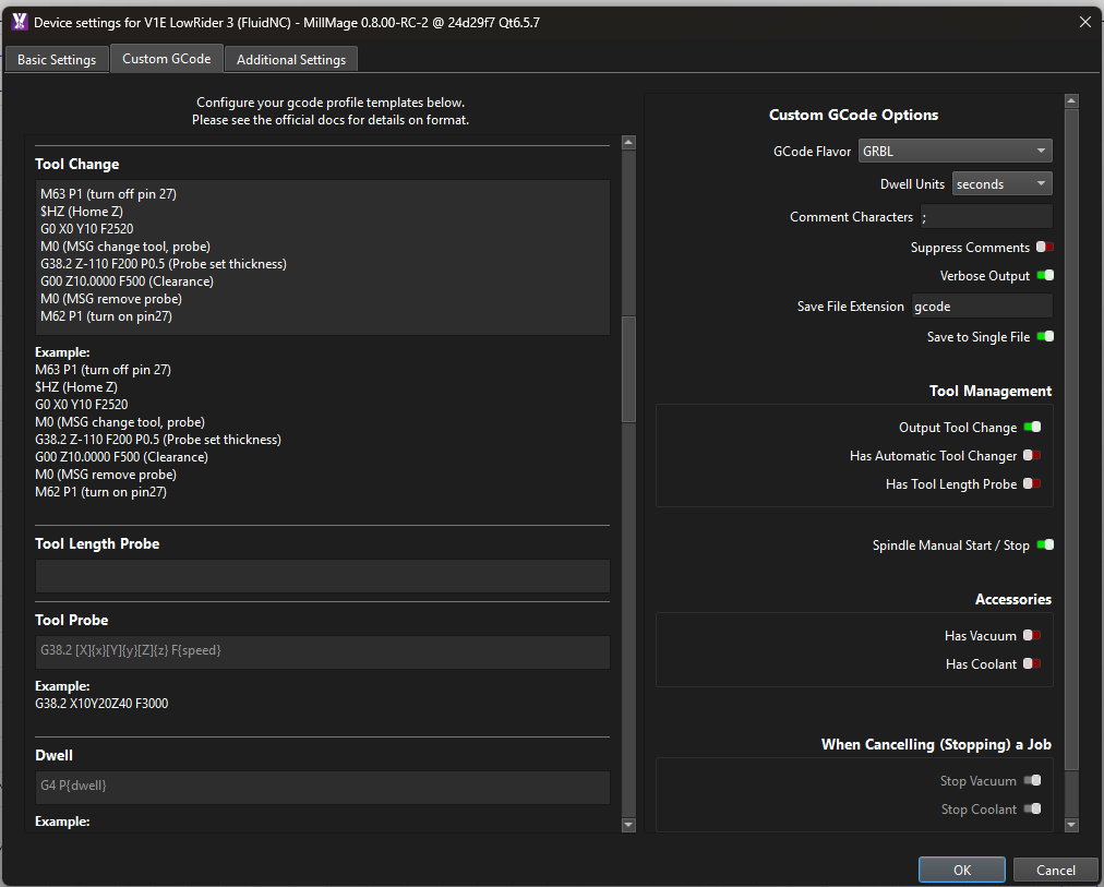

scrolling further down the custom gcode tab at tool change did you change it or just left it as T{tool}
No I didn’t change it. I have not done any tool changes during a running job. I have been outputting one tool at a time.
For FluidNC, I put the tool change gcode from the milling basics page in there. You also need to select the “Output Tool Change” option.
Should probably be updated to use some variables to add details about the which tool is being used.
I also added the ending gcode:
I haven’t sorted out the starting gcode but it will need to be different than what’s defined on milling basics. We assume that the first tool is already loaded where Millmage does not. Although, perhaps not assuming that is a reasonable workflow change.
It includes the tool change gcode at the start so that doesn’t need to be duplicated. However, I don’t want it to home Z at the start, and I want it to zero based on the current XY position.
