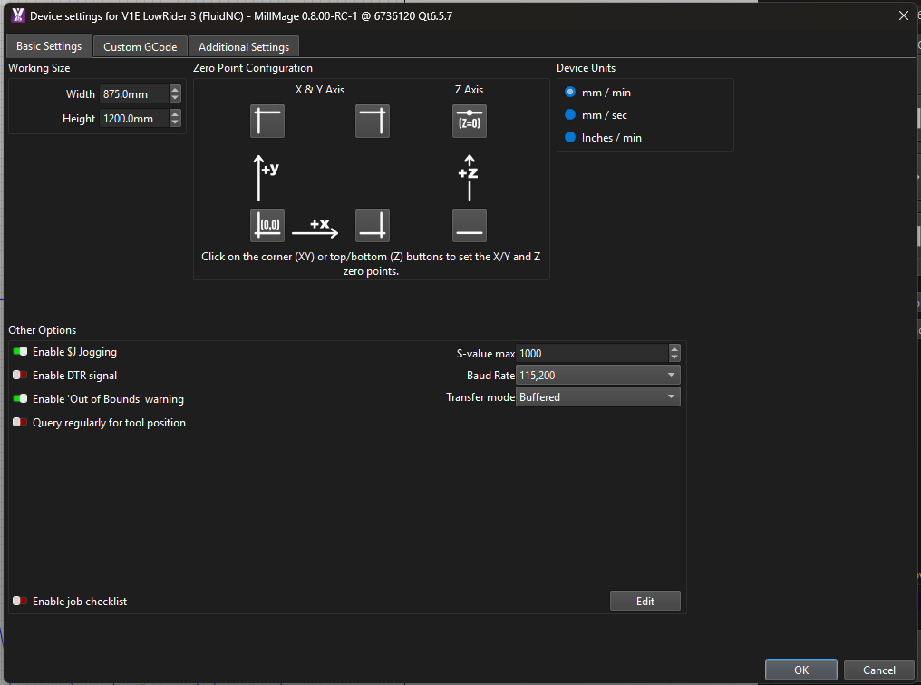

I was checking this out a bit today and my initial impressions are quite positive. Note that I’ve never used LightBurn and I haven’t used this to cut anything yet.
I’m looking at this from a FluidNC perspective. While I might try it connected, I haven’t done that yet. I’m more interested in just generating gcode. I also use a single gcode file including manual tool changes.

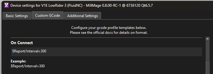

It took me a bit to get it to output gcode the way I wanted. Once I found the “Custom GCode” tab, I was able to setup the Tool Change and Job End gcode based on the gcode from milling basics.
Also to get what I wanted, I had to select:
  • Save to Single File
  • Output Tool Change
  • Spindle Manual Start/Stop
If running connected, I think I’d be inclined to try:
  • Enable $J Jogging
  • [Disable] Query regularly for tool position
For tool position, I think maybe instead, could set Custom GCode for “On Connect” to setup auto-reporting.

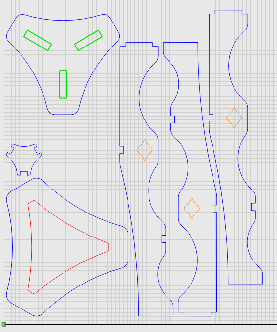

I really like how operations are setup. I was using the stool I made as an example. Each unique operation I setup as a specific layer and then used the “Auto Use Layer” option to use the same settings for all those objects.
I was also able to use the “Nest Selected” option. It was a little odd but worked well once I figured it out. I needed to add a rectangle off to the side to define the bounds. Then I could select everything and choose “Nest Selected”. It generates an SVG and copies the file path to the clipboard. Then opens a browser to svgnest.com where you upload it, select the rectangle as the bounds and let it go. Then when done, you take that SVG and import it. Note that the original SVG it generated ignores inside shapes, but when it import the result, it somehow has those inside shapes in the correct location.

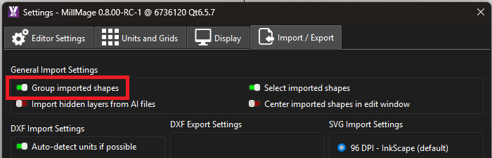

I was originally thrown off when importing a DXF because the shapes weren’t grouped, so I’d drag it and only that specific part would move. I changed a setting so it would automatically group them together on import.
That does make it a little odd if manually adding operations later (or changing layers) because you need to ungroup them.
