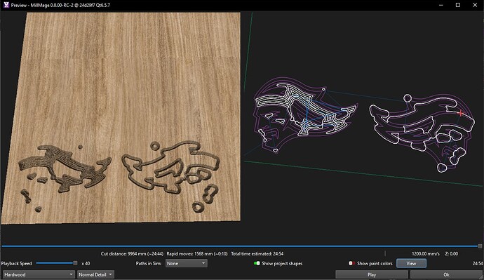

When I use the same dxf, choose a female and a male inlay with a v bit - this is the result.
:frowning:
I’ve no idea how else I’m meant to be using it. The Tools and Features documentation isn’t clear but I understand this is a work in progress.
